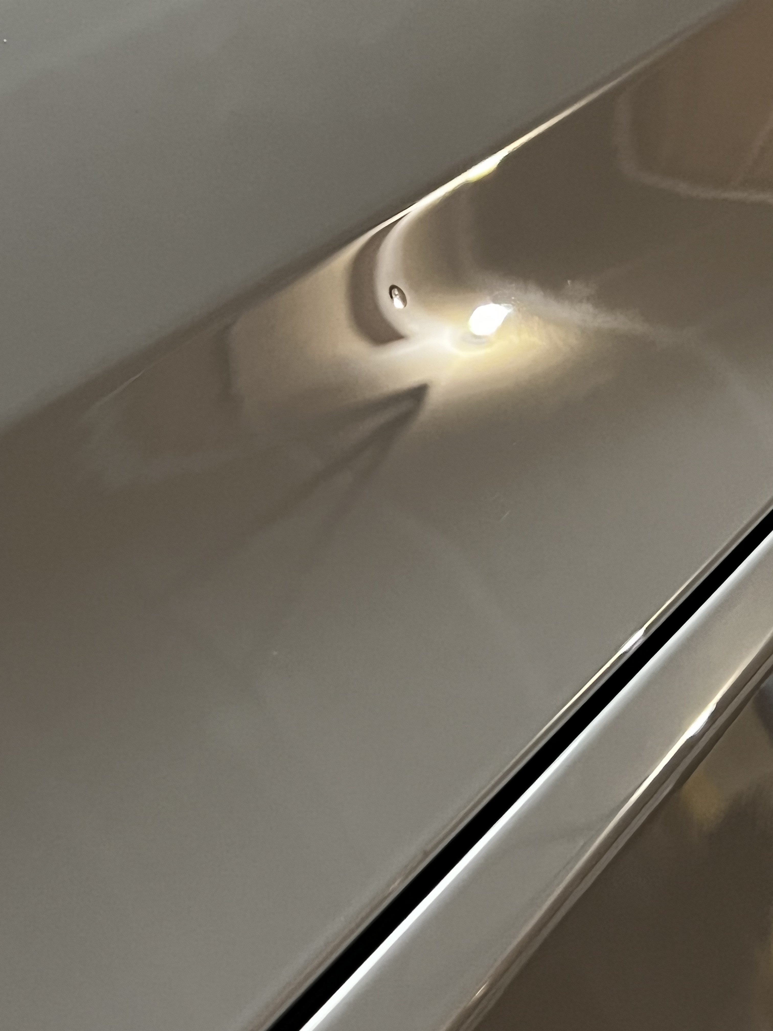

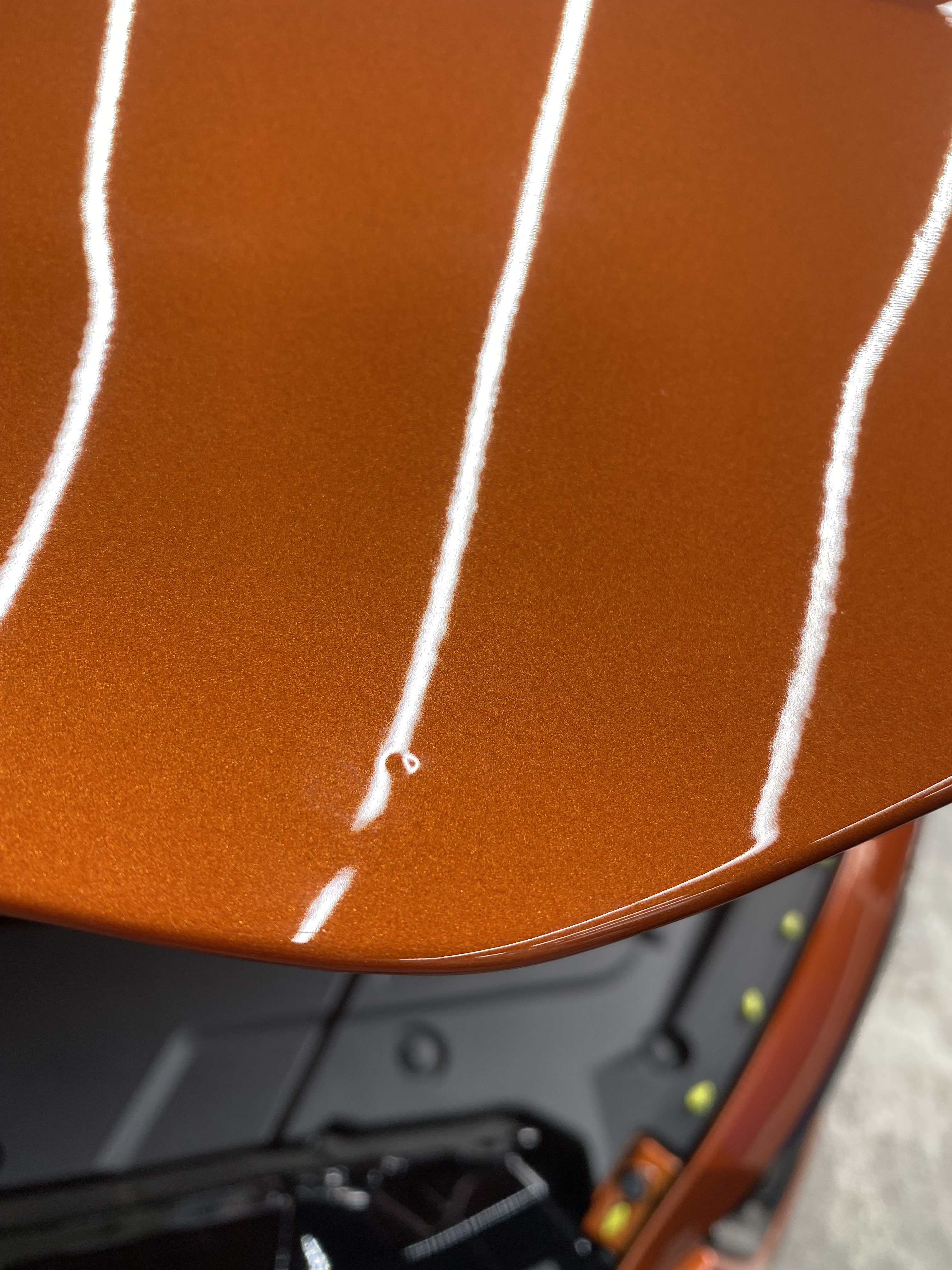

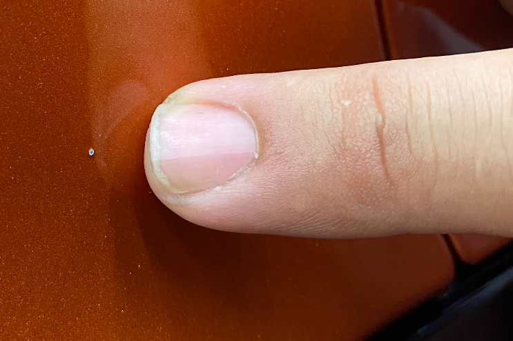

Can't say I wasn't warned. Had an unbuffed spot on the roof on delivery (dealer didn't detail per my request) that came out, but also un-level paint (like a divet) on hood edge and 4 little black or white dots in the paint beneath the clear. Nothing that I will bother fixing and the detailer mentioned this has been a trend he has seen in recent new cars across multiple makes including german. Maybe it is staffing issues, poor QC, etc.

I opened up a case with Cadillac Customer Service after dropping my car off at the body shop.
Repairing the hood edge paint issue they want to blend into the fender. So I am going to have to spend about $900 to re-PPF. I shouldn't be out $1 even if PPF is a gray area, it's "aftermarket".
My take is I wouldn't be out $$$ if they had proper QC in the first place.
Body shop manager thinks the hood was repainted once after initial assembly which makes sense.
I just got my car back from a correction and coating yesterday and I have a VERY similar divot thing on my hood. Mine is closer to the drivers side edge much further back. Super odd. I'll try to throw a picture up here later, but I think it looks damn near identical to yours.
Here is my paint divot. Hard to get a decent picture of it.
