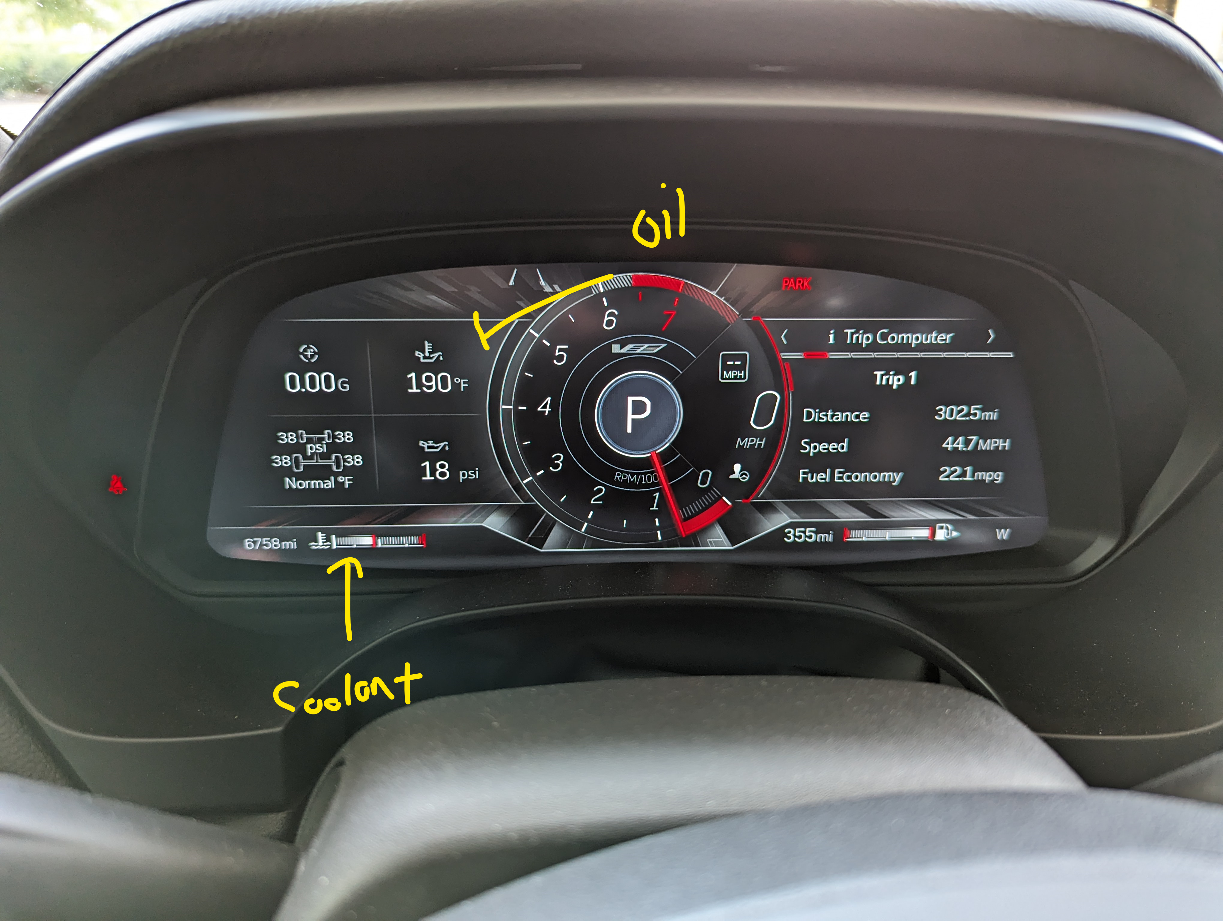

This might be a dumb question, but are you sure you are comparing coolant to coolant temperatures, and not coolant to oil temperatures? I don't know what the default settings are for the dashboard layout, but I have mine configured to show oil temperature in the left-side grid as coolant temperature is always shown. Oil temps will lag coolant temps at initial running.

I appreciate it, but yes, I watch my coolant temp. It's a bad habit I have. I had to watch the oil temp on my 4xe because it would get stuck in oil refresh mode constantly. But yes, I watch the coolant, not the oil.

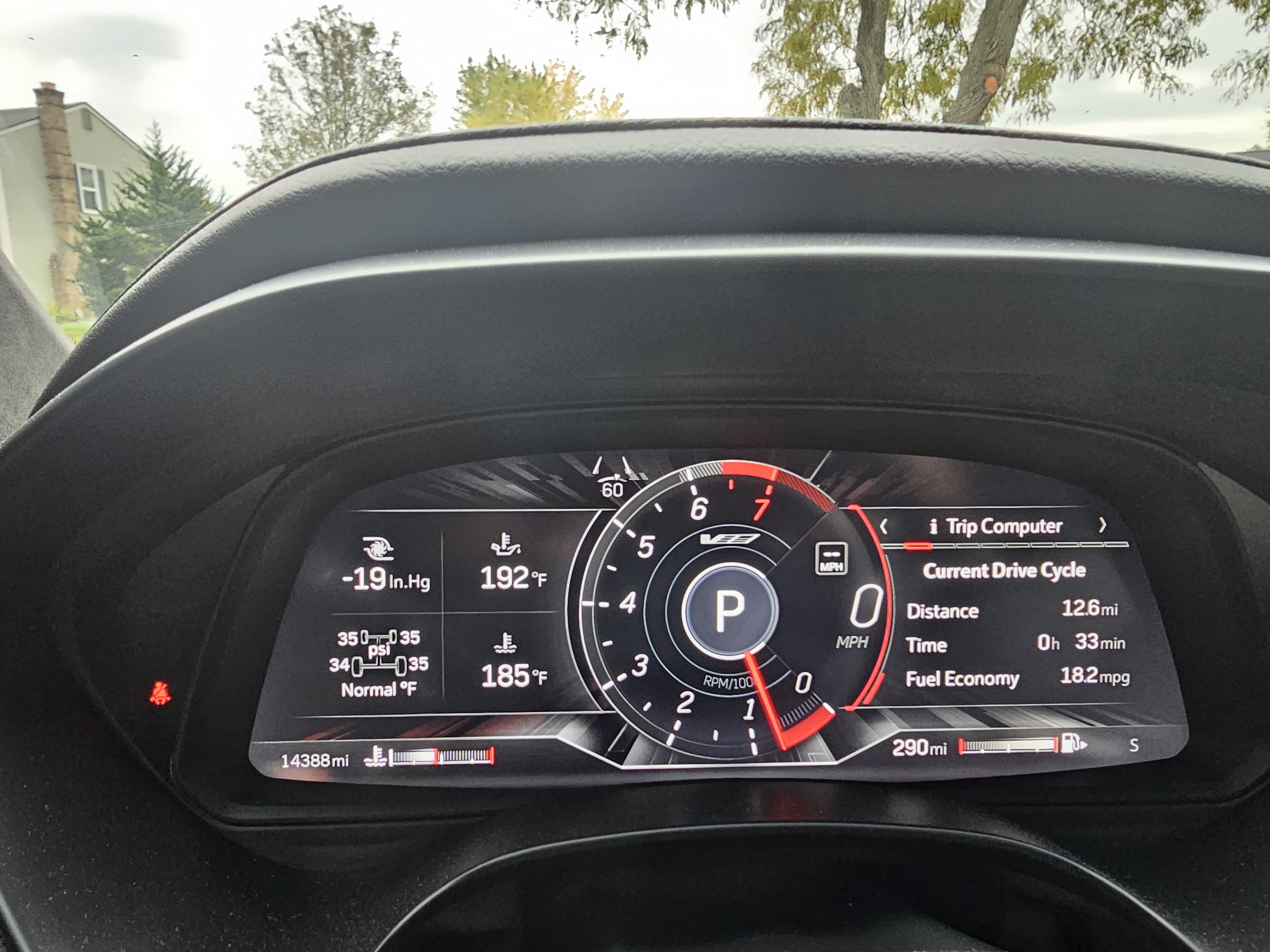

I know from experience that your oil temp is supposed to get above 200F to evaporate any gasoline in your oil...and with a HPFP, it leaks fuel excessively into the oil during cold startup. And mine does not get above 192F.
