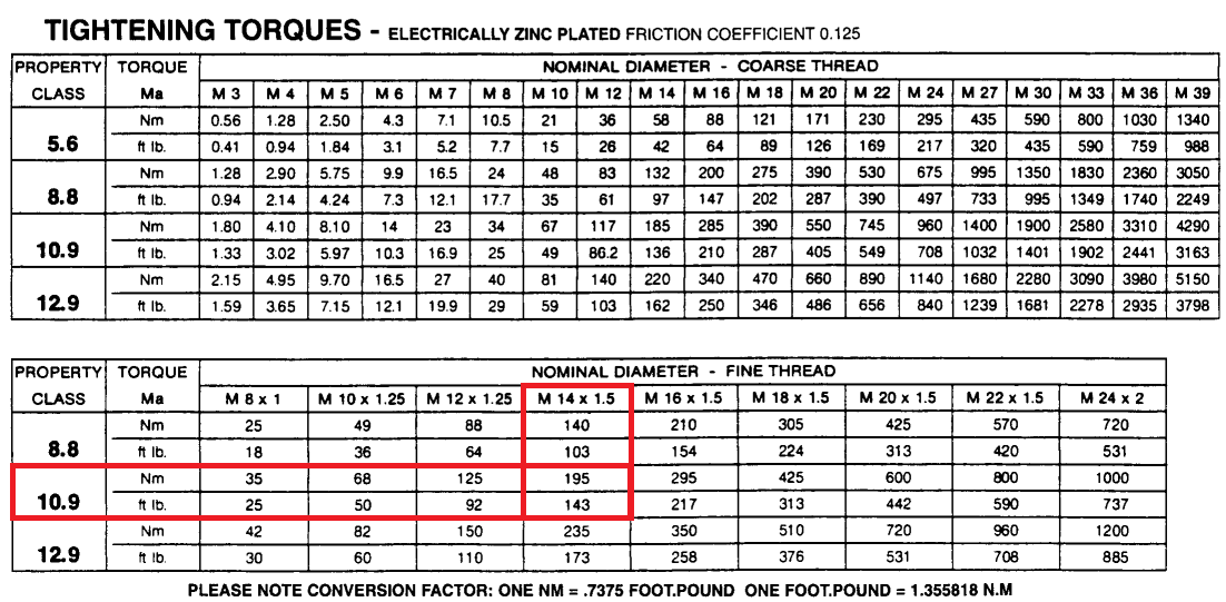

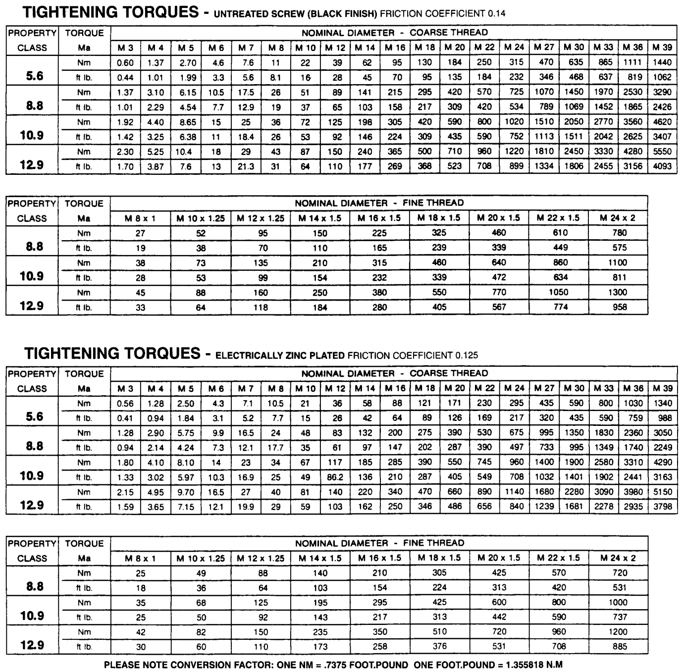

Those Dura-Nut look like awful lug nuts (the supplier calls them 7075-T6 and "duralumin" which is a 2000-series aluminum--both can't be true at the same time). The torque spec is required not optional. You have to reach a certain torque to achieve preload on the stud to prevent loosening--if your chosen lug nut can't handle that torque you shouldn't be using it. High strength fasteners require higher torque to preload because they're harder to stretch. You should never use aluminum lug nuts for a myriad of reasons, most notably their lack of a fatigue limit.

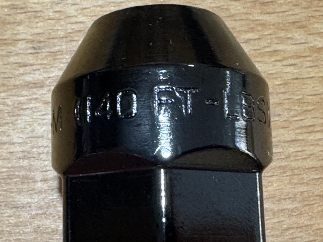

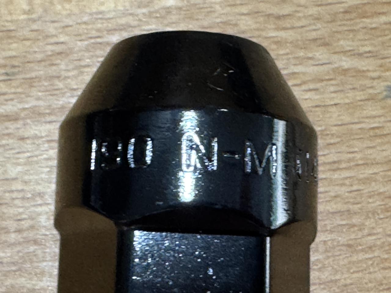

My 2014 CTS-V used the same M14x1.5 lug nuts. The first time I messed with them I thought "holy s*** these are tight!" But they are also a lot bigger than the M12x1.5 lug nuts on my C6 Z06 (which are 100 lb/ft).

And safety is always key so not worth risking that but learned lot about what determines the torque spec. I am now very curious what material grade GM is using for their stud that requires 140 lb-ft to get the desired stretch
