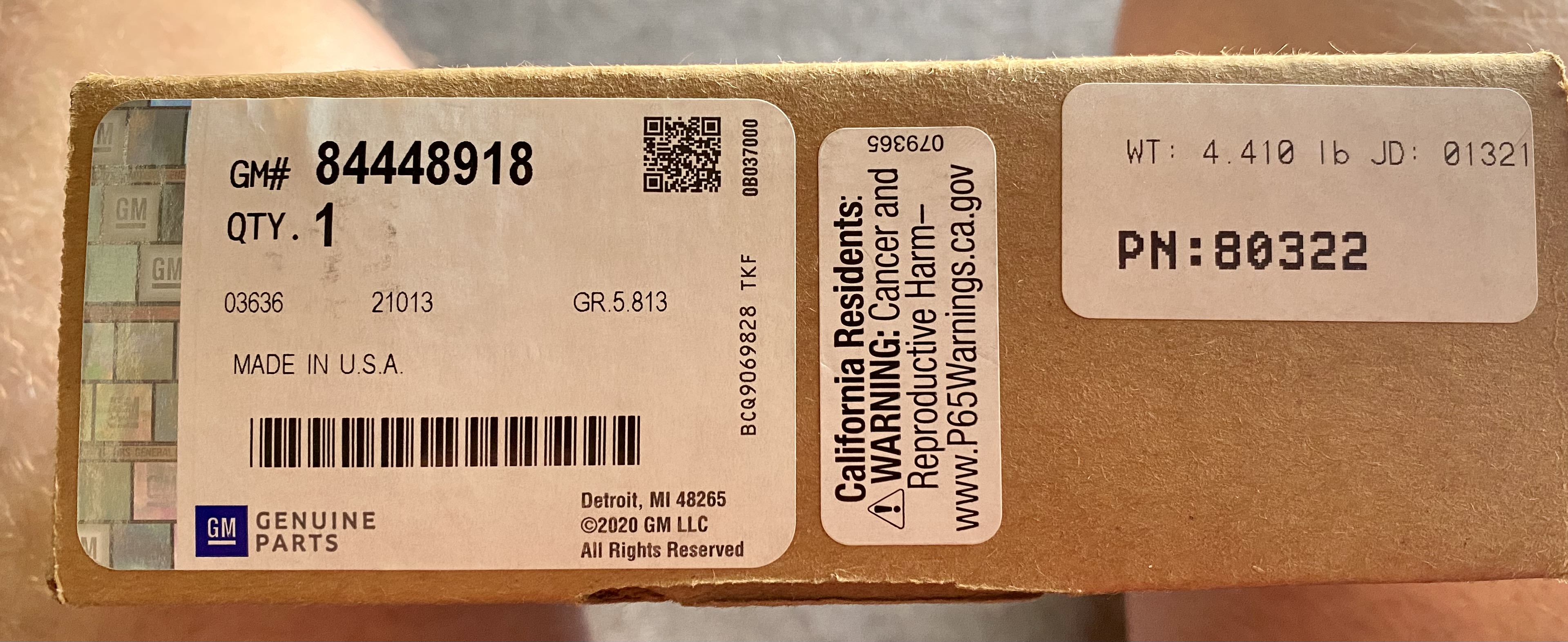

Does anyone have the part number for the black lug nuts for a CT4 BW?
I ordered what I thought was the right part (84639994), but apparently they don't fit lol. Stock is 22mm while these are 19mm and won't thread on. All the GM parts websites list this part number for the 4BW (for example GM Parts Direct: 2021-2022 Cadillac CT4 Wheel Lug Nuts, Black 84639994 | GMPartsDirect.com)

These are what fit my 4BW... They came from the parts department at the dealer. Don't pay any attention to my sexy legs in the pic..

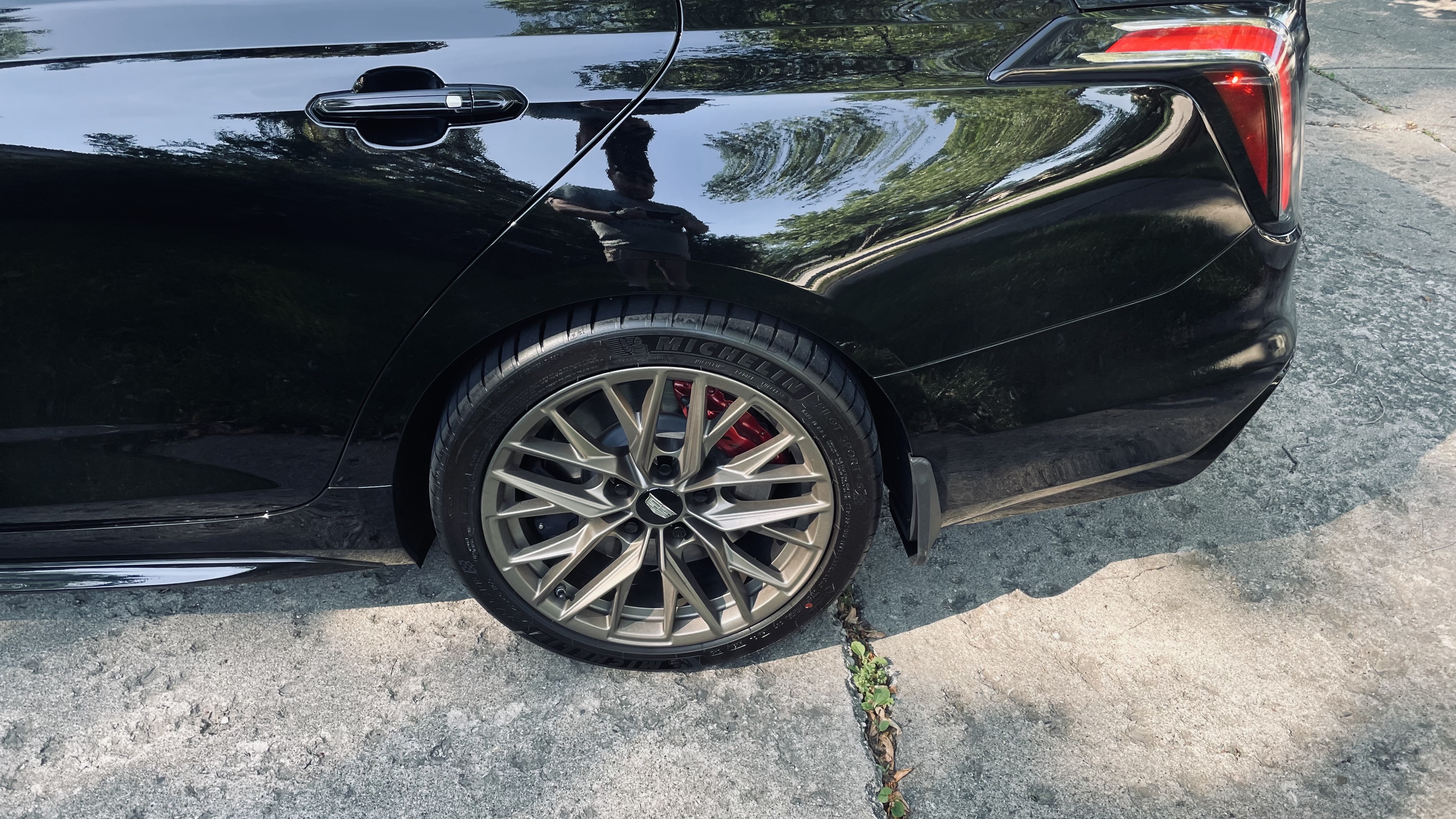

Also McGard makes a black spline, locking lug nut set that fits the 4BW:
It's what I have on my car
