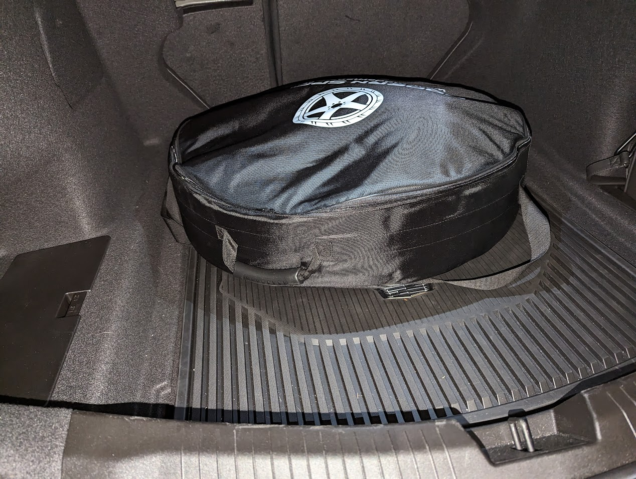

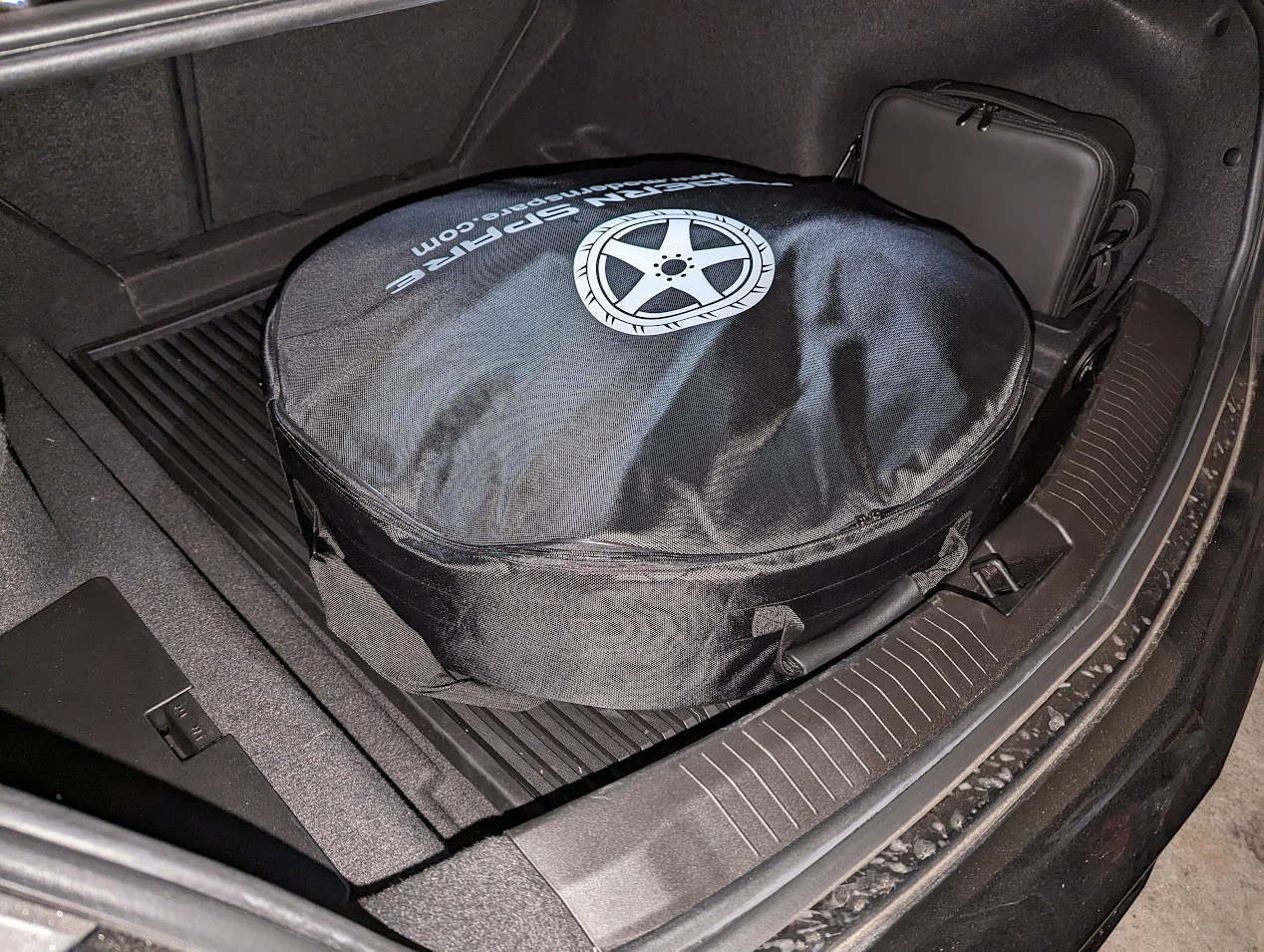

It’s 27” round and only 6” tall. The 5BW trunk is roughly 37 to 38” (not counting the back corners) and 17” high from my trunk mat to the bottom of the speaker. 19” high not counting the tiny speaker magnets. I did a mock up and IMO still have plenty of space for other bags, etc. I’m strongly considering so I don’t have to put the factory cheese whiz crap inside my tire/wheel.

I bought one for my BMW. I need to see if it will fit the Caddy... it has two sets of bolt holes so it's obviously designed for several fitments.
It's almost certainly too big (height) for the little hideaway thing in the trunk, but you could remove the carpet and the styrofoam insert to at least take partial advantage of it.

6” height spare… in a truck with 17 to 19” height🤔, maybe you are still comparing to your old BMW trunk?
It's not an insignificant presence in the trunk, but still worth having it as a solution to keep you mobile.
No, what I meant was that it will not fit in the hole where the air pump is, the area that would have had a real factory spare tire in it years ago. It will not fit with the trunk liner (carpet) on top.
Of course it will fit in the trunk!

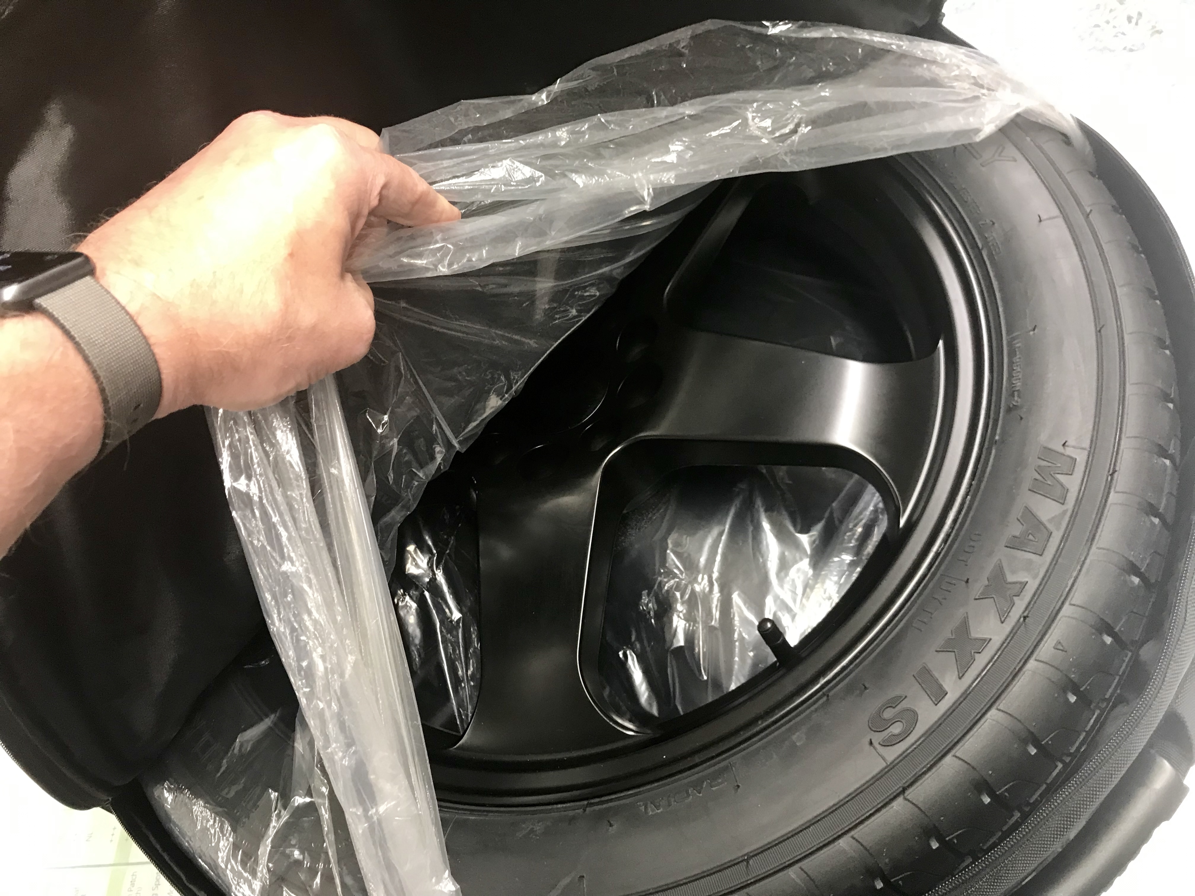

So, as I noted above, I had one of these for my BMW, so I finally got around to testing it, and of course the spacer does not fit the GM product, but the wheel does, so I contacted Matt at Modern Spare. He was nice enough to address my questions, and sent me a correct spacer as well as extra lug nuts since those 22mm monsters on the car will not fit. I offerred to trade in the BMW spacer, but he thought I'd prefer to just pay for the new one. LOL, he ain't runnin' a charity!
I test fit it over the holiday, and it works just fine, clearing the front brakes.
Guys and girls, be sure to remember to let Santa know that you want one. All-in it's a few hundred bucks, but for me, that's cheap insurance.
