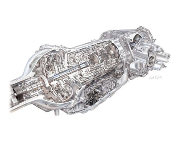

The Hydra-Matic 8-speed transmission (Fig. 12) employs a line pressure and volume control system during upshifts to compensate for new transmission build variation as well as the normal wear of components. Over time, the variation from new and normal wear of the apply components within the transmission can cause shift time (the time required to apply a clutch) to be longer or shorter than desired.
attachment.php
To compensate for these changes, the Transmission Control Module (TCM) adjusts the pressure commands to the various pressure control (PC) solenoids to maintain the originally calibrated shift timing. The automatic adjusting process is referred to as adaptive learning and helps ensure consistent shift feel while increasing transmission durability.
The TCM monitors the A/T input speed sensor (ISS) and A/T output speed sensor (OSS) during commanded shifts to determine whether a shift is occurring too fast (harsh) or too slow (soft). It then adjusts the corresponding PC solenoid signal to maintain the set shift feel.
