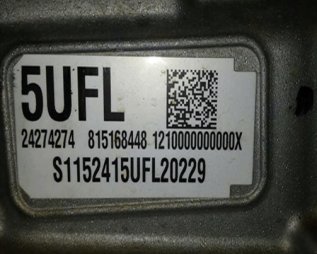

<dl><dt>Service Procedure</dt><dd>
attachment.php
Check the julian date of the transmission by reviewing the TUN number on the side of the transmission. Transmissions built between July 1, 2015 (julian date 182) and Sept 14, 2015 (julian date 257) may have a suspect Clutch Control Solenoid.
TUN decoder See example below:
  • Third and Forth digit – Calendar Year – “15”
  • Fifth, Sixth and Seventh digits – day transmission was produced – “241”
  • This transmission was produced on August 29, 2015
If the transmission julian date is between 182 and 257 the valve body should be replaced.
</dd></dl>
