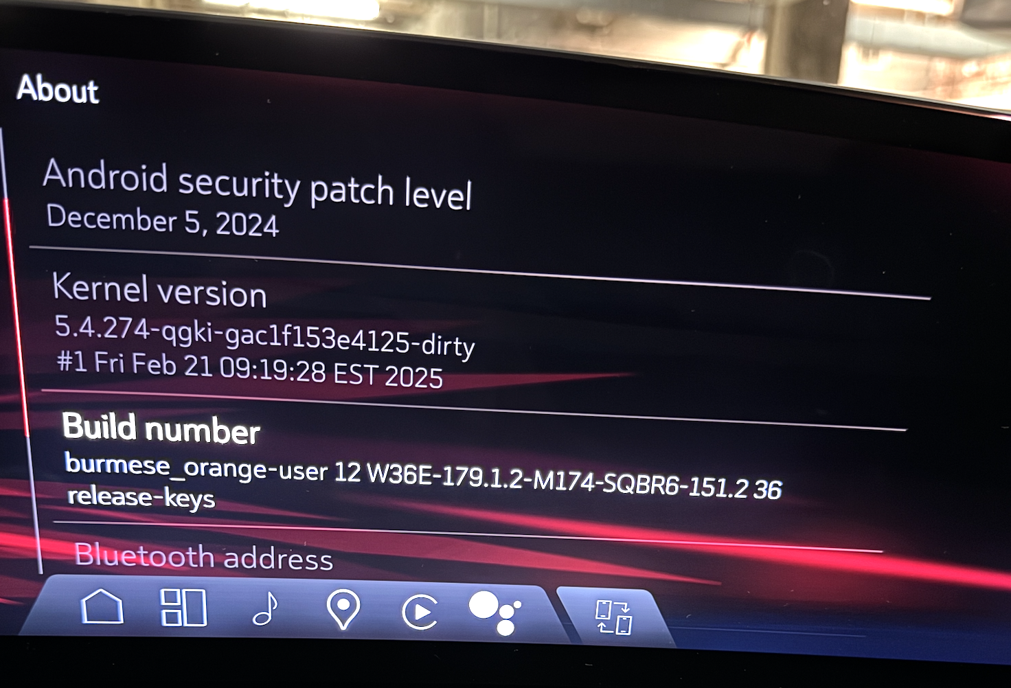

I had the car in for the rear diff fluid change and told them to upload the radio firmware to the latest. This is the latest version, has a date of August 5, 2025. It looks like it's Version 36 which is what I think the 26's are running from the factory.
System seems to be much smoother. My WiFI hotspot issue is gone and wireless carplay works again. PDR/Dash Cam still seems to very laggy. I formatted the SD card to see if it would help. I noticed that there's a separate software package for that which I didn't realize. Guess I'm going to have to tell them to update that next time I'm there.

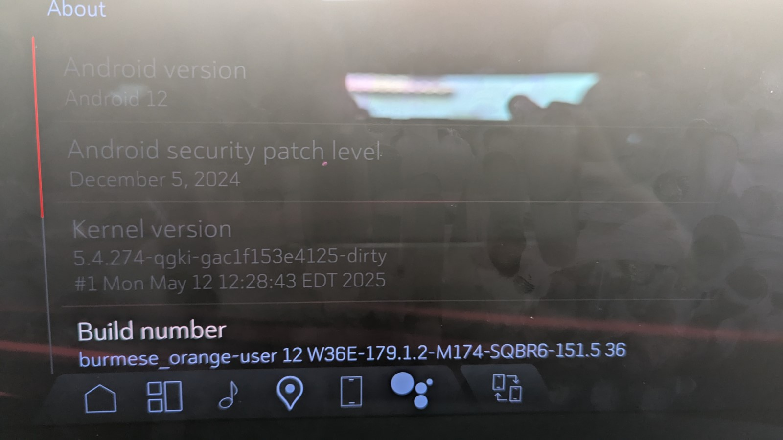

I used SPS2 to install the update last night. Over an hour in total. It took awhile to download (and I have at&t fiber), awhile to "verify", awhile to write the usb, and about 30 minutes to install the update.
I ended up with the expected version: burmese_orange-user 12 W36E-179.1.2-M174-SQBR6-151.2 36

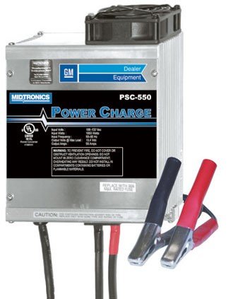

I did find a reference to something called a "programming support tool", which looks like a power supply with a fan on it.
I guess when the dealer does the update they hook one of these up to keep the voltage up.

The programming support tool is indeed just a fancy 12v power supply. It's meant to run all the electronics and take the load off the battery. I think it's more important for big programming jobs than just an infotainment update but clearly GM needs to figure out their 12v management better. This seems to be a common issue across multiple OEMs, even the EV startups (Tesla long ago and Rivian relatively recently) have had 12v management issues. Hyundai/Kia even added a dumb flashing light in the cabin to indicate that the HV battery was charging the 12v.

It looks like there are two versions: PSC-550S (13.6V @ 55A) and PSC-700S (14.4V @ 70A).
