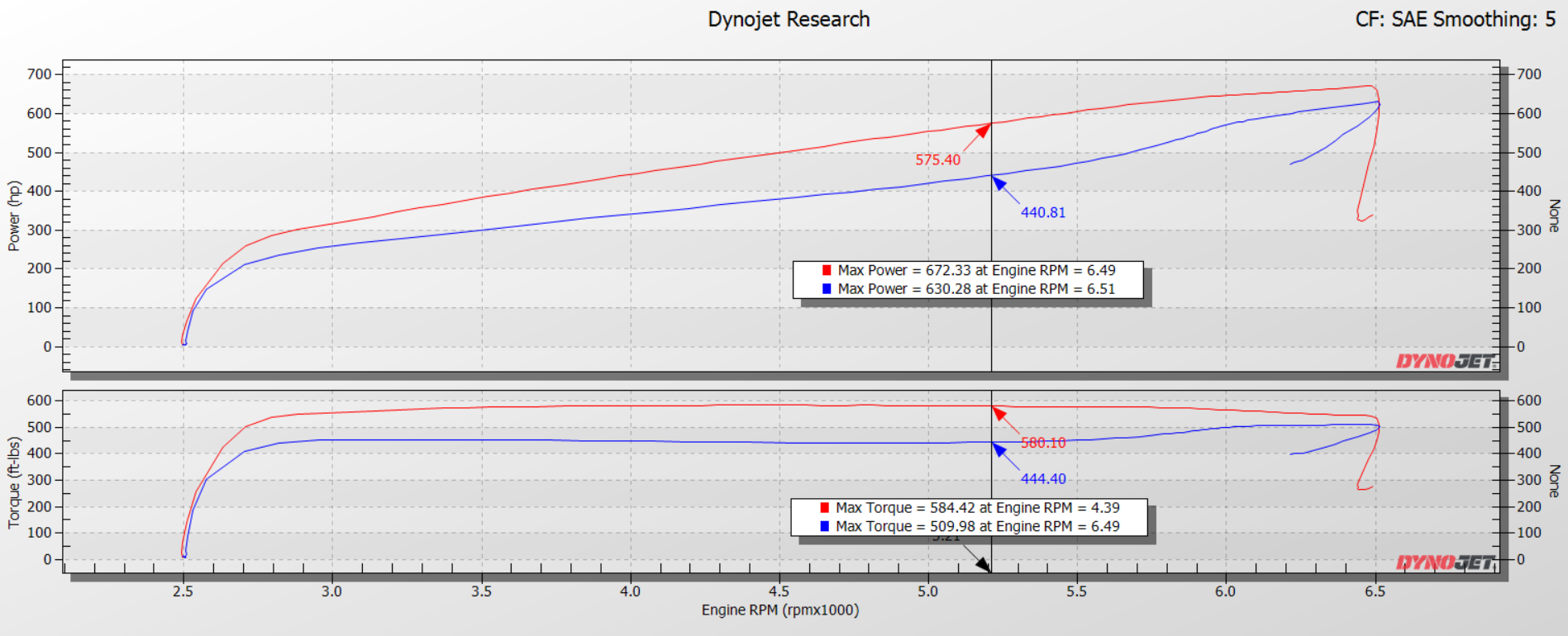

That power level is no problem at all with the CT5-V Blackwings. We did the very first one for HP Tuners a couple months ago. Far more important than the peak power are the gains in the middle of the powerband. You can see here that we picked up 135 whp and 135 wtq at 5,250 rpm, right where it counts the most.
That's where the money's at right there. Very nice!
