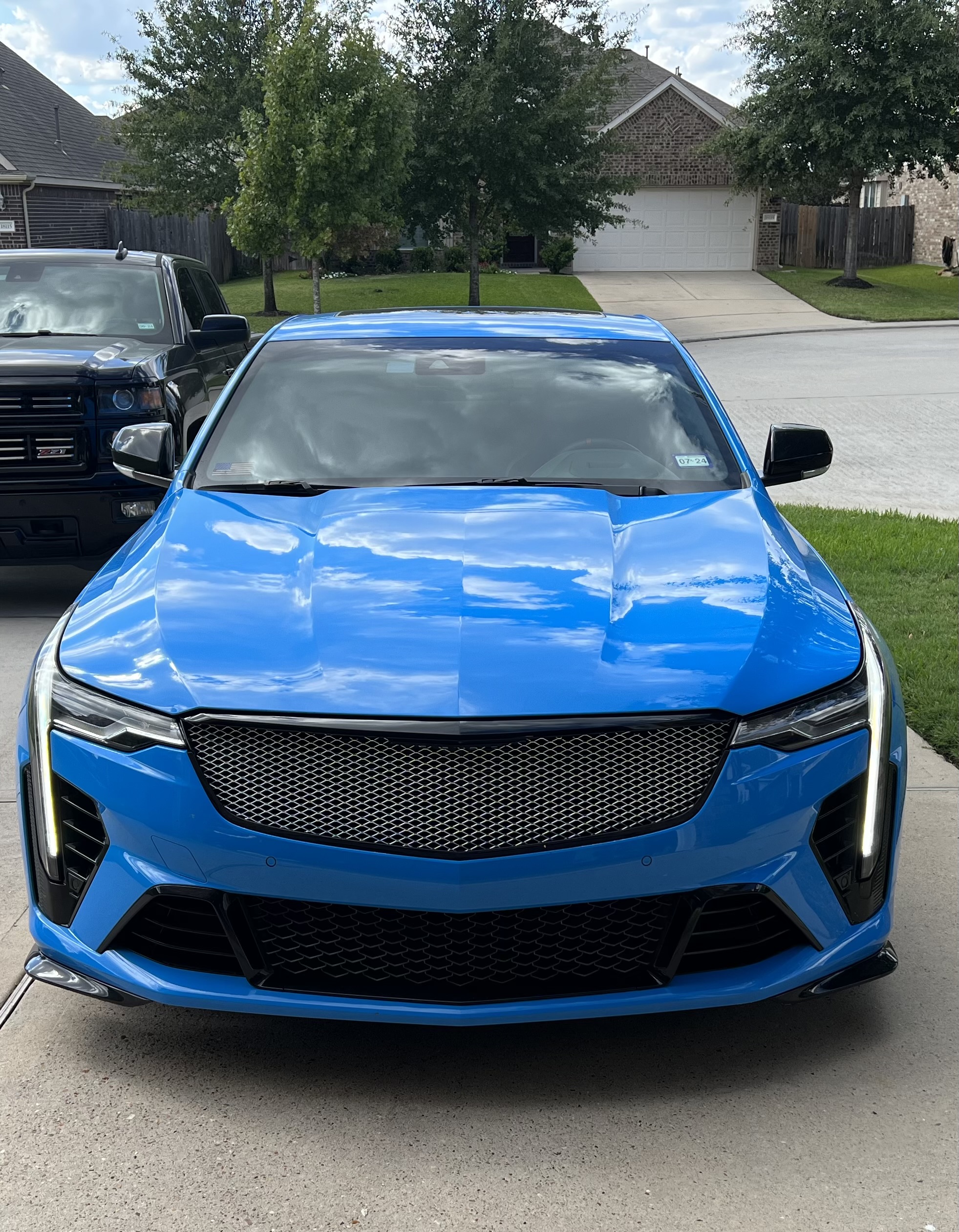

Has anyone removed the front bumper? I started the day by catching something with the upper grill of my car this morning. I did get lucky that nothing hit any of the heat exchangers. Now I’m driving around like a hockey player.
Any tips or tricks would be greatly appreciated.

Update:
I ordered a new grill but won’t get it until the UAW strike is over. So plan B was build/repair the one I have. Took me about three days to do, not a clean as I would like but when Monday rolls around it needs to be back together.

I ordered a new grill but won’t get it until the UAW strike is over. So plan B was build/repair the one I have. Took me about three days to do, not a clean as I would like but when Monday rolls around it needs to be back together.View attachment 22398
I think you did a great job! Don
I agree. Great job on making the best out of a bad situation.
I also agree with @DCV; painting it black would be my preference too.

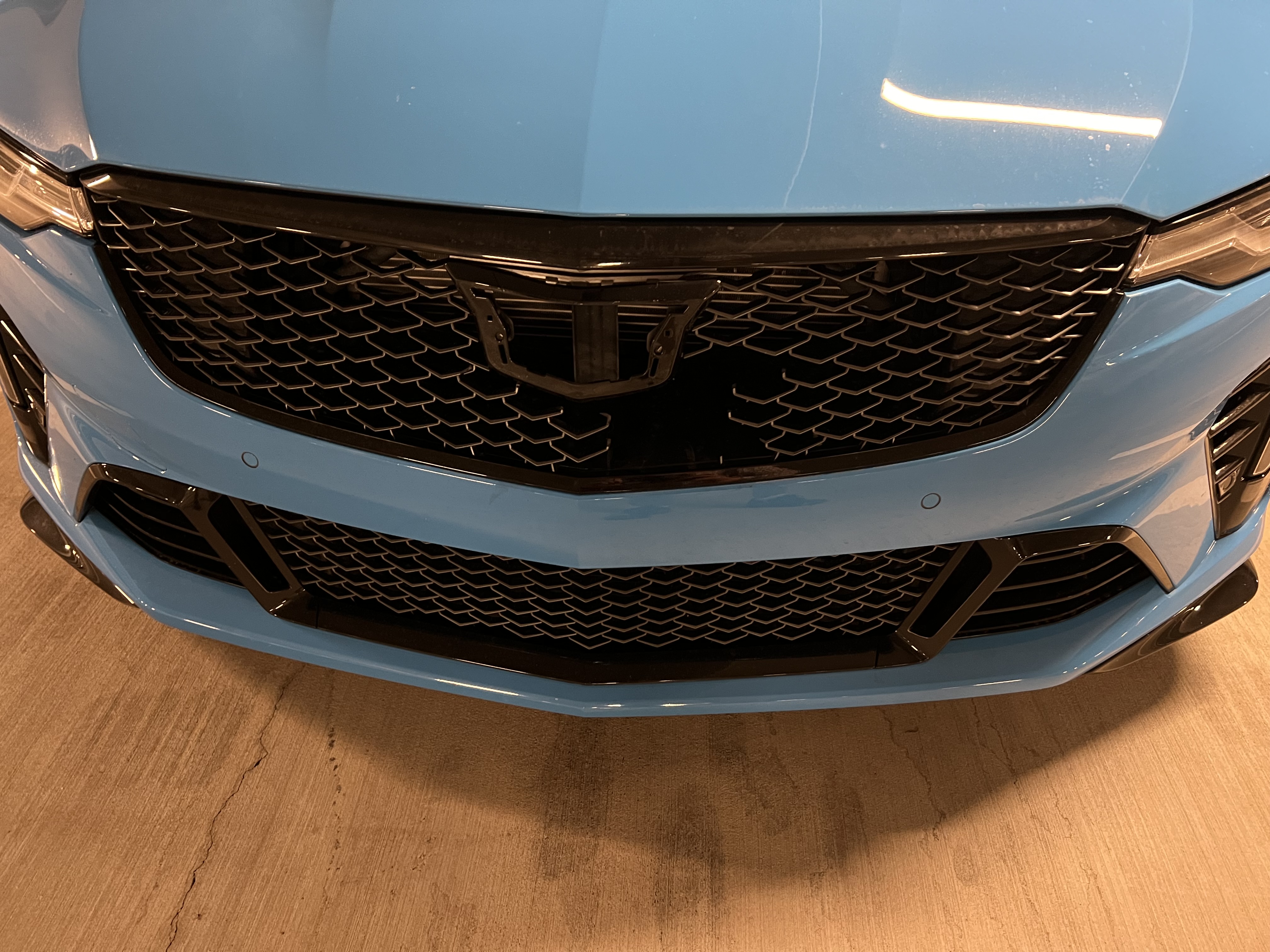

Youve got me wondering now about the dive planes! My Tapout ones come tomorrow and ive got a CF pkg bumper ready to be picked up that I plan on stealing the mounts off of. You say yours didnt fit, what route did you go?
Verify your fit on the factory slotted bumper cover. That should give you an idea if it's going to work well, or what modifications you may need on your modified original cover.

Well damn, such a simple idea and it never even occurred to me! Thank you Lol
I posted all my findings over at this thread in case that's helpful:

Thanks so much! Hadn't come across that first thread yet. It's got me a little nervous I must say. I suppose I'll see how they fit on the new bumper before I modify my existing one. Hope I got a good set coming 🙏. Anyone mention what epoxy these used for the mounts? Was looking at 3m 8115 but 65$ for a little bit, hopefully something more affordable will suffice.
