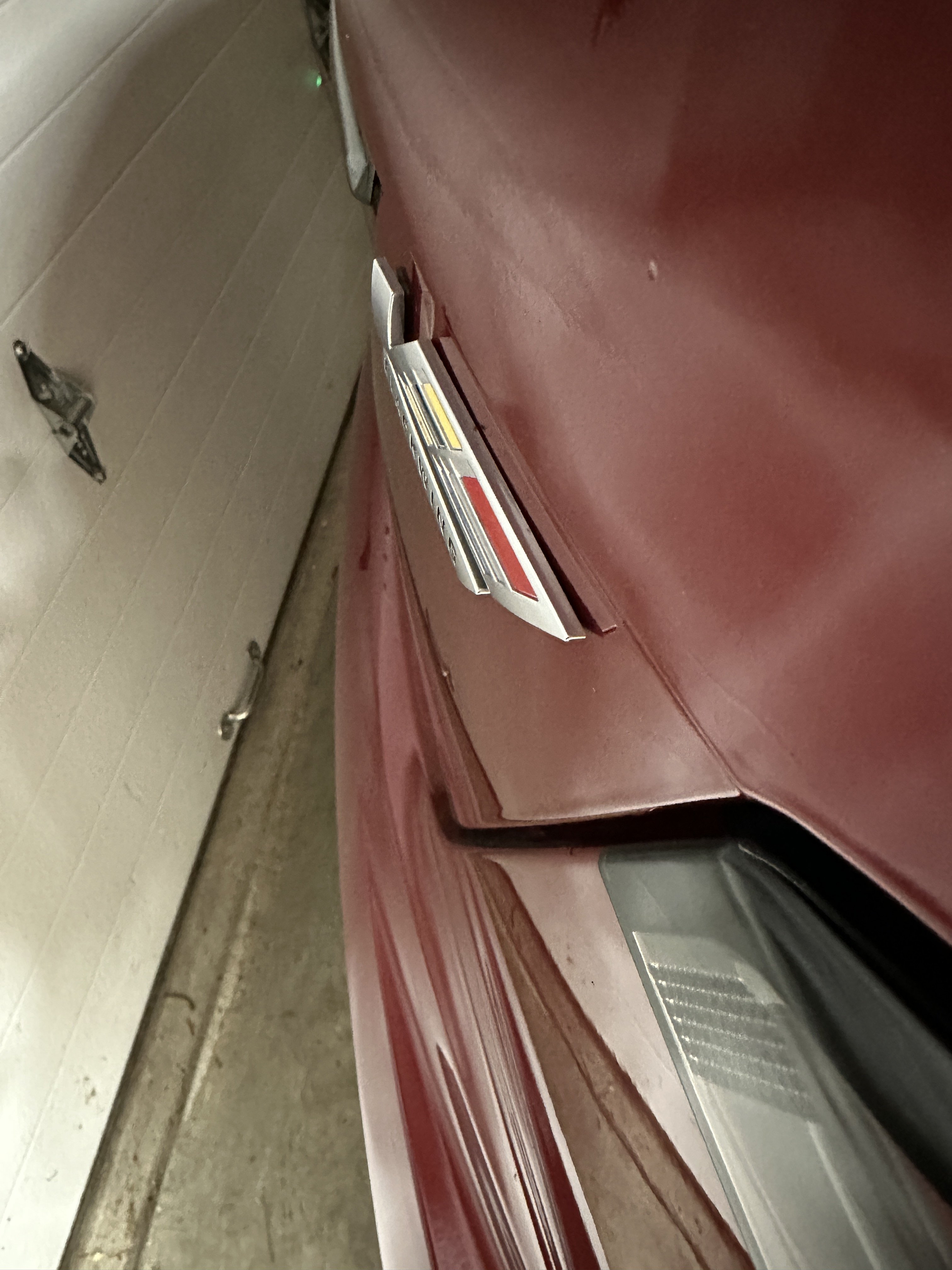

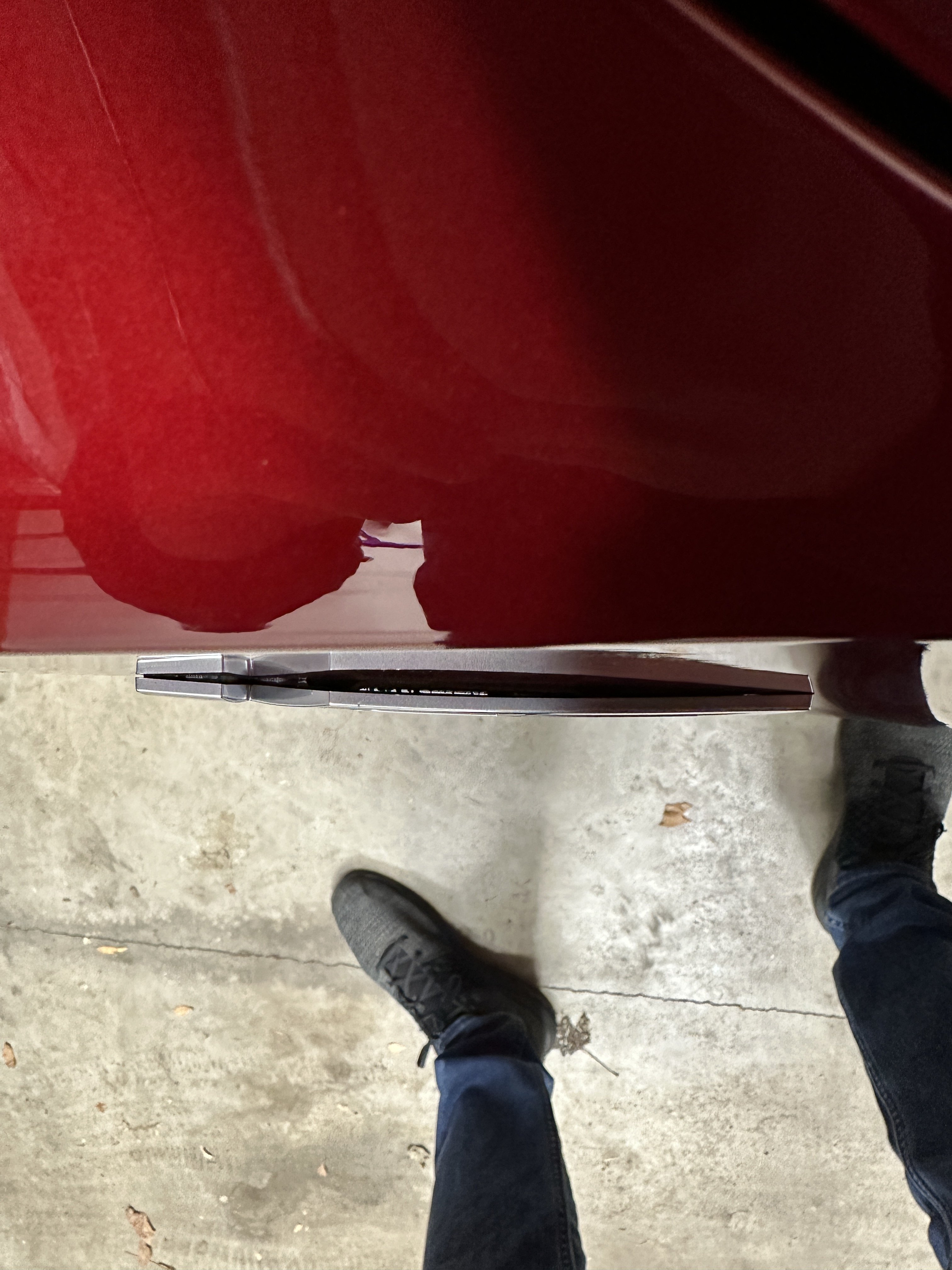

I had my car PPF’d and the badges were removed and reinstalled. The badges have all started peeling off the car. I had a couple of them redone after the first couple weeks and now they are doing it again. The tape they used is a double sided black foam tape (asking them for exact type so I don’t buy that kind).
For people that rebadged or changes badges, what product did you use and has it held up? This could also be on different cars if you didn’t do anything on your blackwing.
It seems the plastic V badges like to warp or curve somewhat which is pulling them off the car.

Which way is it curved? If it is curved outward in the middle its because they probably used the rear badge (which has a slight curve to it to accomodate the trunk lid) on the sides (side badges are flat).
I think you are exactly right! One side badge curves out in the middle and pops out. The back badge is flat and is peeling away at the edges. One side badge seems fine (which much be the correct application). Thank you!
