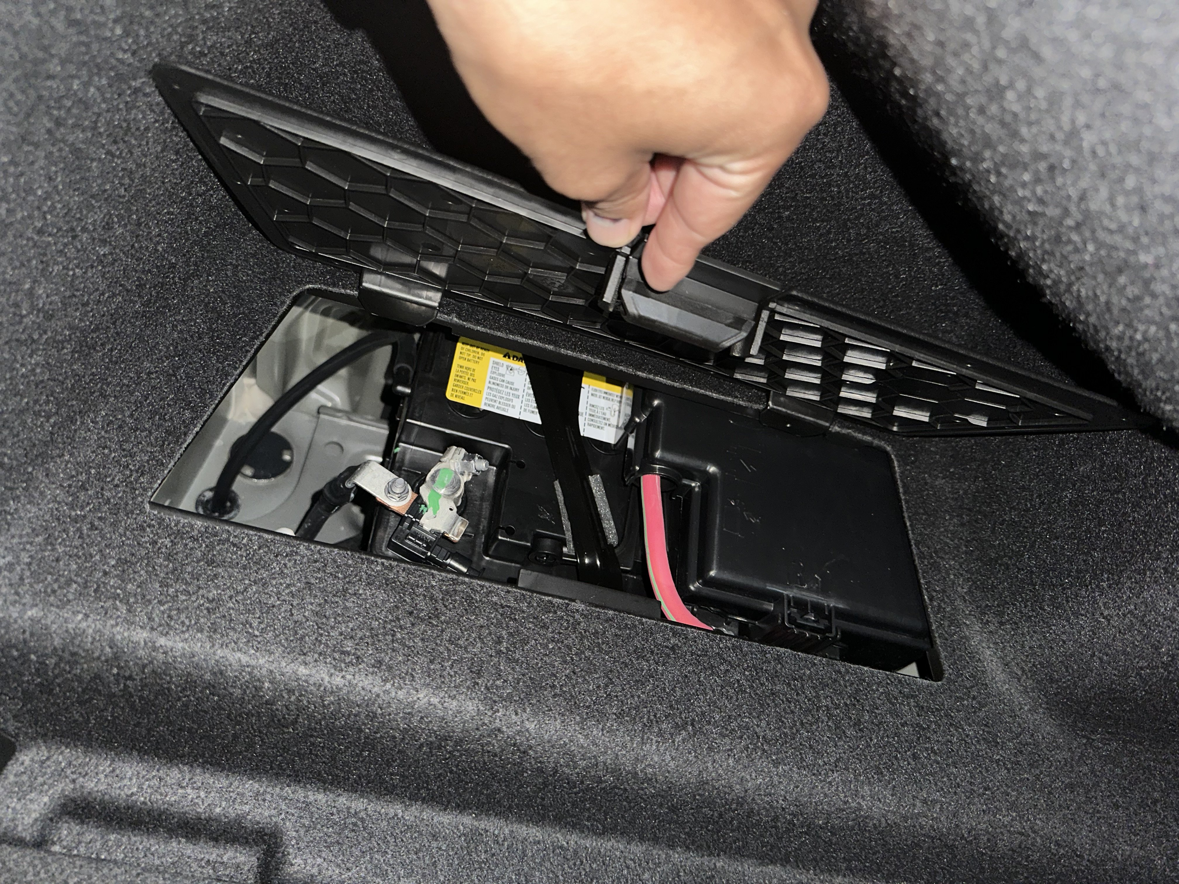

I was looking at the trunk but the battery opening is very small. How did you guys able to install the device? The hot wire is even covered and not enough space to remove the cover.

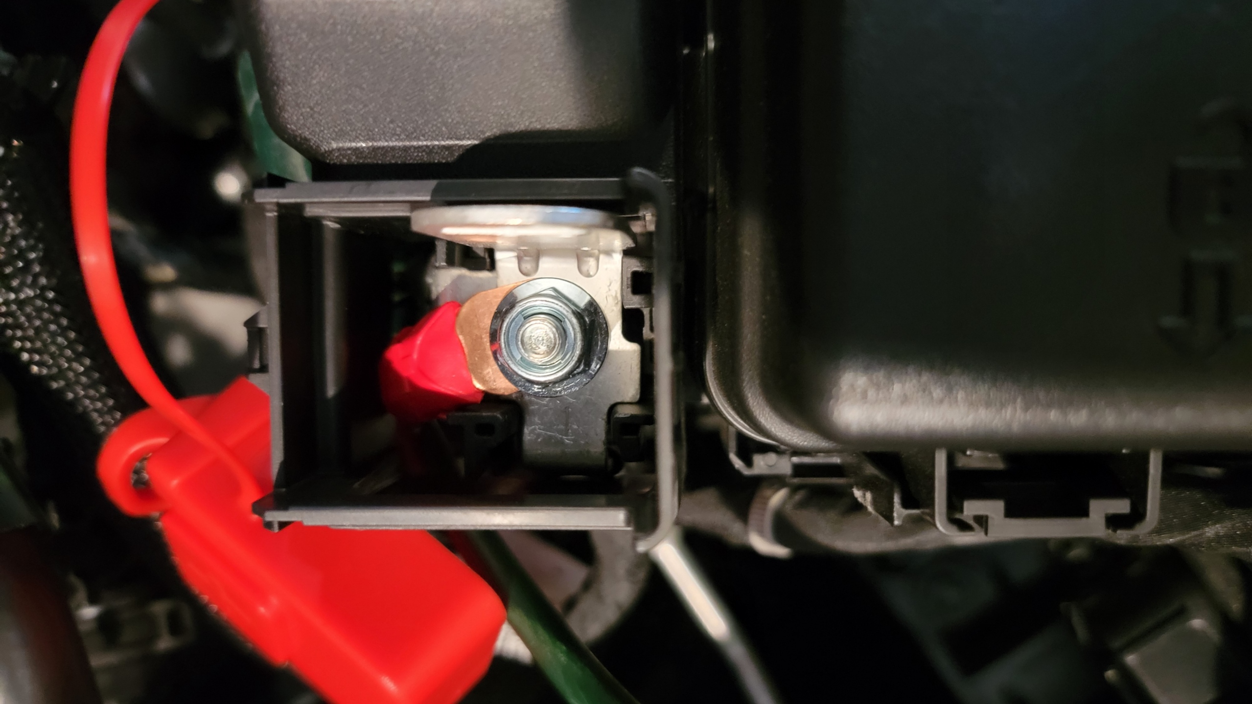

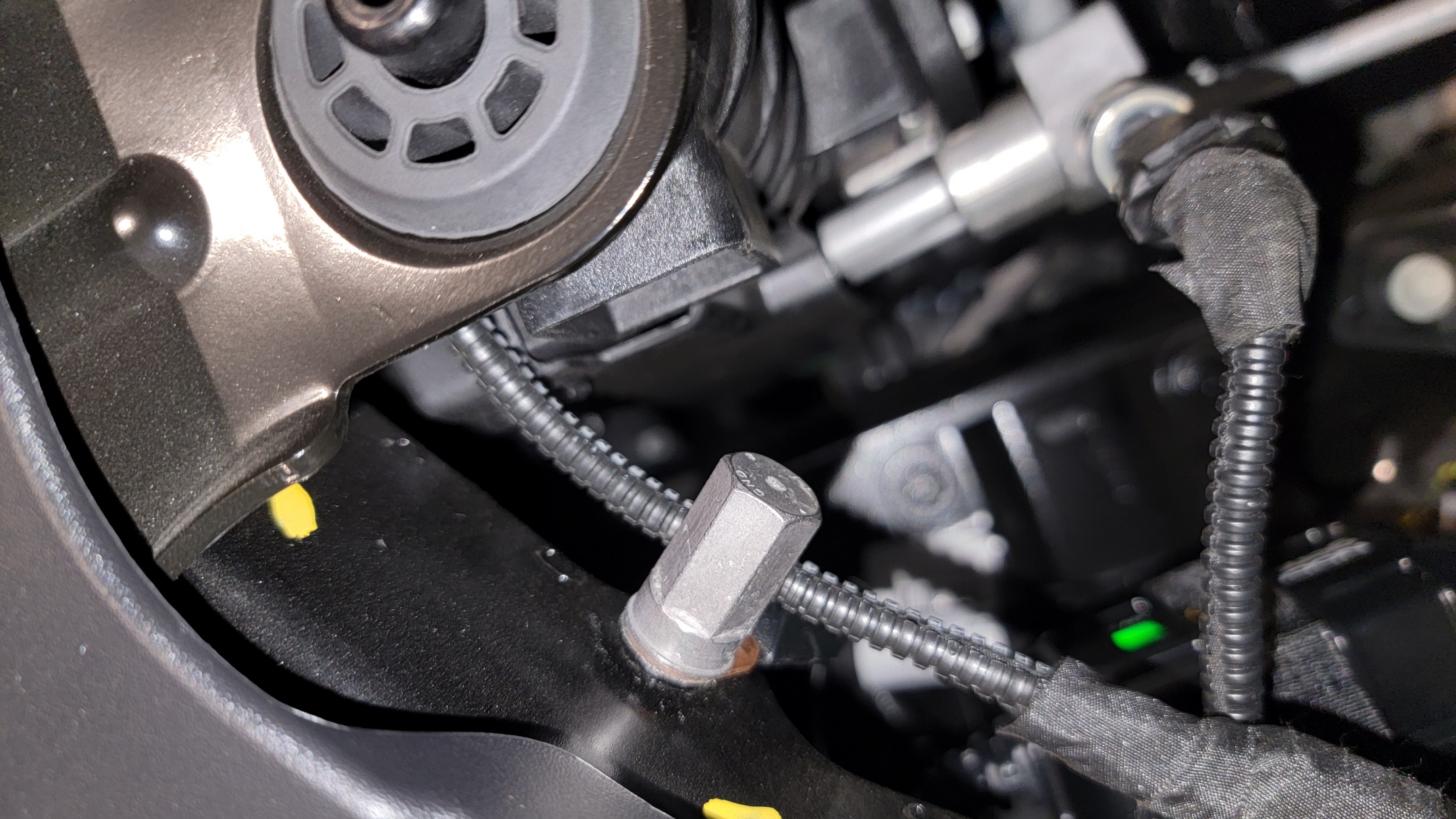

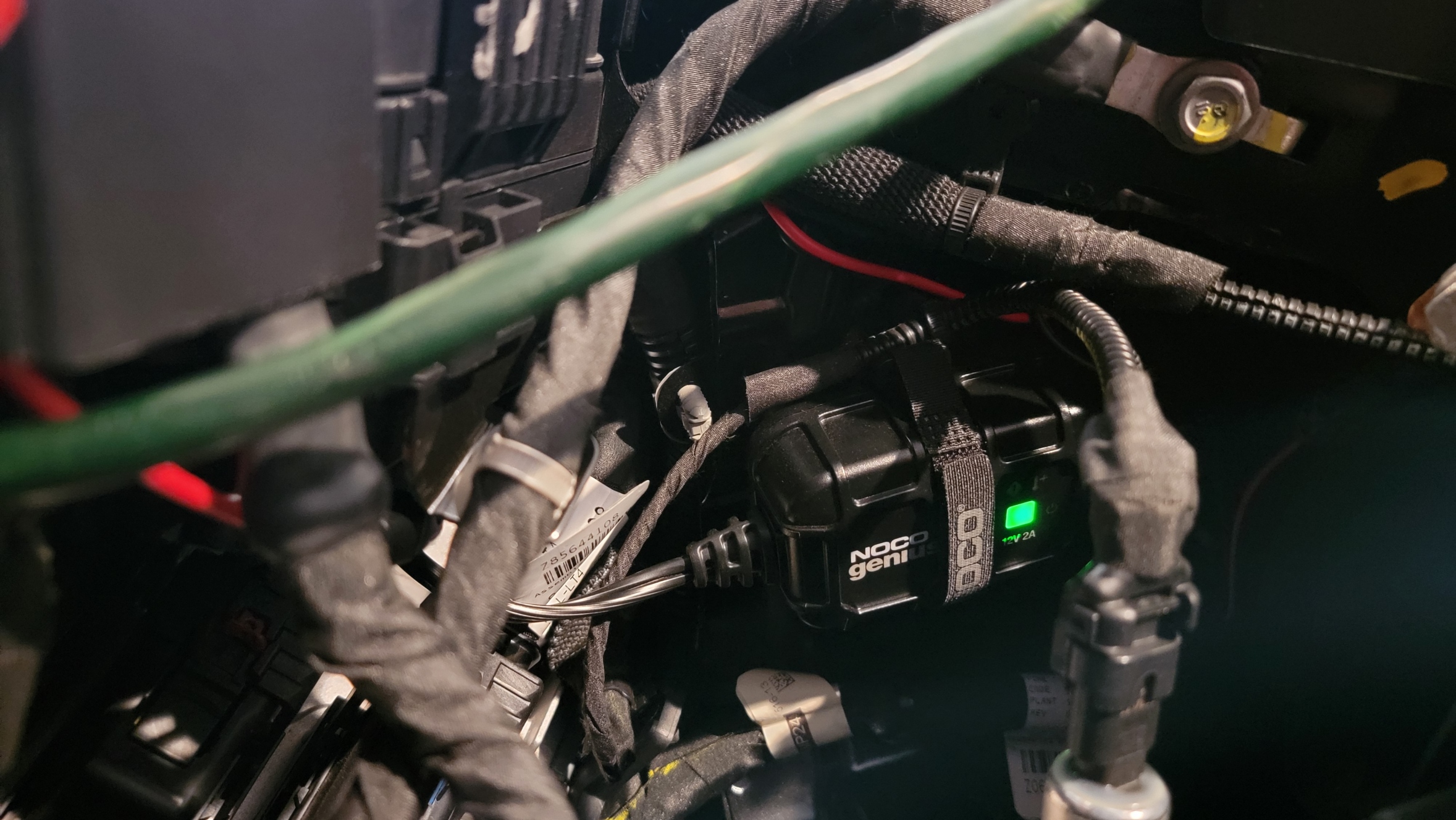

I connected to the under hood jumper lugs. The ground lug unscrews and just remove the + nut. Super easy and clean if you take time to hide wires. I mounted mine below the ground lug, you can see the blurry green led in that shot.

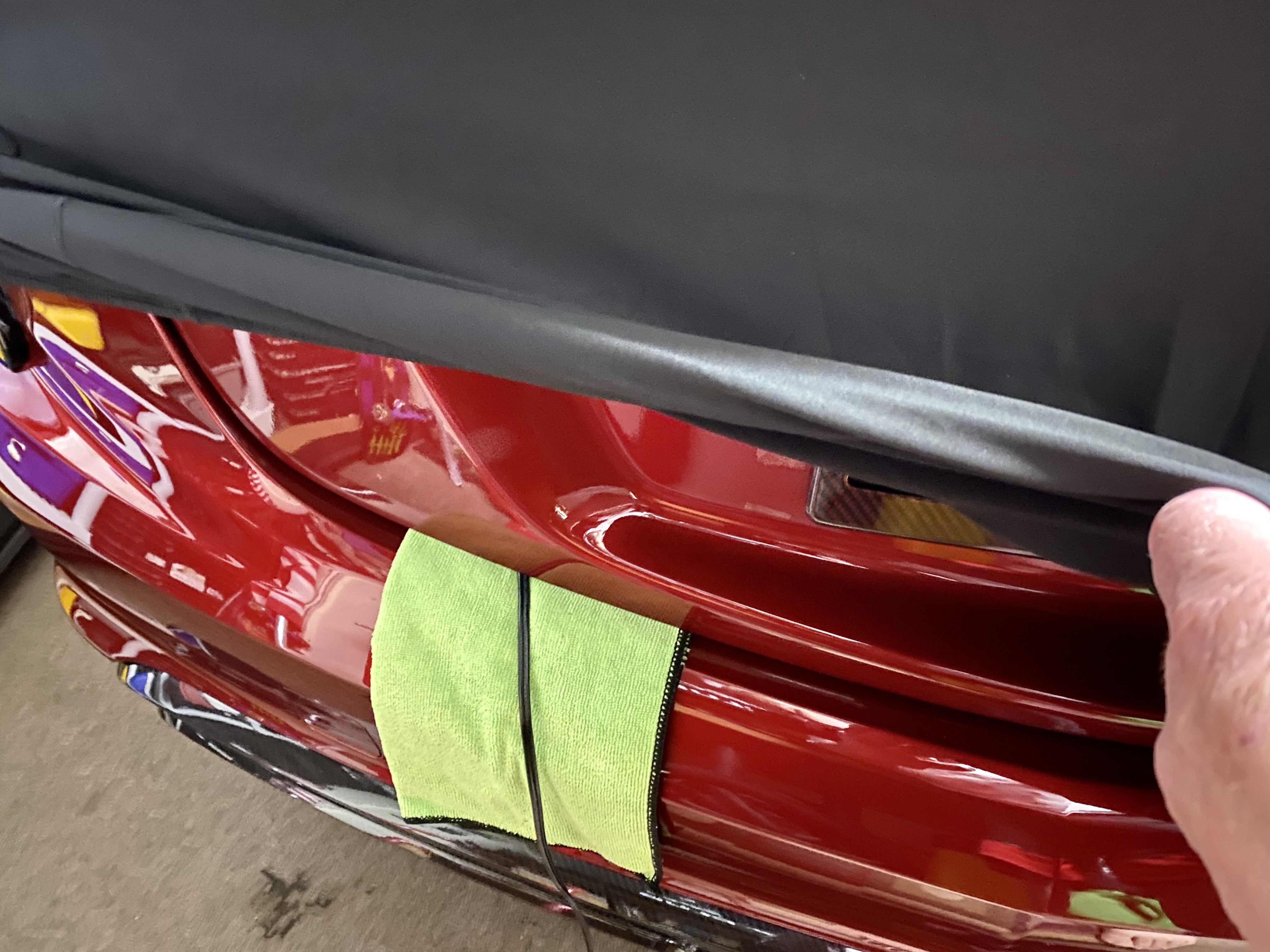

I mounted a CTEK harness directly to the battery in the trunk. In order to get to the terminals, you do have to pull the side panel off, which is a bit of a pain but easily doable with a little time. The wire isn't pinched by the trunk closing since the seal is very soft and pliable. I thought about going to the engine bay, but felt the trunk area was a bit cleaner and it was closer to an outlet for me, so I didn't have as much power wire across the floor.

It's rated IP65, so its designed to go under hood and get wet like anything else under there. I leave my hood shut to the safety latch setting. Everything is located in the driver side front, right where the red power block is.
Some folks are uncomfortable with the remote mount, so find a suitable location that you're comfortable with. The load going through cables intended to transfer 100's of amps in the case of a jump start are more than cable of transferring a max 2 amp load...I mean look at the 16ga wires coming out of the maintainer.

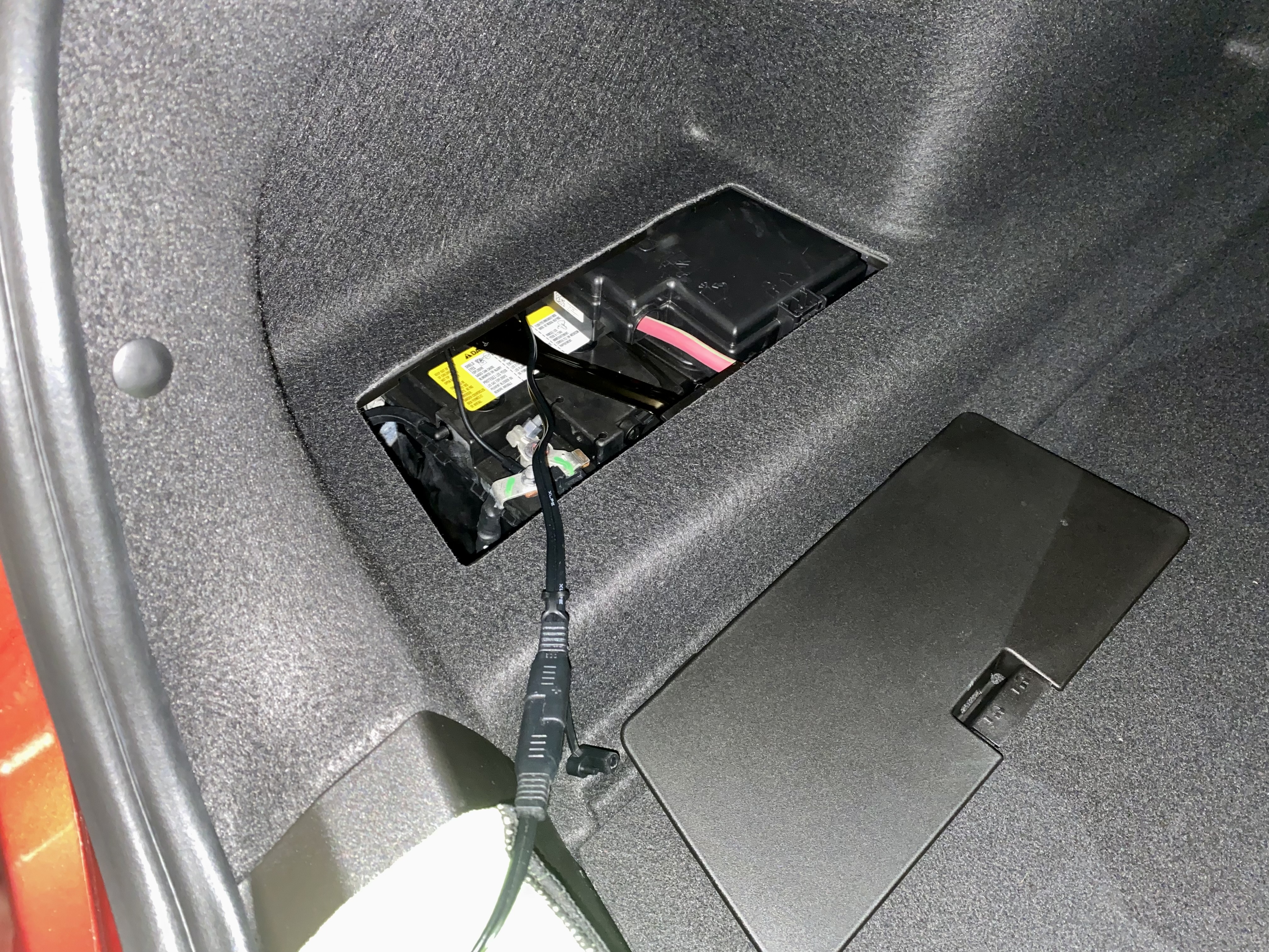

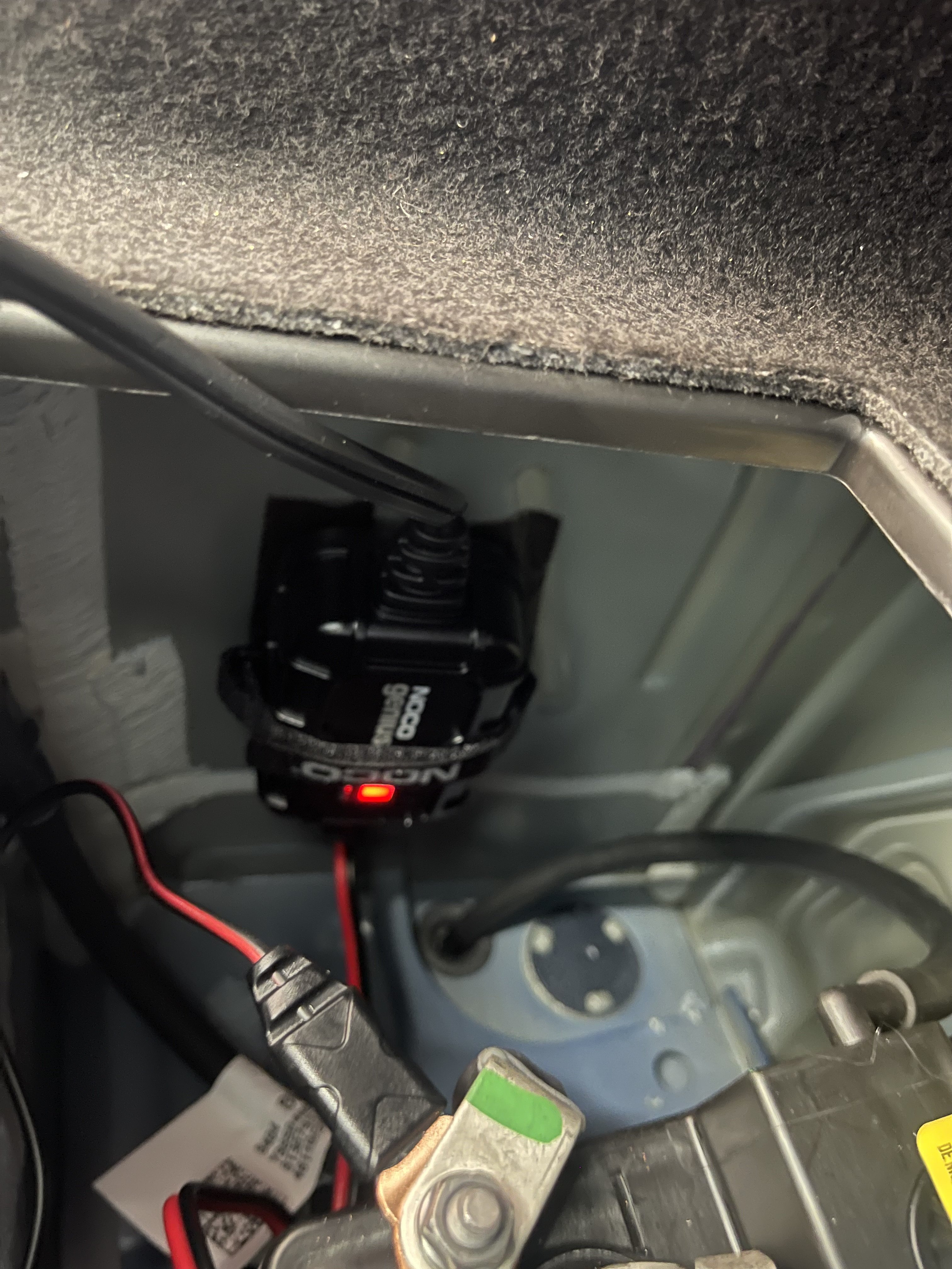

I removed the trunk liner to get full access to the battery. I mounted my NOCO in the trunk.

That looks nice and neat. How did you remove the trunk liner? which pins? can you please send me pictures? im going to purchase the one you recommended for tools.
Sorry, I'm away from my BW until October. Honestly, you would just remove the ones that look like they are in the way. You don't have to remove the whole thing, just 4-5 that are on that side. It's flexible, so you can bend it out of the way, remove the cover, install the NOCO wires, and re-attach the cover. The NOCO wires fit nicely under the cover.
