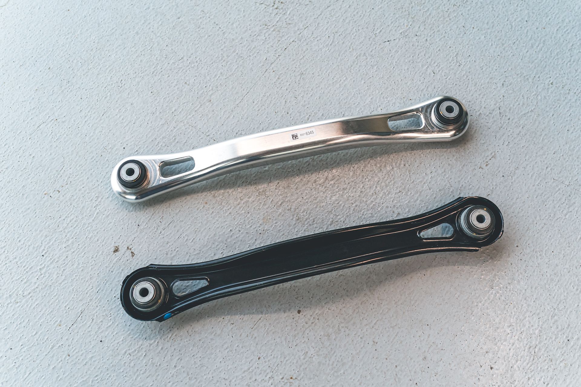

I understand that all new cars with the precision pack are supposed to come with these new toe links that are Dealer installed during PDI. My Dealer is indicating that they did not come with the car, does anyone have a photo of these links that I can show them?
Here's a picture of both from one of the Car and Driver articles:
Hopefully they didn't lose them, the MSRP for one 85016345 is $1219.38!!

Appreciate the photo, no links in the trunk so the Dealer opened a case and has no doubts about them getting a set for me.
I guess the Dealer can choose to charge you for the install, mine is not going to and also including new bolts.

Provides more camber in the rear. About a half degree I think.
Plus the piece is more solid so there will be less flex. Since we are not professional racers, I doubt we would notice a difference though.
Theyre shorter, allowing for more max neg camber in the rear
According to a Car and Driver article they are "about 0.1 inch longer"
It's believed that the shorter part shifts the range of possible rear camber about -0.4 degrees.
Good question. I think the max rear camber goes from -1.6 to -2.0. I would think the min would be 0.4 diff as well.
As soon as I have them in hand I can measure, although, it appears like the links sit above the axle, so it must be shorter than standard to accomodate additional neg camber.
