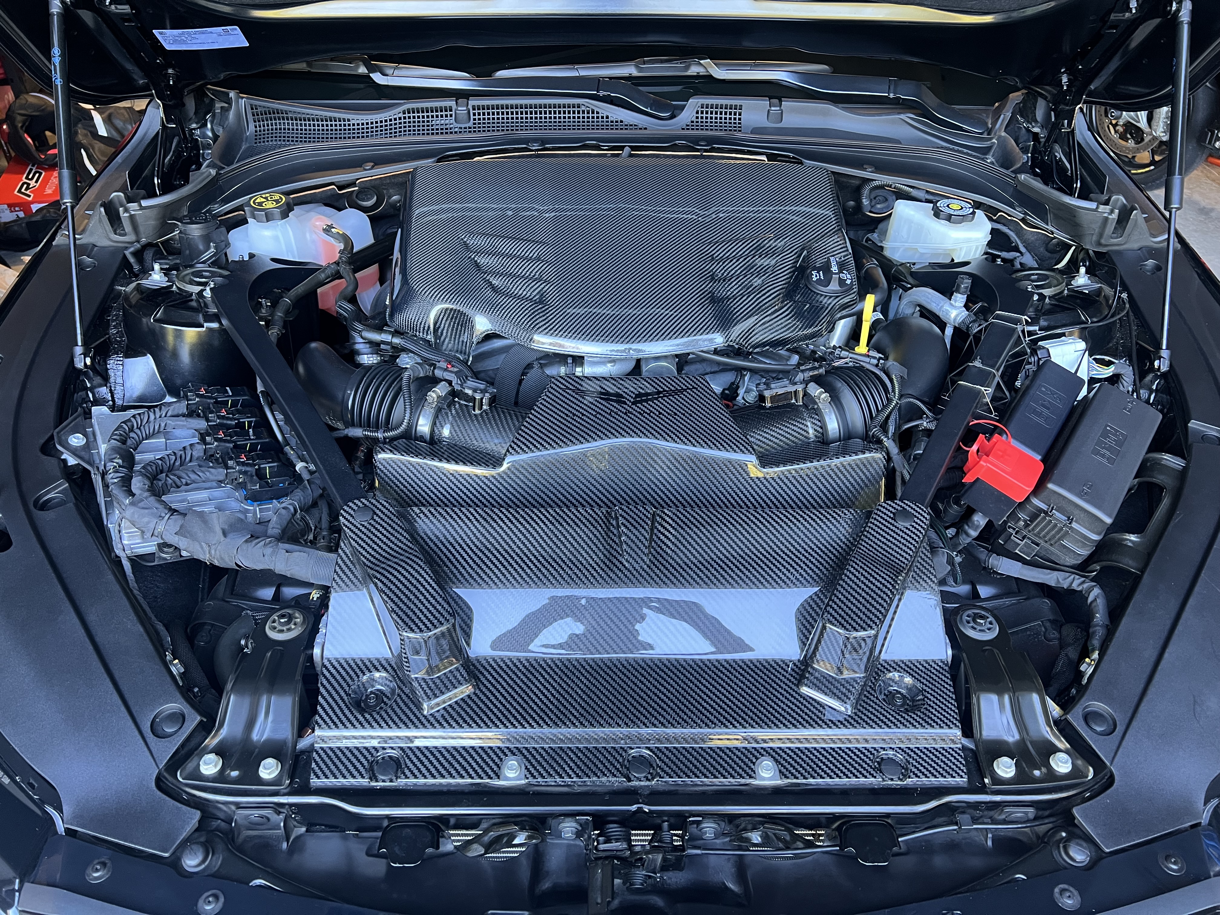

It does….mostly on cooler days. I got the Tapout assassin module that clears it with a press of a button. Otherwise it’s a bit of a longer process using the jb4. Also tapout recommended Boostane to me to get to 93octane. I been using it for over a year with no problems. As a bonus with the CF intake it really pretties up the engine bay especially when combined with tapouts other cf goodies.
