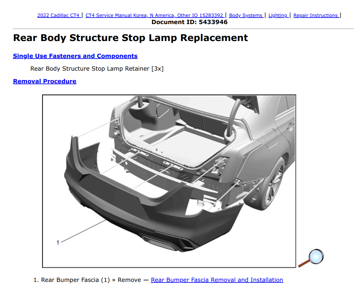

I sent you the service manual instructions. Yes, the bumper cover needs to come off.
Here is step 1 from the service manual for the CT4:

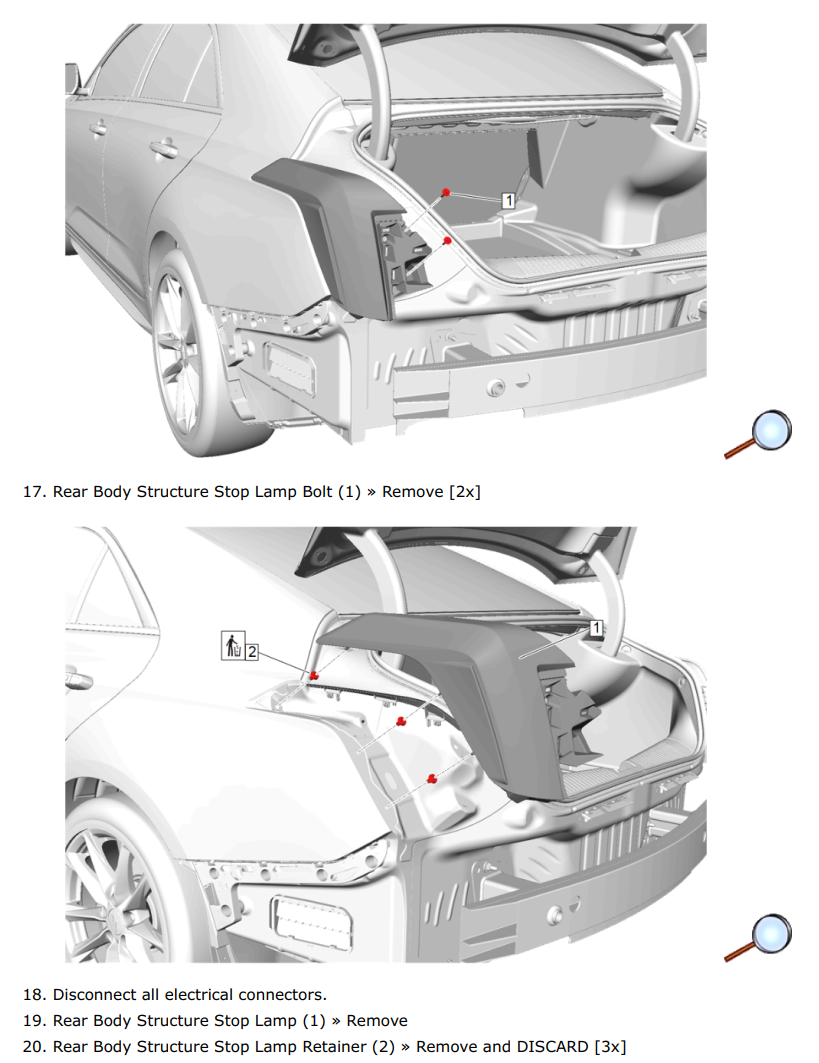

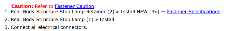

Likely to get access to these two bolts in step 17. Also, you are supposed to replace the three retainers shown in step 20. That's after you remove trunk trim side gutter, rear trunk trim, and trunk side trim.
