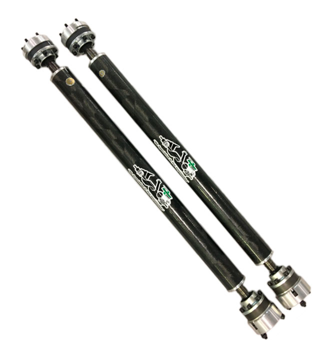

@JB5359 What do you think of the CF drive shaft? With how well it seems to be balanced and setup I'd expect even less NVH coming through. Any other things you've noticed, good or bad? I'm about to pull the trigger and thought you might be able to provide us some insight. Lesser designed one piece drive shafts certainly cause their fair share of issues.

Quick question for @WONT TAP
On ordering the CF drive shaft, I see it comes pre-selected with ATS-V shifter bushings. Is that a known upgrade for us Blackwing people? It was common practice in the Porsche crowd to move to GT3 shifter bushings as they were billet aluminum instead of plastic and really improved feel. Just want to make sure I get everything right before putting the order in!

We have not yet test fit the ATS-V shifter bushings in the CT4-V Blackwing, so we cannot confirm they are interchangeable at this time.

Carbon Fiber drive shaft in with the differential lock out bushing:
I was going in expecting a bit of a change. Maybe nothing noticeable until winding the car fully out. I was not right about that. Coming off the clutch is noticeably smoother without having to pay as much attention. Seems the weight drop is pronounced at low speed and low throttle application.
Trying to find some expert information on if the drive shaft has a gyroscopic effect. It'd stand the reason it probably does. From the feel it seems like the car is more eager to dive into the corner without less of that corrective feeling from a gyroscope.
Seems like just about everything I was expecting from the change and a little more. Expensive but the improvement in driving feel is really worth it for me.
Only thing I would note is there's a mild harmonic at 50 mph. It's not loud and the shop I installed it at has done other cars with single piece drive shafts in CF from the DSS seemed to think it was normal. Seemed well within normal to me as well from my experience. Removing that much rubber and slop from the system is bound to have a bit of noise. But above and below 50 all the way into the 100's is just as quite as stock. Just be aware if you're exceptionally sensitive to extra noises.
