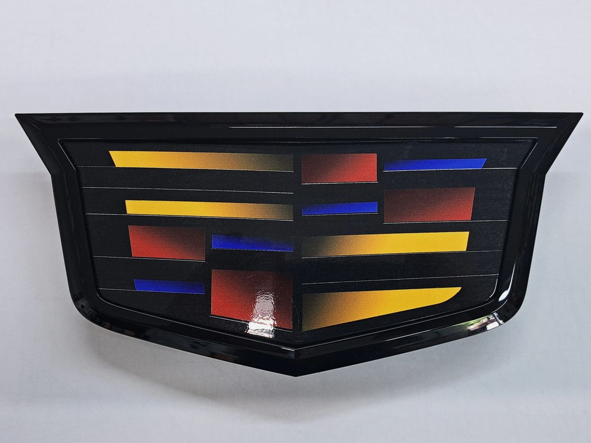

It is an A10 and the badge was purchased from savagecadillac.com and is the adaptive cruise badge and is compatible (Oliver, the owner of the site confirmed this and others have ordered here before so I trust this). I think it's just a sticker overlay on a factory adaptive cruise emblem, but it looks good regardless and I think I need a new emblem anyways.

Sure thing. Here you go:
Idk if this is a new release or not, but it appears as a pop up on the website whenever I visit it. Maybe because it's a newer release? No clue.
