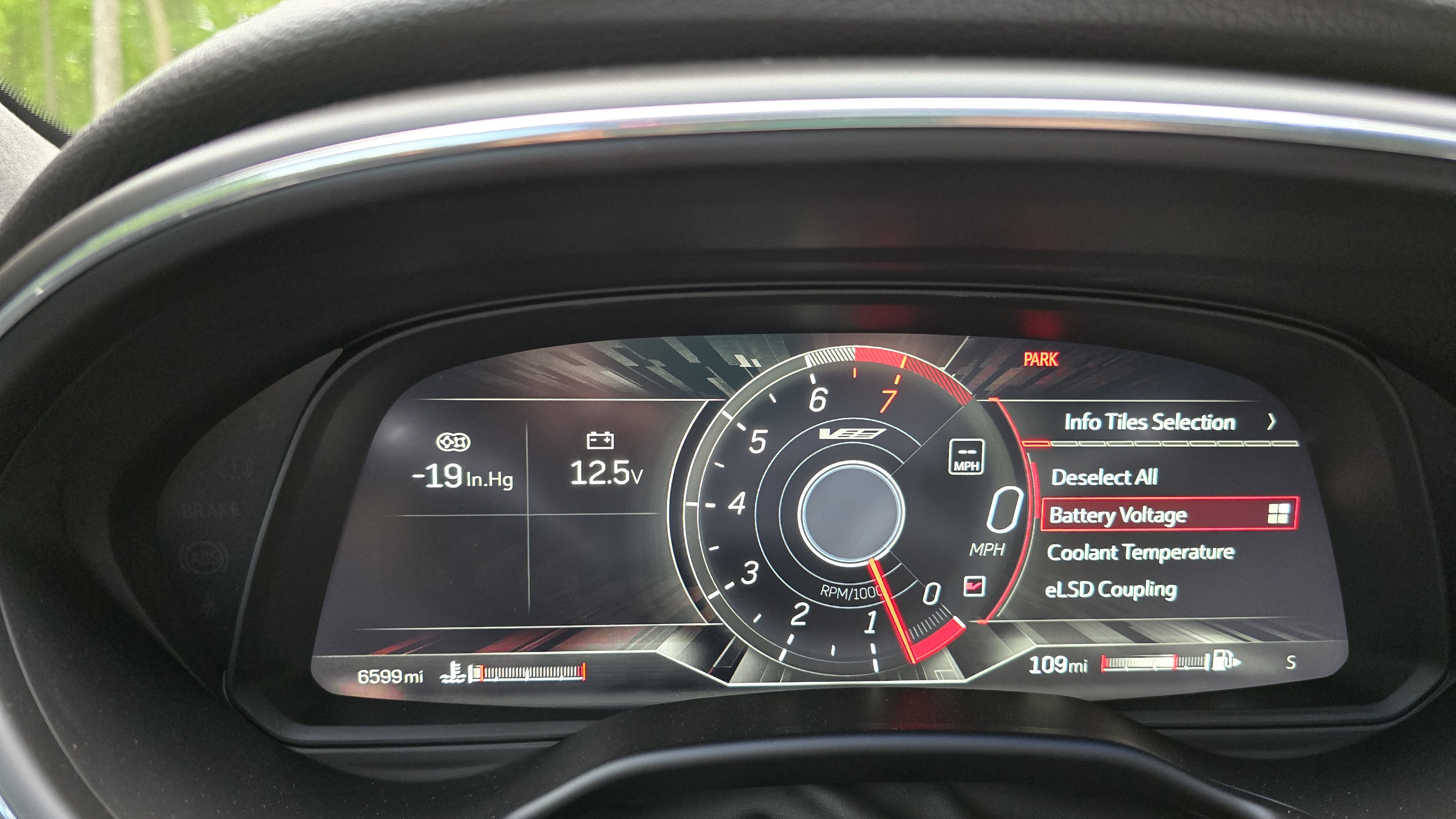

So I just got my '22 5V blackwing on Friday and I'm getting used to it, has 6,600 miles. One weird thing I've noticed is that at idle and while driving, the battery voltage is hanging out at 12.5, which is very unusual. I just drove it for 20 minutes and when I got back to my garage and the fans kicked on and I revved it a few times, the voltage went up to around 14.1v and stayed there while idling.
I have no warnings on the dash or anything and I'm wondering if this is something I should have looked at?
The car will constantly compute the voltage needs and adjust charging as necessary. Just driving along is not very taxing on power needs. Any time extra load is sensed, there will be an adjustment to compensate. I don't see that you should be concerned.
Seems normal. Range at idle could be anywhere between 12.5-13.5 so I would keep an eye on it. The voltage will go up as you rev it, that’s normal as RPMs go up. Quick test, at idle turn on all of your accessories and watch the voltage (ac, head lights, radio) and see if it drops below 12.5. I’ll have to jump in my 5BW and see what it says at idle. I wouldn’t be too concerned.
I don't pay much attention to it in my BW, as I dont have that toggle on typically, but In my Camaro its on the dash.
This question seems to come up quite a bit on Camaro 6 forums. Its normal. The car regulates what it needs and will move in that range. Mine very often sits around 12.5v spot.
Drove today and it was at 14.6v on highway until I pulled into a gas station and turned it off. When I started it up again it then stayed around 12.4 or 12.5 the whole time I was driving. It seems very odd compared to anything I'm used to, but maybe it's normal.
