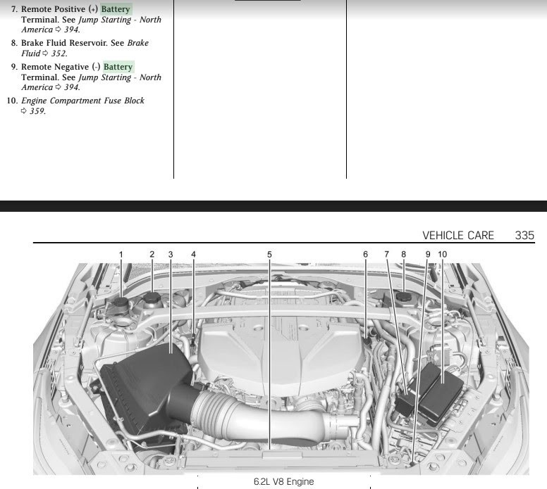

Most are running a charger off the remote connections under the hood.
I have looked thru the book nothing is explaned. I have look at the red cap under the hood but it does not show on the cap if it is pos or neg
Red cap is positive.
I clamp the negative of my tender onto the post thats on top of the driver side shock tower. Theres a lug+post sticking up.
The positive goes to the battery under the red cap.
Fairly clear in my manual.
