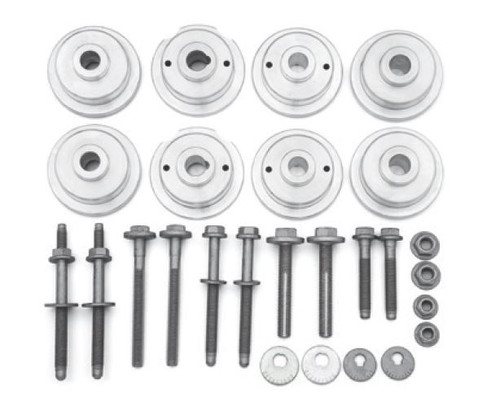

Opps! Don't forgot the Camaro solid rear cradle mounts.

Solid cradle mounts not inserts? Do you have a product link? The Camaro guys love the BMR inserts but I was told they don't fit the BWs. I think my offseason suspension stuff will be limited to camber plates and the toe links.

Hi all,
I own/operate Revelry Racing
We do lockout kits for some Cadillac models and have handled these things quite a bit. While we haven't installed a set of the solid inserts into Blackwings, I would bet that they fit just fine. The other blackwing subframes seem to have the same architecture and the bushings seem to be the same outside diameter as previous models except that the OEM BW front bushing isn't rubber, it's already a metal cage (and one we are working on a lockout kit for. Let me know if you all are interested in those using poly inserts.
