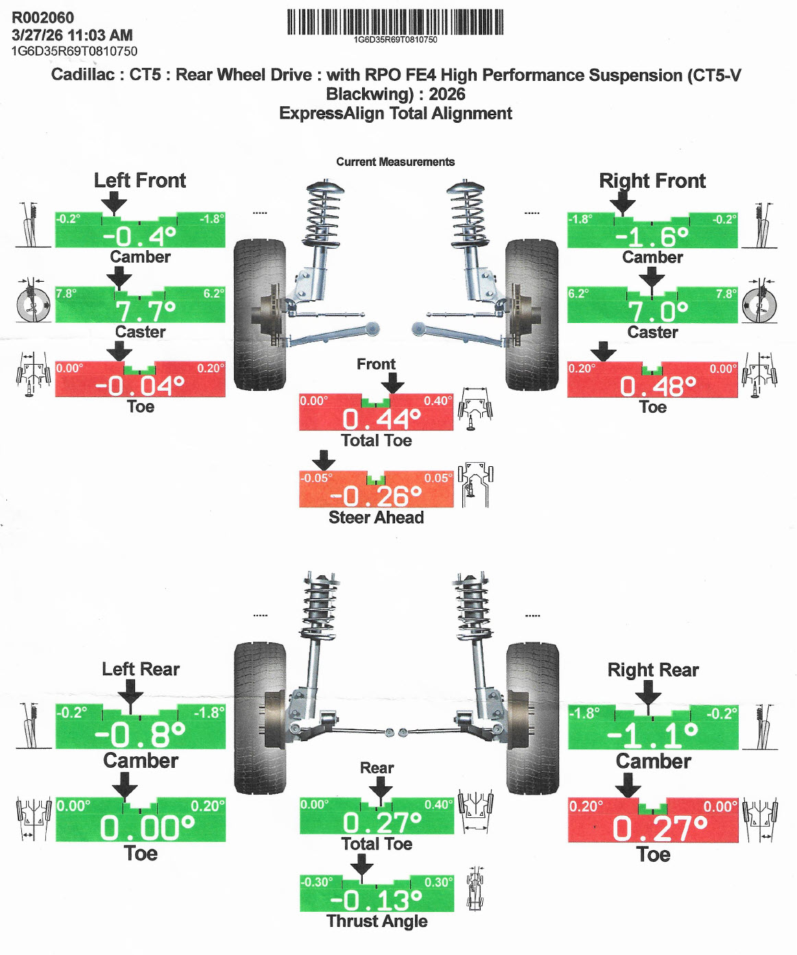

Picked up my CT5 V BW on 3-13-26 and took it in to swap to all seasons on 3-27-26 with less than 100 miles on the odometer and they offered to check the alignment, which they did. Went to the dealership to schedule an alignment and the service writer looked at me like I was crazy, even after showing him the print out. Anyone else have their vehicle need an alignment at delivery?

I can't say that I am surprised. Almost every new car I have ever bought has needed an alignment right off the showroom floor, especially the performance cars. Plus, I generally like to max out the camber and run zero-ish toe anyway.

I had same issue in 2024 when new…car pulled to one side when steering wheel center stripe was centered. Dealer said give it some time to let suspension settle lol. I had them drive it and they did the free alignment.
I had them do the track alignment before I picked it up. The before alignment specs were terrible. Especially the toe on one of the rear wheels. If GM will align it free within the first 12mo, then I recommend taking advantage of that if you have steering that does not feel 100% perfect.
