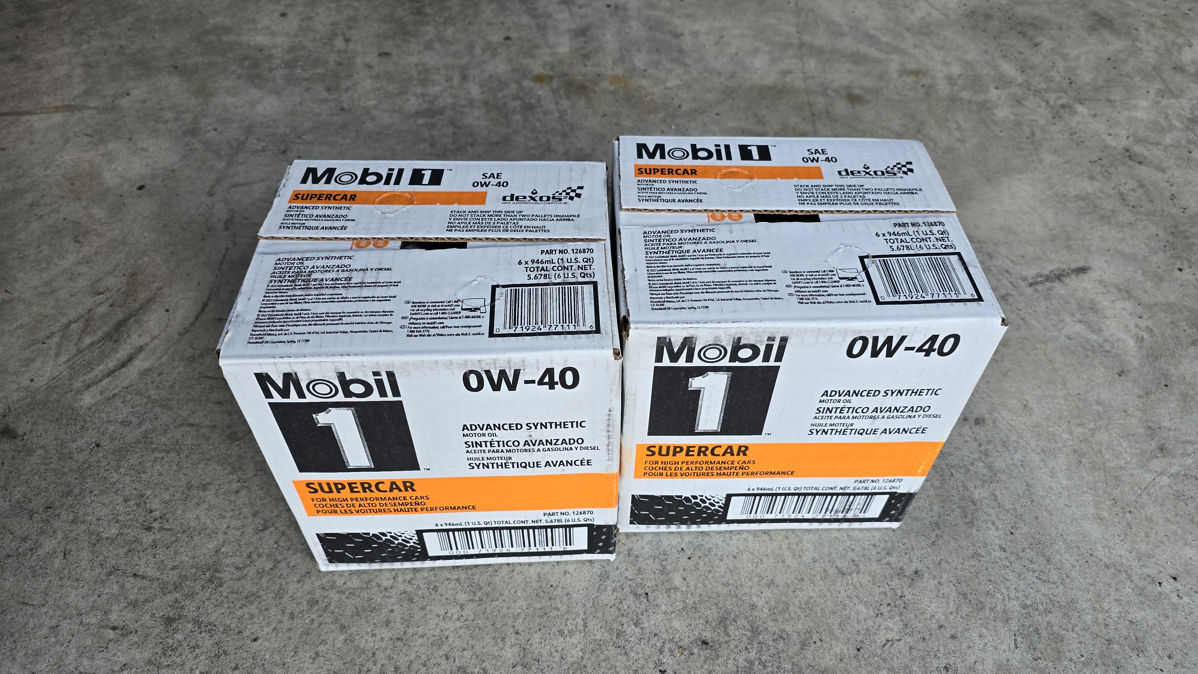

Autozone had supercar on sale with 20% off and free shipping. Picked up 9qts for about $99 shipped. Not a killer deal but better than $14 a quart.

Just ordered oil from Walmart online for $9.87 a quart for Mobil 1 supercar and $6.04 for PF64 AC Delco oil filter
