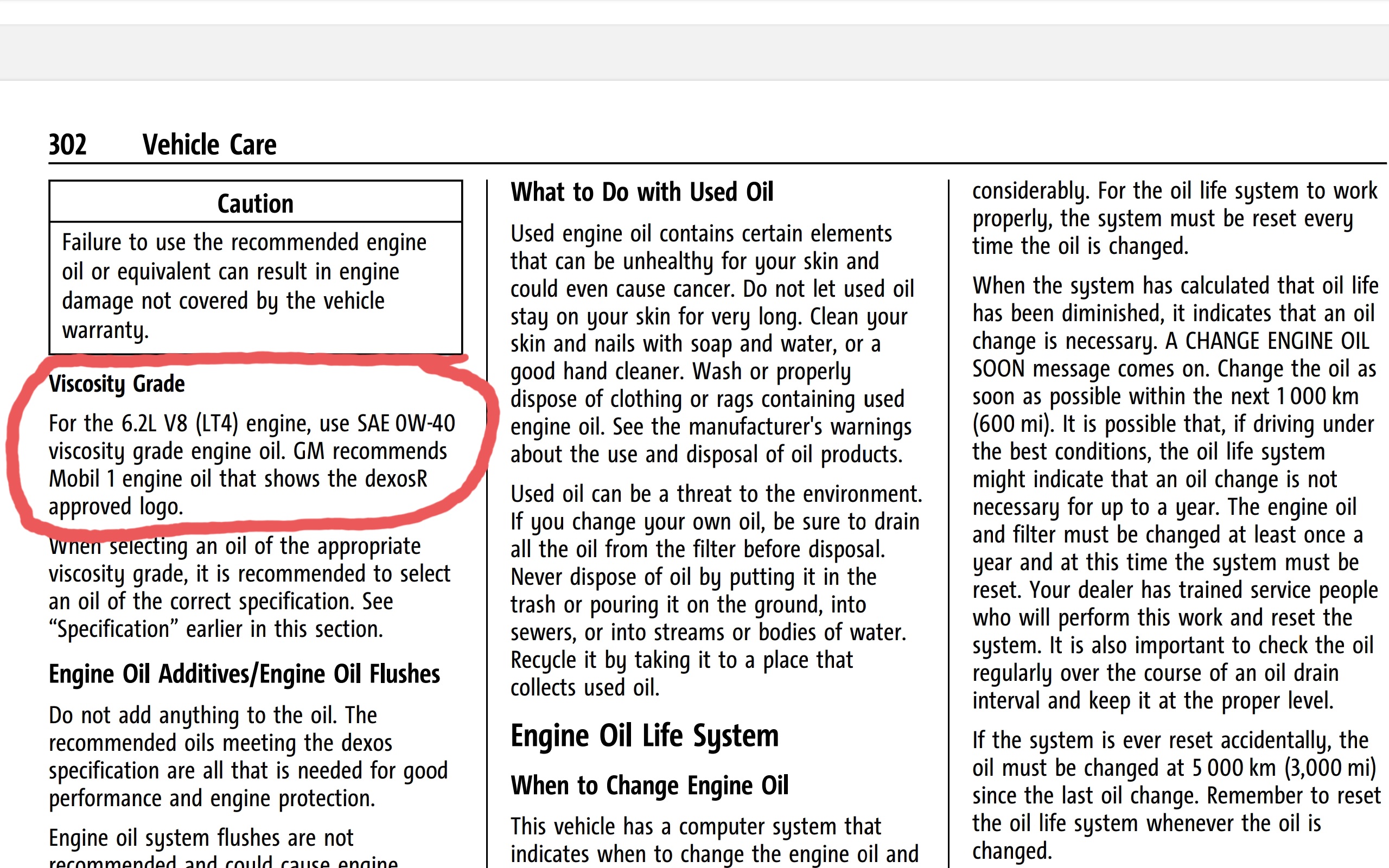

Just spent 30 mins searching what oil I could buy locally, looks like Mobil 1 European 0w40, but not sure if that is dexos ii rated, mobil website is clear as mud 😤
I just ended up ordering the super car 0W-40 from Walmart and it'll be here Thursday, nobody nearby had this formula and the European stuff didn't seem to meet the proper standard.

This has been discussed before, but isn't "Euro" the wrong stuff? I know they changed the name, only adding to all the confusion, but I thought it was "ESP", later changed to "Supercar"? It has to have "Dexos" on the label.
Yes, European is not dexos 2, but ESP or SuperCar, they need a new marketing team at Mobil

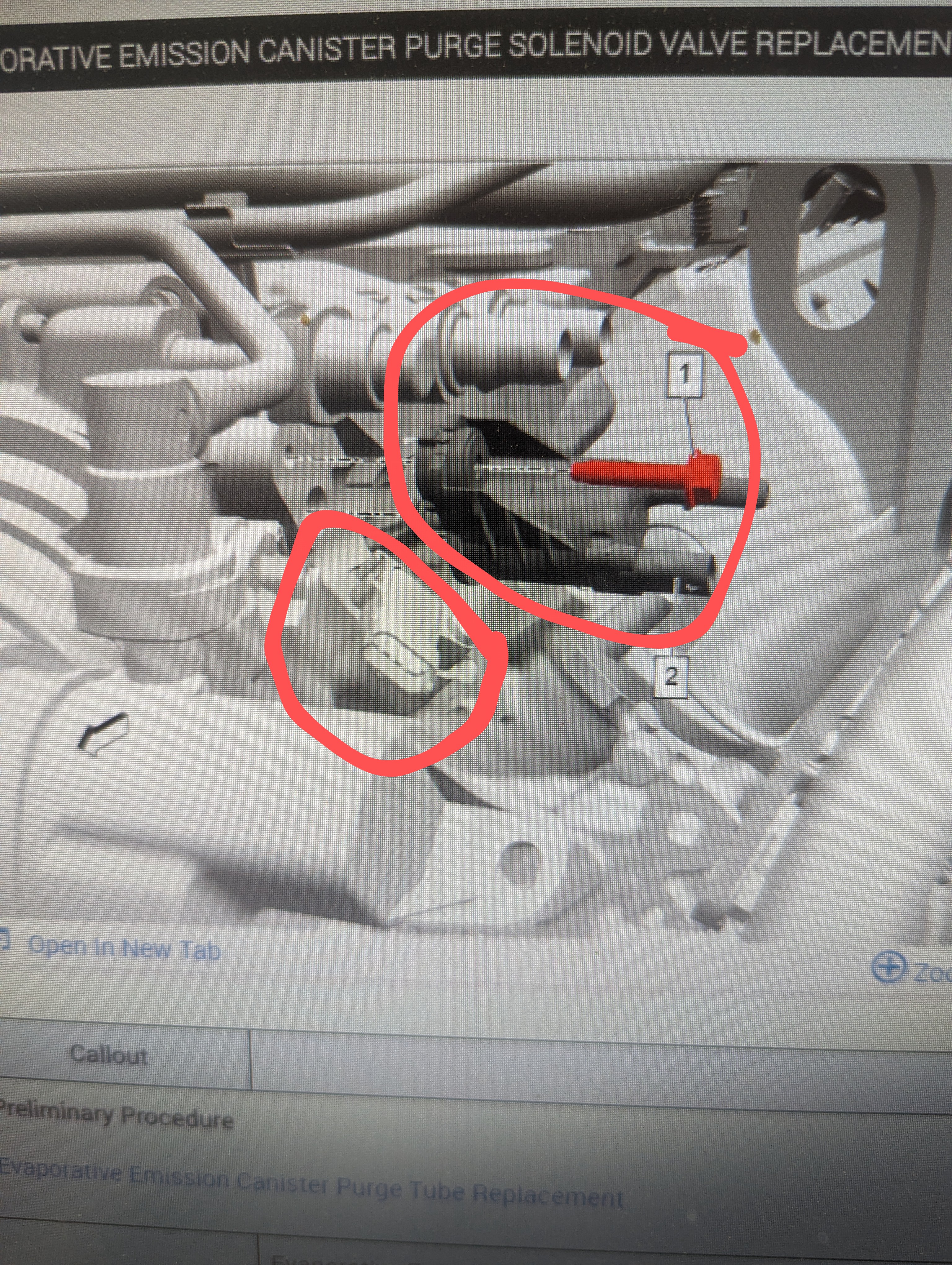

You sure it's not the evap purge regulator clicking? They are up by the throttlebody, will intermittently click at idle, and can be unnervingly loud.
Ah yes, I believe that you are correct, it is ESP. I just knew that I couldn't find it at a decent price, or in stock, at the usual places, so I ordered it through Amazon.
The evap purge regulator is literally next to the map sensor you took a picture of ..
It would definitely be a loud one, but it wouldn't surprise me. Next time it happens put your hand on it and see if it goes with the rhythm of the noise. It's the only thing that would be that intermittent in my mind.
Per Blackwing owners manual:
