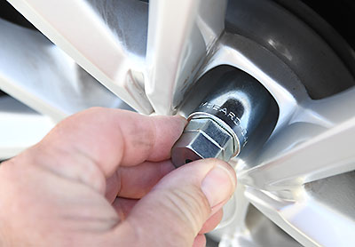

A set of McGard "Tuner" locks for ATS-V and CTS-V. Each set of McGards comes with four wheel locks and one lock key. Additional keys can be ordered from McGard. Ordering instructions are included with the locks. Image: Author.

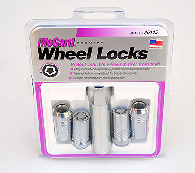

A set of McGard “Tuner” locks for ATS-V and CTS-V. Each set of McGards comes with four wheel locks and one lock key. Additional keys can be ordered from McGard. Ordering instructions are included with the locks. Image: Author.

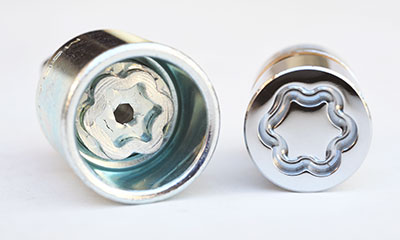

A standard McGard lock for the ATS-V and CTS-V along with it's key. Image: Author
A standard McGard lock for the ATS-V and CTS-V along with it’s key. Image: Author

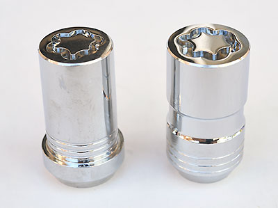

The two styles of locks available for ATS-V and CTS-V. The "Tuner" style (at left) is for some aftermarket wheels with small diameter wheel nut holes.
The two styles of locks available for ATS-V and CTS-V. The “Tuner” style (at left) is for some aftermarket wheels with small diameter wheel nut holes. Image: Author

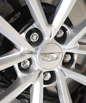

The McGard key is magnetic and "sticks" to the lock once the patterns engage. Image: Author
The McGard key is magnetic and “sticks” to the lock once the patterns engage. Image: Author

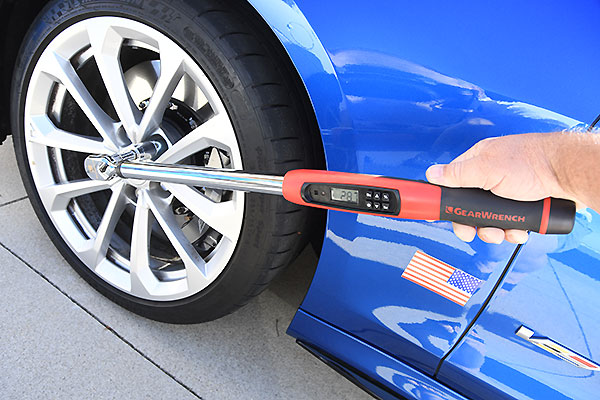

Like any wheel nut for an alumuinum wheel, the McGard locks must be tightened by increments in a star pattern. The "287" shown on our GearWrench Electronic Torque Wrench is actually 28.7 lbs/ft. We torque our 2016 ATS-V wheels nuts in either 3 or 4 passes depending on which wheel nuts are on the car. Image: Author
Like any wheel nut for an alumuinum wheel, the McGard locks must be tightened by increments in a star pattern. The “287” shown on our GearWrench Electronic Torque Wrench is actually 28.7 lbs/ft. We torque our 2016 ATS-V wheels nuts in either 3 or 4 passes depending on which wheel nuts are on the car. Image: Author
