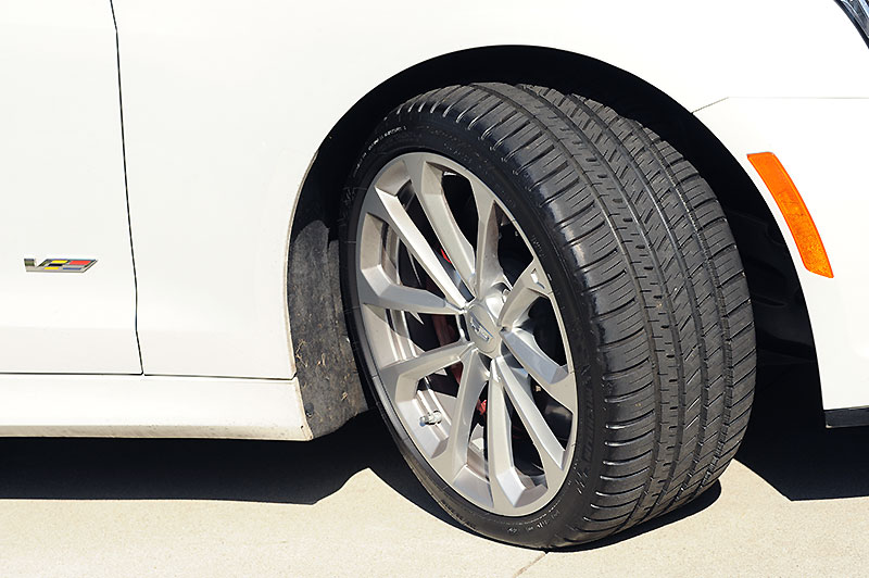

The Pilot Sport AS3+ has more and deeper tread grooves than does a Pilot Super Sport. That's one reason it works better in cold, wet weather. The other reason, which you can't see, is a computer-designed tread compound specific to the AS3+. Image: V-Net Staff.
The Pilot Sport AS3+ has more and deeper tread grooves than does a Pilot Super Sport. That’s one reason it works better in cold, wet weather. The other reason, which you can’t see, is a computer-designed tread compound specific to the AS3+. Image: V-Net Staff.

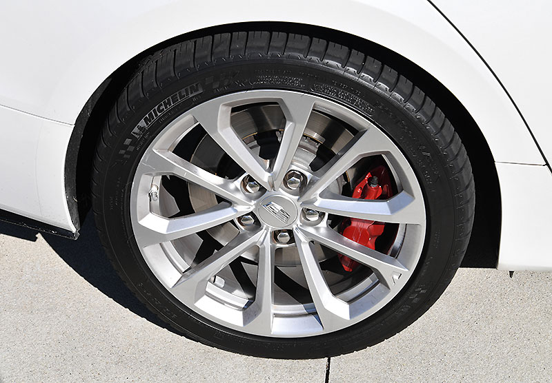

A PS AS3+ on the rear of our test car. Image: V-Net Staff.

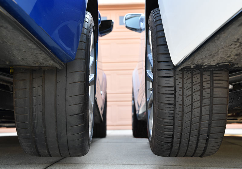

The Pilot Super Sport (left) and the Pilot Sport All-Season 3+. The two tires' similarities are noticeable. The PSS on the left, which is on our ATS-V manual Coupe, gets run pretty hard. The PS AS3+ on the right, is on our ATS-V automatic Sedan and doesn't get run quite as hard. Plus it gets driven more in the winter. Image: V-Net staff.
The Pilot Super Sport (left) and the Pilot Sport All-Season 3+. The two tires’ similarities are noticeable. The PSS on the left, which is on our ATS-V manual Coupe, gets run pretty hard. The PS AS3+ on the right, is on our ATS-V automatic Sedan and doesn’t get run quite as hard. Plus it gets driven more in the winter. Image: V-Net staff.
