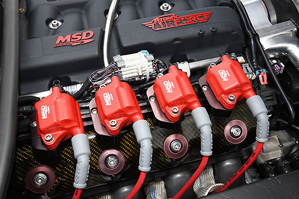

The MSD Pro Power coils are unique in that they are “multiple sparking” up to about 3000-RPM. Similar in concept to the company’s “multiple spark discharge” (now you know where “MSD” comes from) CD ignition amplifiers, these coils actually spark several times as the engine runs at low-end and low-mid-range RPM. The advantage of multiple sparks can be improved idle stability and low speed operation of engines having radical aftermarket cams or even LS7s with stock cams. How does MSD accomplish a multiple sparking, inductive ignition coil? The specifics are proprietary. All we know is that, inside each coil, is a printed circuit board which contains the necessary electronics to generate multiple sparks.
MSD Pro Power Coil
One Pro Power coil (PN 8287) fits 2006-2015 CTS-Vs with either the LS2 or the LSA engine. The V-Net’s sister web site, Corvette Action Center, has been testing a set of these coils on a Corvette ZO6 with a modified, 600-hp engine since early 2014. These coils are available individually or in sets of eight (PN 82878). Their maximum potential is 40,000 volts and they have a peak current output of 124-milliamps. For comparison, the stock GM coil used on an LS2 or LSA in a CTS-V can put out 38,000V and a peak current of 108-mA. The CAC has been using them along with MSD Super Conductor plug wires and Denso Iridium Power IT-22 plugs gapped at .055-in. The more powerful coils and plug wires with lower resistance may allow one to open up the plug gaps by an additional .010-in.

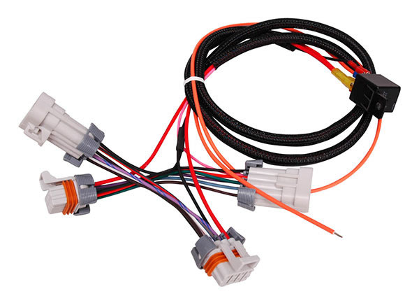

To get the best results out of any of the MSD coils for LS engines, the company recommends the 12V power feeds to the coils be at least 16-ga wire which is, nominally, 0.051-in. or 1.29-mm. in diameter. Because most OE coil wiring harnesses have 20-ga. (0.32-in/0.81-mm) power feeds to the coils, in most applications MSD’s “LS Coil Upgrade Harness” (PN 88867) is suggested. This wiring harness upgrades the coil power feed wires from 20-ga to 14-ga. The LS Upgrade Harness is “plug-and-play” and connects the stock coil power feeds to a relay. When the ignition is turned on, the relay closes and connects battery voltage to the coils through 14-ga (064-in/1.63-mm) wire. This harness prevents any problems with low voltage to the ignition coils which sometimes cause ECM fault codes to set.

The stock LS2 and LSA coil on the engine in a CTS-V is pretty darn good. Any stock engine or even those with mild modifications, will run ok with OE coils. Where MSD multiple sparking coils might be an advantage is on an engine with an aftermarket cam which is misfiring at idle due to a profile with increased overlap and, for whatever reasons, the user wants the idle to be more smooth. Where these coils really shine is on a modified engine which makes a lot more cylinder pressure such as a high-boost-modified supercharged application or an engine running nitrous oxide injection. In those two situations, the MSD coil’s higher output voltage and current could be an advantage.
The installation of the MSD coils and the Coil Upgrade Harness is simple, can be accomplished with basic tools and takes a few hours. If there’s a downside with an MSD coil installation, if you do it on a stock engine, the Corvette “beauty covers” will not fit over the rocker covers. While that was not an issue with our car, for those having stock rocker covers along with concern for ascetics, it might be a problem.
At this writing, the Corvette Action Center has put 50,635 miles in five years on its set of Pro Power coils and they’ve been trouble-free in all kinds of use: normal street/highway driving, really hard runs over favorite twisty roads and a bunch of chassis dyno runs. They work as well today as they did when they were installed back in January of 2014.
