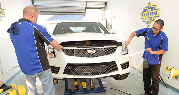

Xpel-trained installers, Bill DeBever (left) and Jesus Dominguez. hang the largest piece of the Xpel Ultimate "bumper kit" on the V-Net's ATS-V project. This part of the installation requires two people. Image: Author.

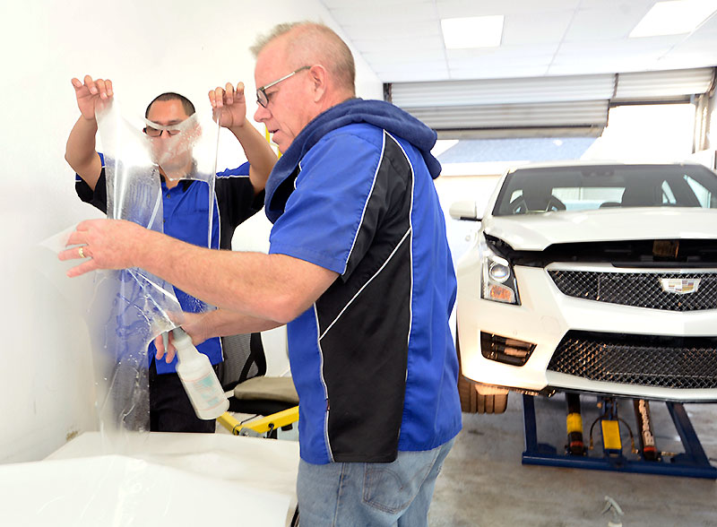

Large sections of film, typical of most cars' and trucks' front end kits require two people for installation. Shown here, Is Bill DeBever (right) applying the Xpel "secret sauce" which makes repositioning the film during installation possible. Knowing how to mix it and how much to use is one of the "tricks" Xpel factory-trained installers learn. Image: Author.

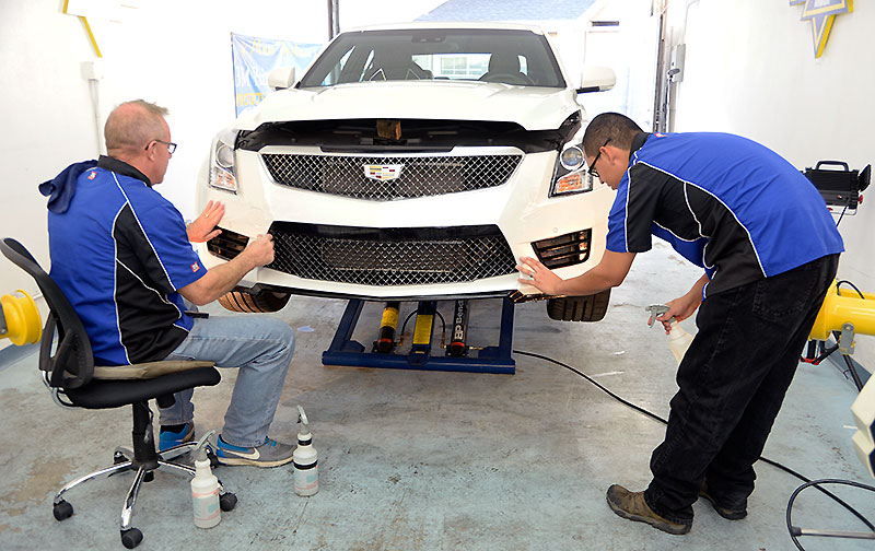

One of the reasons an Xpel installation, such as what we did with our ATS-V, takes so long is the time consuming nature of applying large sections of film, getting it positioned properly, then making sure any air between the film and the exterior surface of the car is removed. Image: Author.

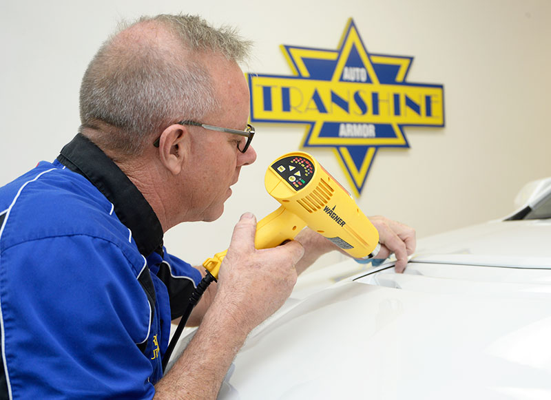

Another skill Xpel installers learn during factory training is when and how to use a heat gun to enhance the film's time to cure. Image: Author.

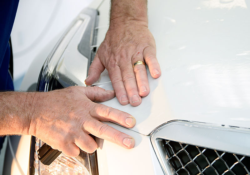

The V-Net's ATS-V has a partial Xpel Ultimate hood kit installed. The edge of the film, is visible, but you have to know where to look. Image: Author.
