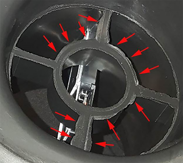

Inspect for cast flashing in the air filter housing near the Mass Air Flow (MAF) sensor for excessive flashing. (Fig. 11) If excessive flashing is found, replace the air filter housing lid. Be sure to check the flashing in the new lid as well.
Fig. 11
