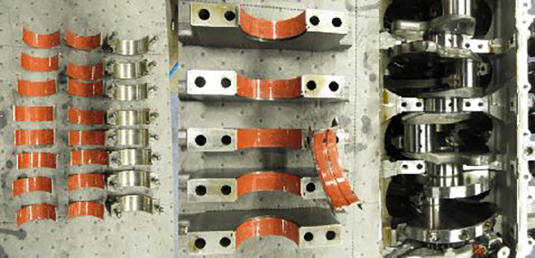

If end play is found to be out of specification, remove the engine and check for possible crankshaft thrust bearing or crankshaft wear. The crankshaft and bearings should not show signs of excessive wear. (Fig. 10) Inspect the thrust bearing for wear on one side and the crankshaft on the mating surface.
2015 - 2018 Cadillac CTS-V:  GM TechLink:  Hard Shifting into 1st Gear or Reverse
Fig. 10
If wear is evident — the three vertical channels may be worn off — replace the connecting rods, main bearings, thrust bearing and crankshaft.

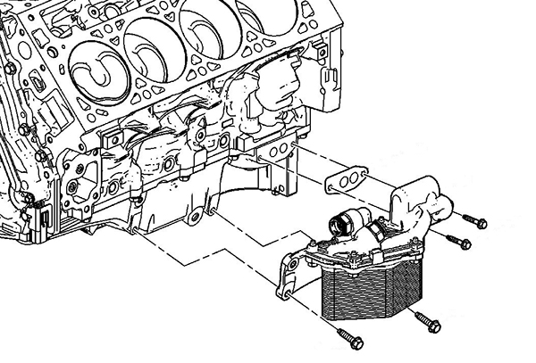

TIP: On engines with a dry sump oil system, the oil tank and lines, and the oil cooler (if equipped) (Fig. 11), should be replaced when repairing the engine.
