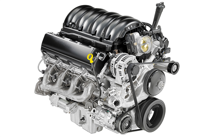

The vibration may be due to an overfilled engine crankcase on the following engines: 4.3L V6 (RPO LV1, LV3); 5.3L V8 (RPO L82, L83, L84); 6.2L V8 (RPOs LT1, LT4, L86, L87). (Fig. 11) It may be found that the engine oil was recently changed.

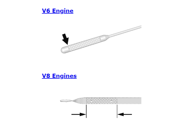

If there is an engine vibration concern, check the engine oil level. Refer to the vehicle’s Owner’s Manual for details on correctly checking the engine oil level (Fig. 12) and the engine oil crankcase capacity.
