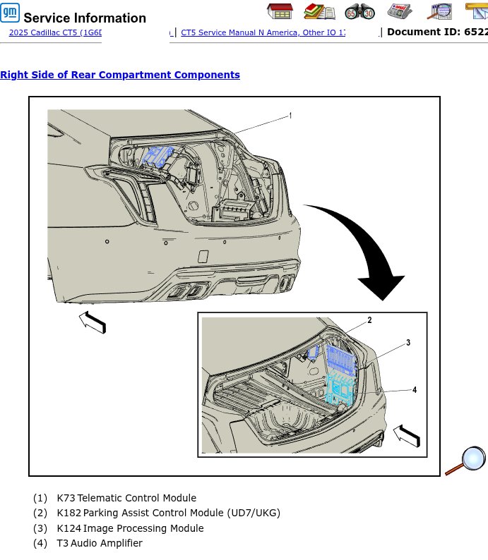

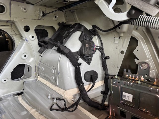

I paid for a 3-day subscription to the service manual to answer this and some other questions. It says the K73 module is in the right side rear compartment (trunk). There's a bracket for it but it's not there!
It's not in the left side either. (I'm guessing they moved it to the glovebox area like the CTS.)

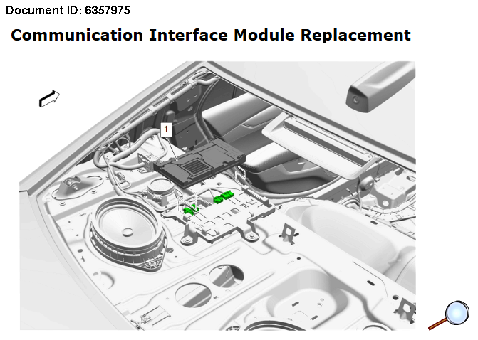

I got a reply to my feedback:
The K73 module has swapped locations with the K124. For MY25/26 it is now located in the passenger compartment, at the rear shelf, under the trim. Updating SI is underway.
