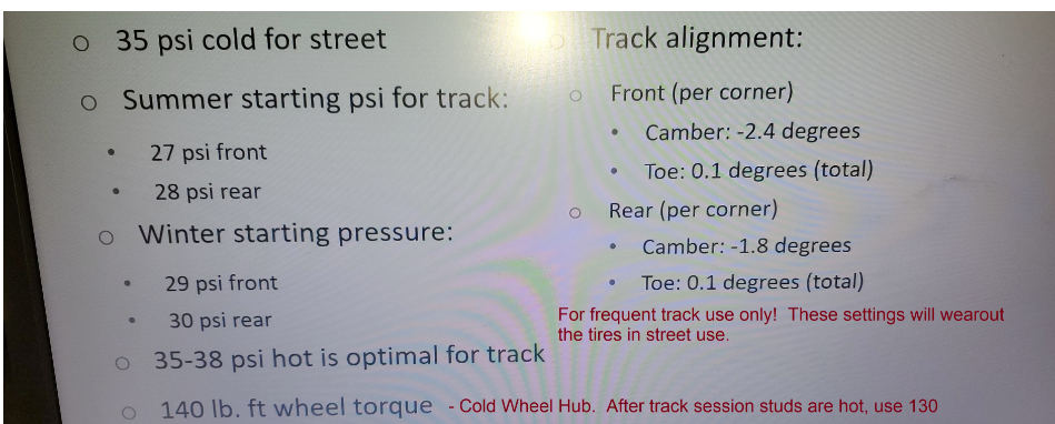

I tried out the launch control the other day on my 4BW 6M and was getting really bad wheel hop.  It was a typical New England fall day: dry as a bone and sunny with temps in the mid-40s.  My tire pressures were 35 all around, slightly warmed up to about 36 psi per the dash indicator, and I'm running the factory tires with about 7,600 miles on them.  I note the conditions because it's not like these are brand new tires or I had them underpressured.  I was in competitive driving mode, so no PTM mode, with launch control set to automatic.  Note that I don't have the steering wheel PTM switch, so from my experience, I can only access PTM modes in track mode.
