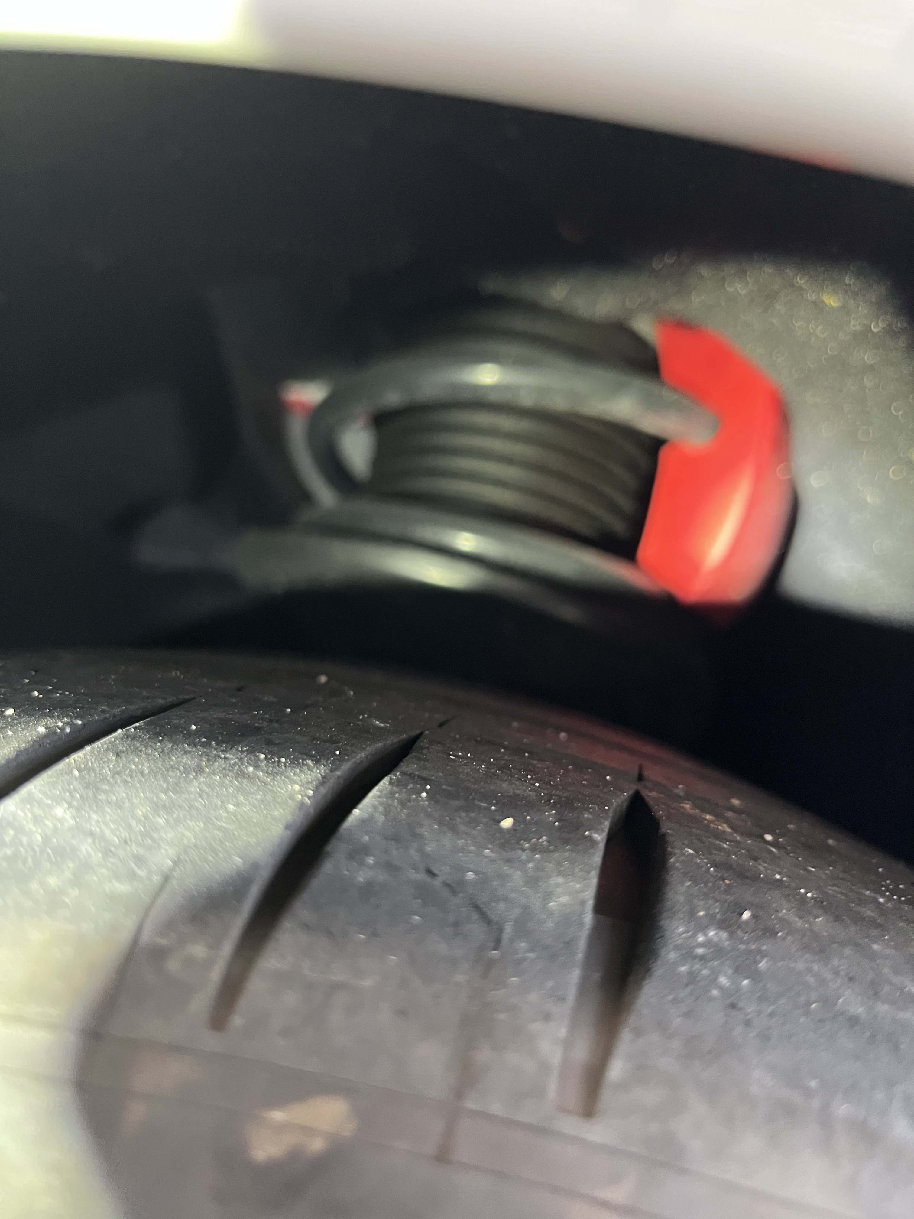

Good Morning, I’m getting an alignment this morning and saw this red block in the front coil springs, should it be there ? Thanks
That should be there for transit while on a flatbed/trailer/etc. Not to be used while driving. Your selling dealer should have known to remove them during initial inspection.
