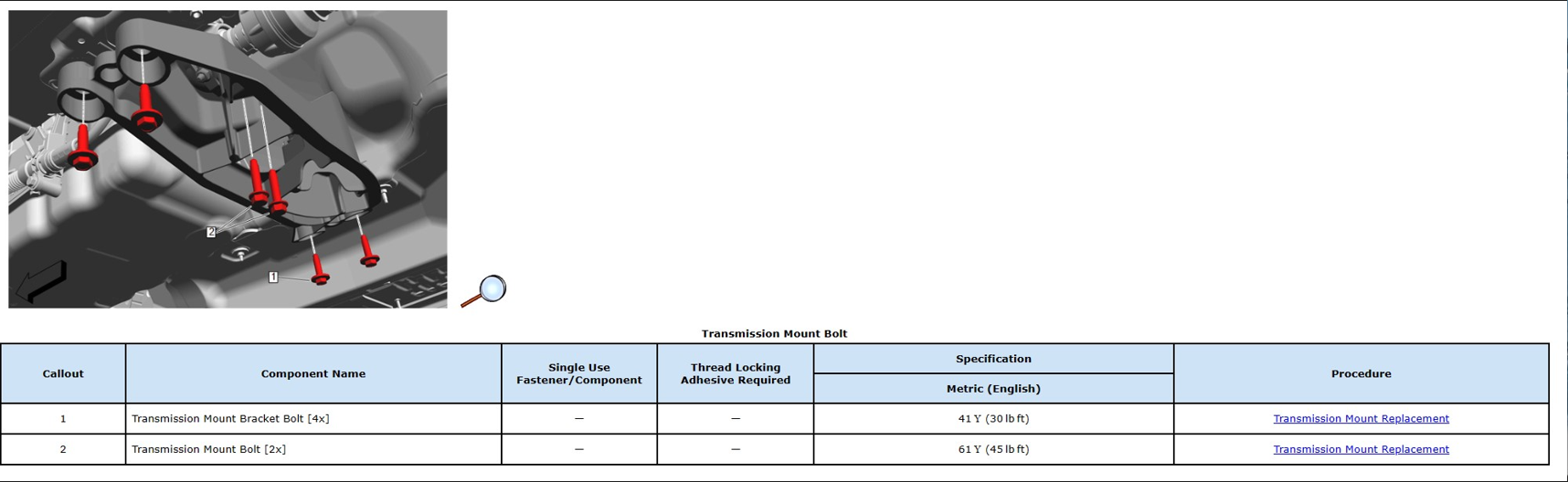

What are the torque values for the bolts for the transmission cross member?
I'm going to swap out the trans fluid in my 2023 4BW to Amsoil Torquedrive in an effort to improve shifting. As you all probably know, the drain plug is right above the transmission cross member. While it is possible to drain it with a swivel extension, it would be 10x easier and cleaner without the transmission support in the way. Of course I plan on supporting the trans with a jack before I remove the support.
TIA.
I can't post the picture, but the 4 bracket bolts are 30 lb ft and 2 trans mount bolts are 45 lb ft.
