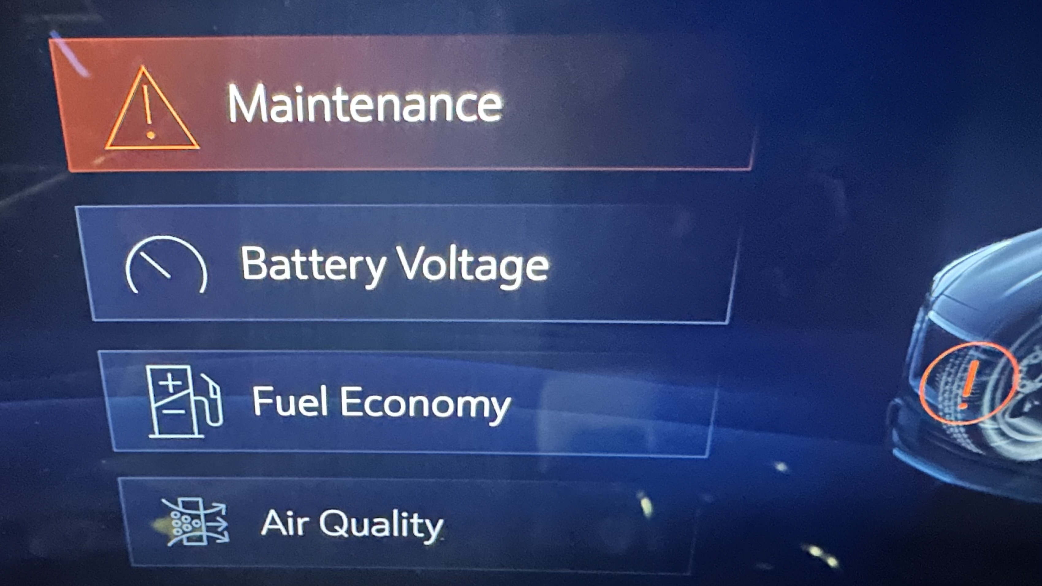

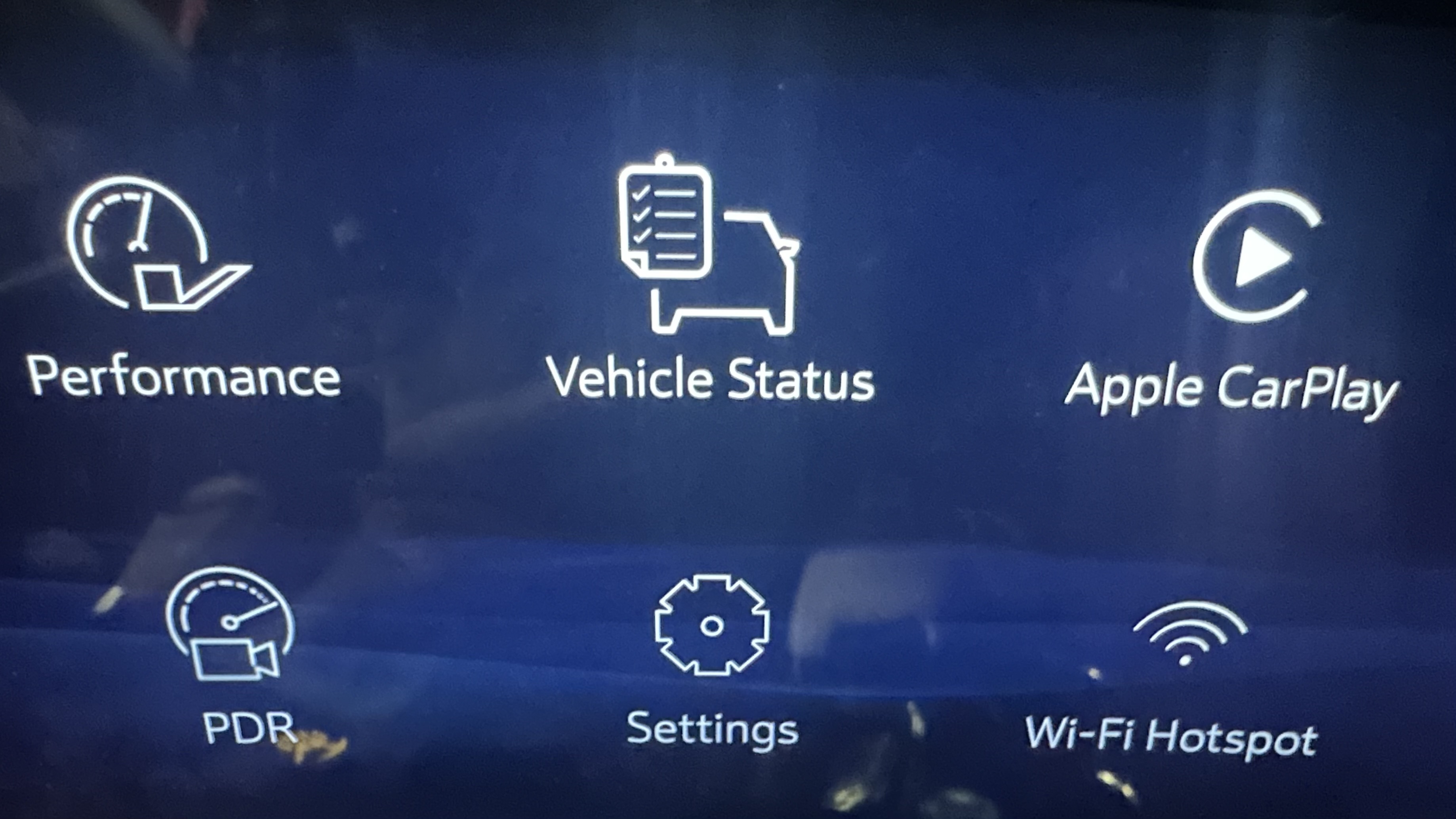

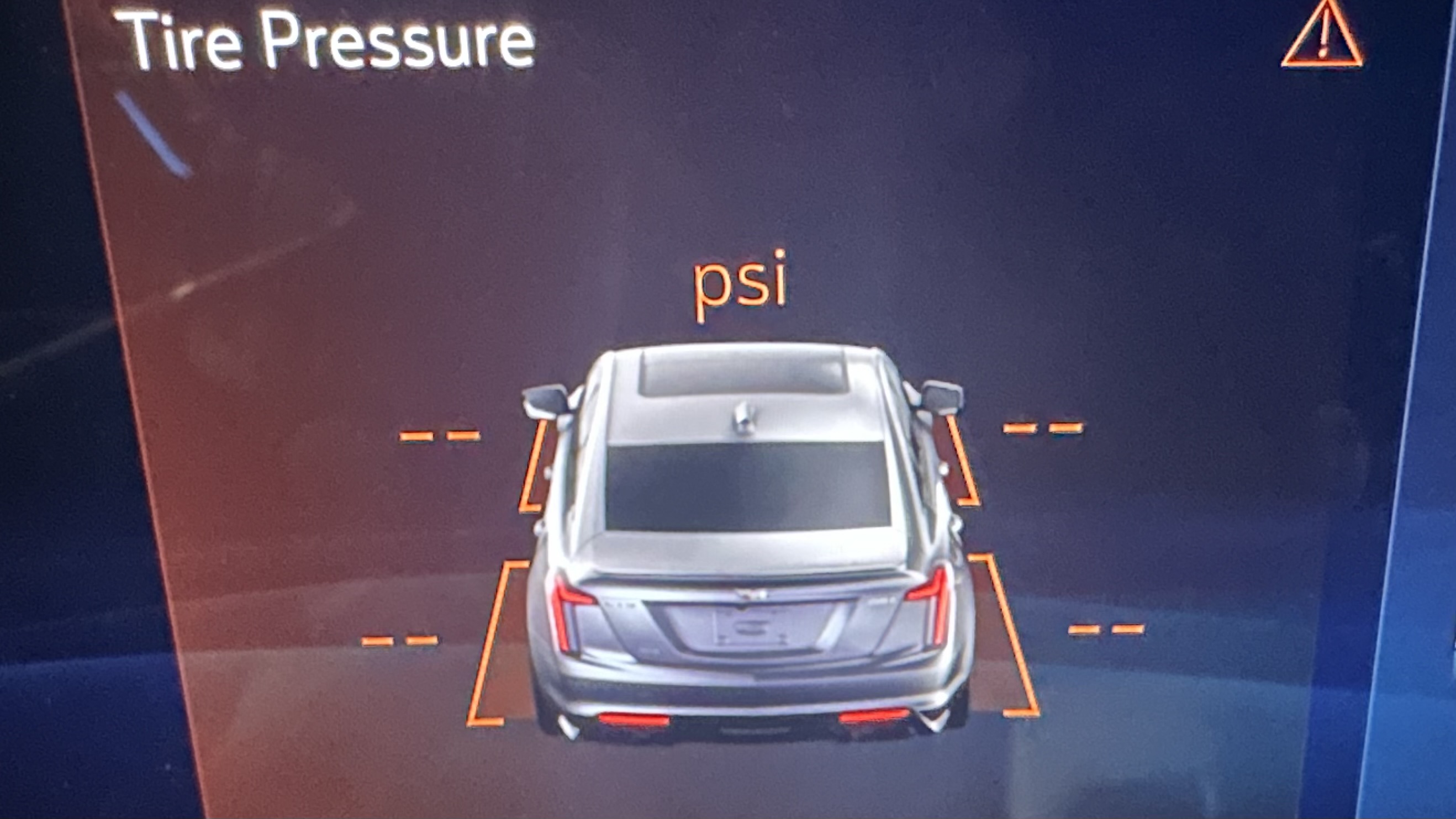

Thanks to julian26 for pointing out how to get to the relearn process on a 2025+. I took some pics of the screens.
1. tap Vehicle Status
2. tap Maintenance
3. tap the Tire Pressure infographic
4. tap Relearn button
Then follow the process julian26 outlined above - LF, RF, RR, LR. Wait for a honk at each tire to confirm. I have the reset tool, but if not use the deflate procedure to activate the sensors.
