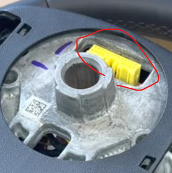

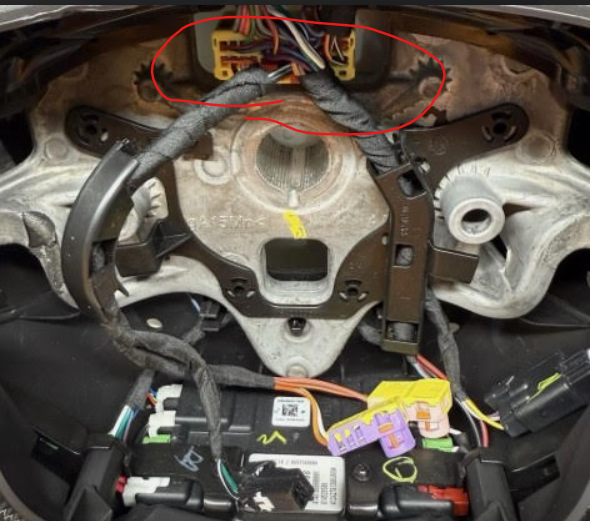

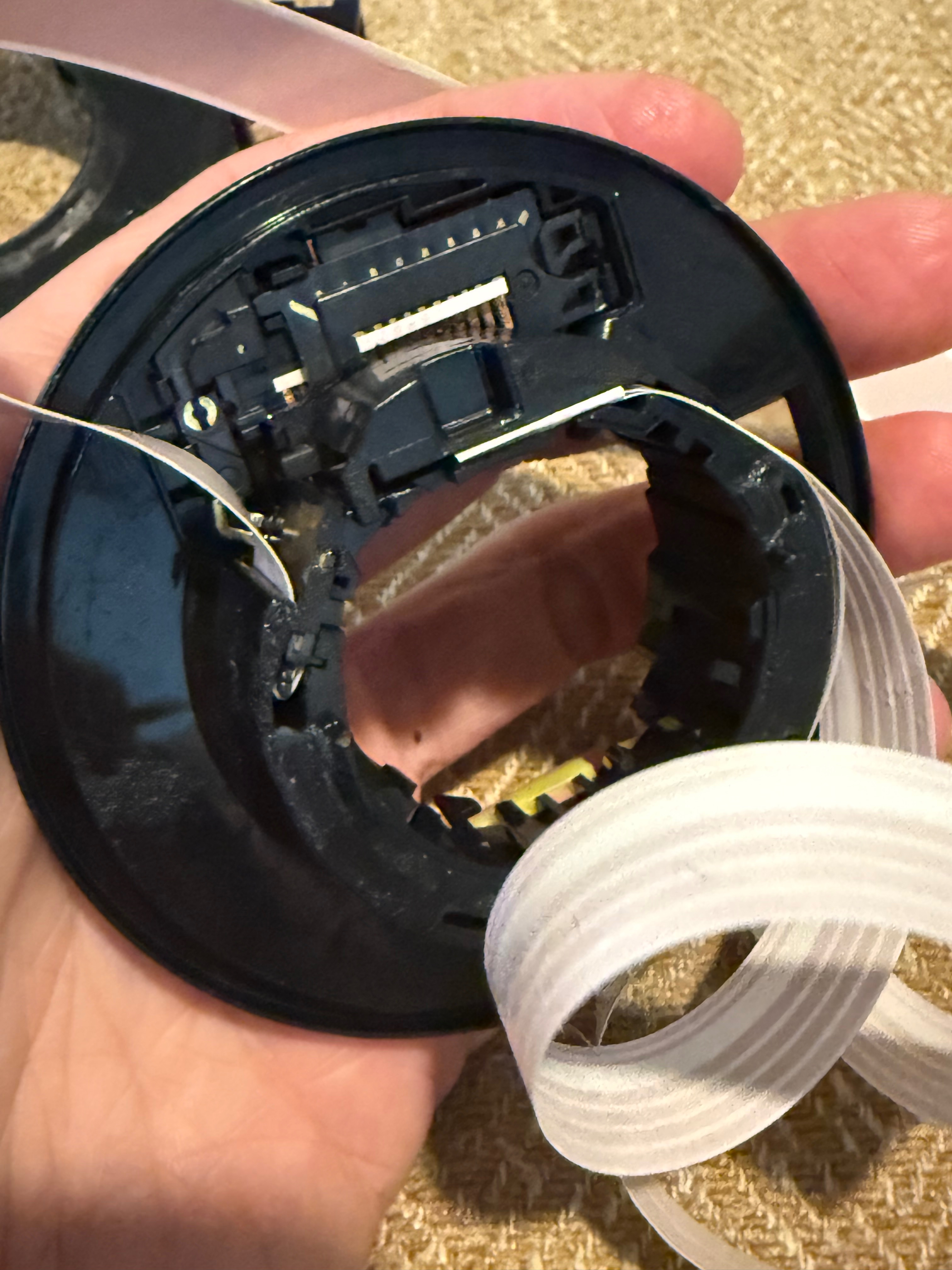

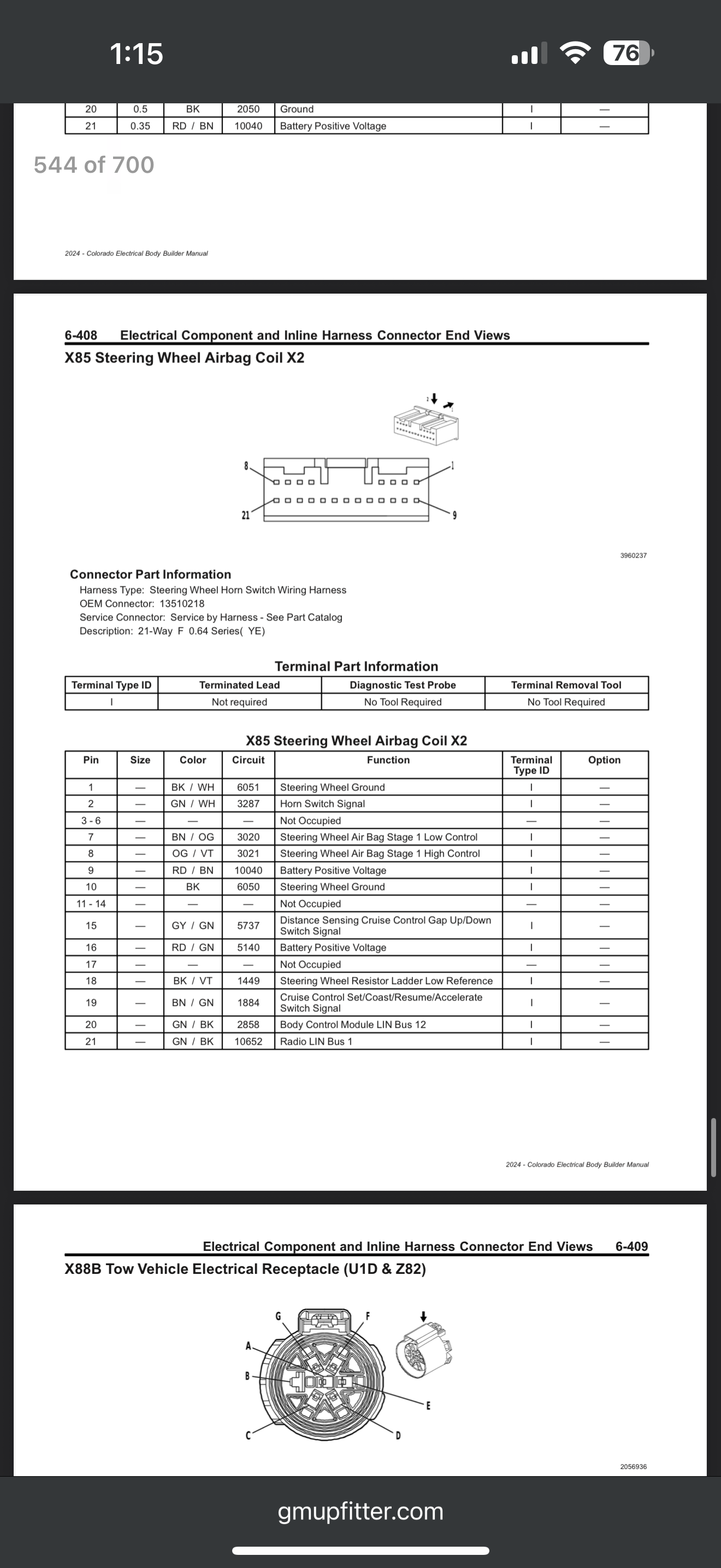

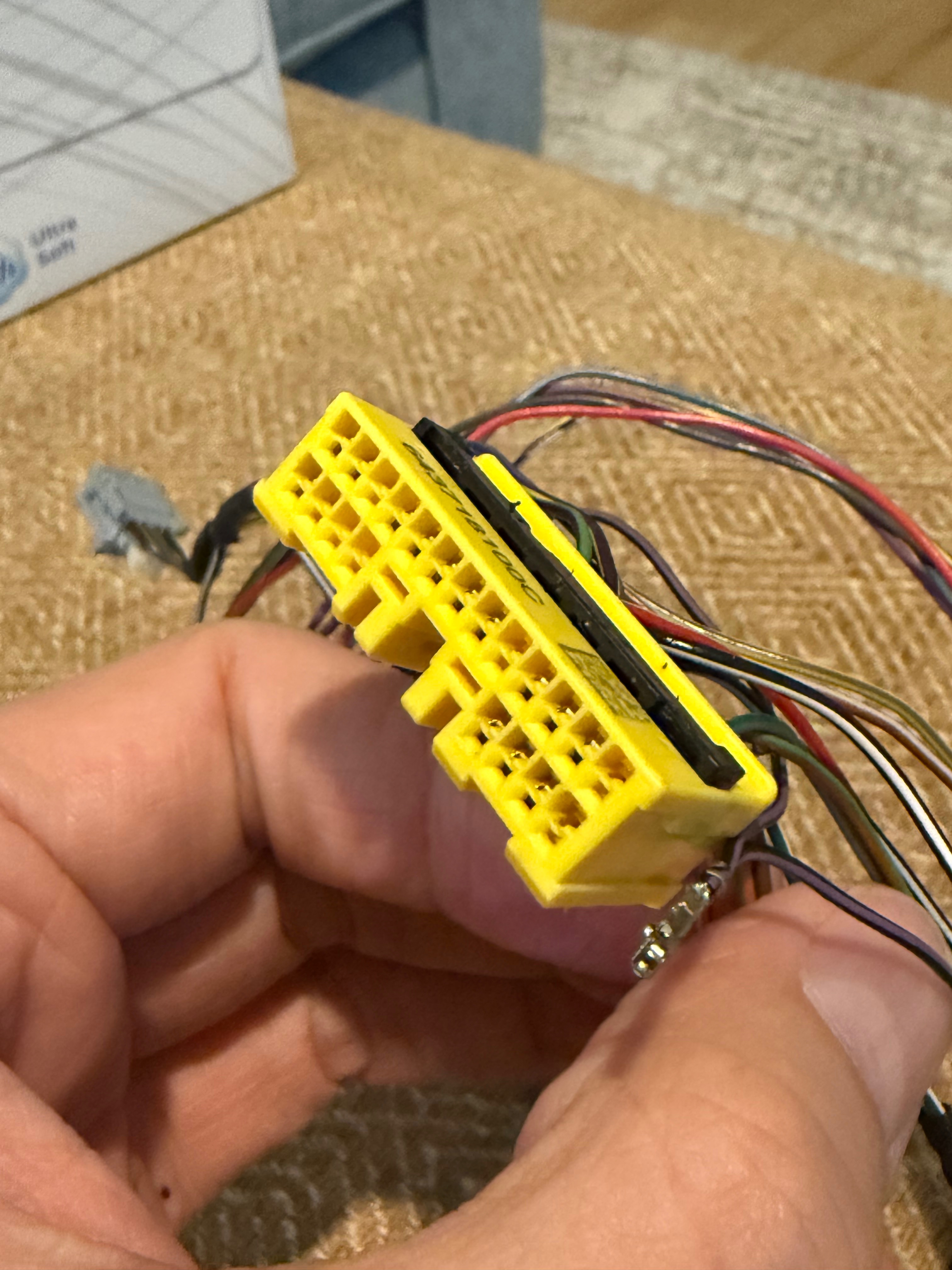

Thanks for the reply! Agreed their design looks great. Honestly someone with some CAD and fabrication experience I’m sure could figure out the physical spacer. What also would be needed is likely a jumper harness or something for the wiring.
For the price, I would be tempted to buy the C6 one and try to see if it fits. If not, find someone local to modify it accordingly and go from there.
Thought about it, it’s just at least a decade different in design so figured a long shot. If they had a Camaro version I’d 100% agree worth a shot. Anyone whose put on an aftermarket steering wheel have the oem to take some measurements and spline count?
