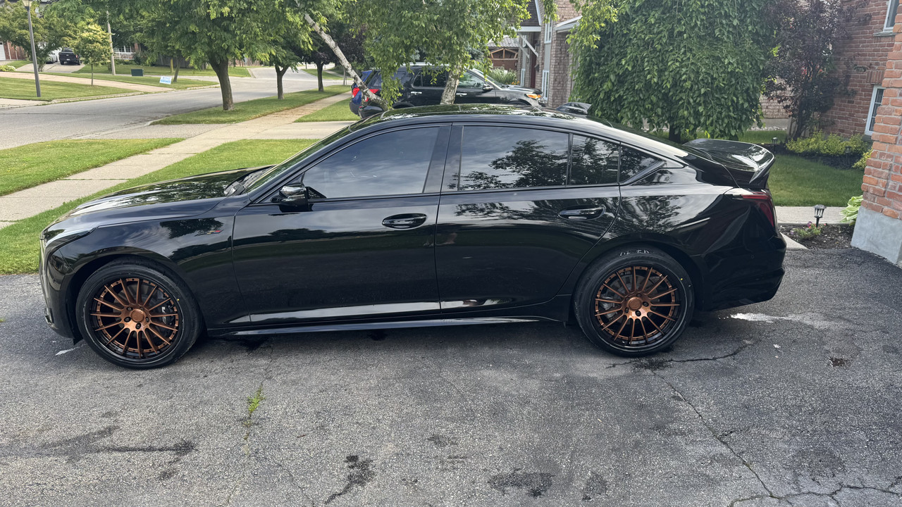

Needed something to break up the black, Barrel forged Sentali br2 20x9 +35, 255/35 20, Indy 500 rubber. Package ends up 4lbs per corner lighter than the OEM 19" and srnflats and rides much better. this combination has the outer edge of the wheel pretty much where OEM was, i think it thends up .3" out more and .3" taller tire
OEM 19" and PS4 ZP combo came in at just shy of 62 lbs
