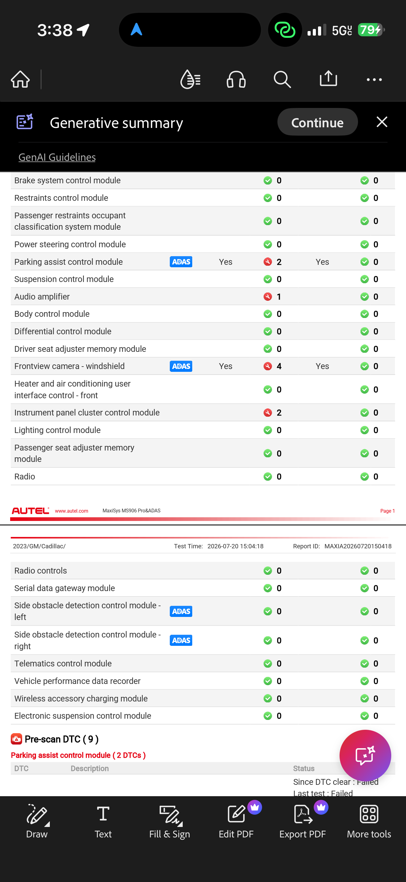

Well, I had the mobile service come out to program the seat belt auto tightening motors. Apparently my '24 showed up as not being equipped with this feature. There was nowhere to configure/program it. I don't know if they just didn't know where to find it or it was something I did during the install.....Not much you can do wrong there. There are no error lights on the dash or error codes in the system. It took me 9 months to realize I didn't have this feature until I read this post, now I am wondering whether I ever had it....
Here is the screen shot of the scan. I have a scan from another car with that feature and it is explicitly listed as front left and front right retractor motors as two separate lines. I also have a scan from another CT4BW and it looks just like mine, without programmable items for the front retractors. This leads me to believe they do not need to be programmed. Another member who swapped the belts said the motors just worked "as they should" when he installed them. So this must be some incompatibility with the bets I bought, though they should all be the same from 22 through at least 24 model years when they stopped making special editions with red belts.
