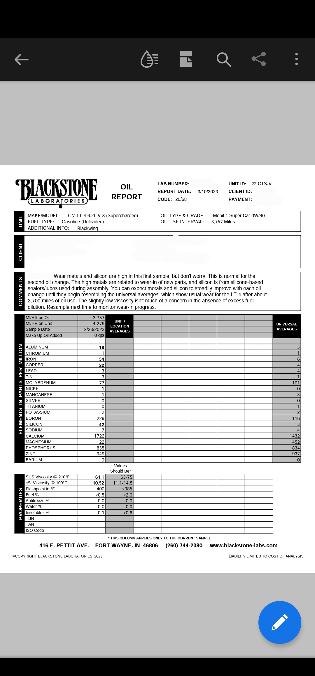

1st Oil change at 500 mi (mainly because the factory fill had been sitting in the engine for at least 10 months.; Lot of doom, sat at the dealer for however long before I got it).
2nd oil change at 4,279 mi
I'm no expert at reading these but this report didn't give me the warm and fuzzys. Considering the amount of wear particles and silicon sealers I'm glad I changed it early. I believe this should improve but others feel free to chime in. I'll continue to run these and post as mileage inceases.
I plan on sending them two virgin oil samples.

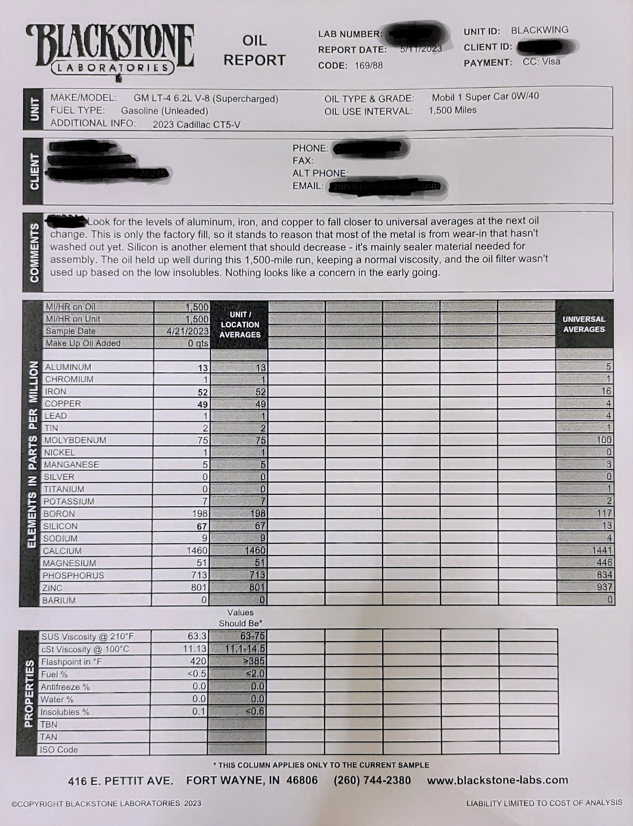

Here is my report from my 1,500 mile oil change. I did not change the filter at this time and plan to change the oil again at 5,000 miles or when the oil life meter tells me , whichever comes first.

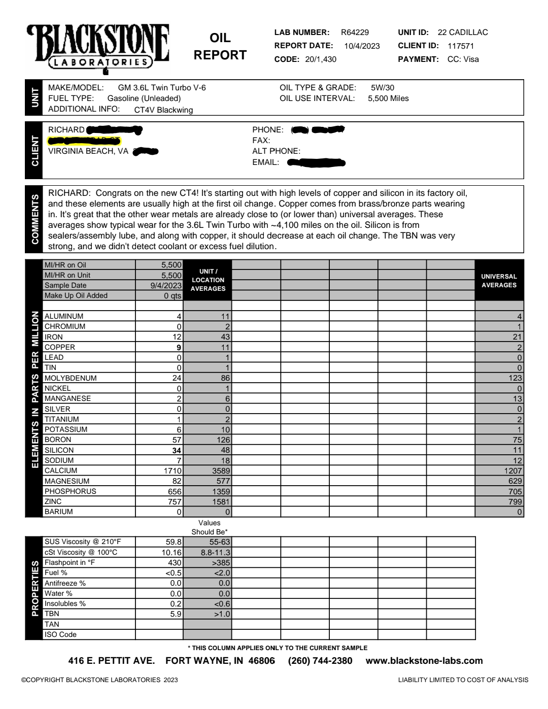

Not terrible for the factory oil. Dumped Amsoil in there, so will see what the numbers are in another 5k.
