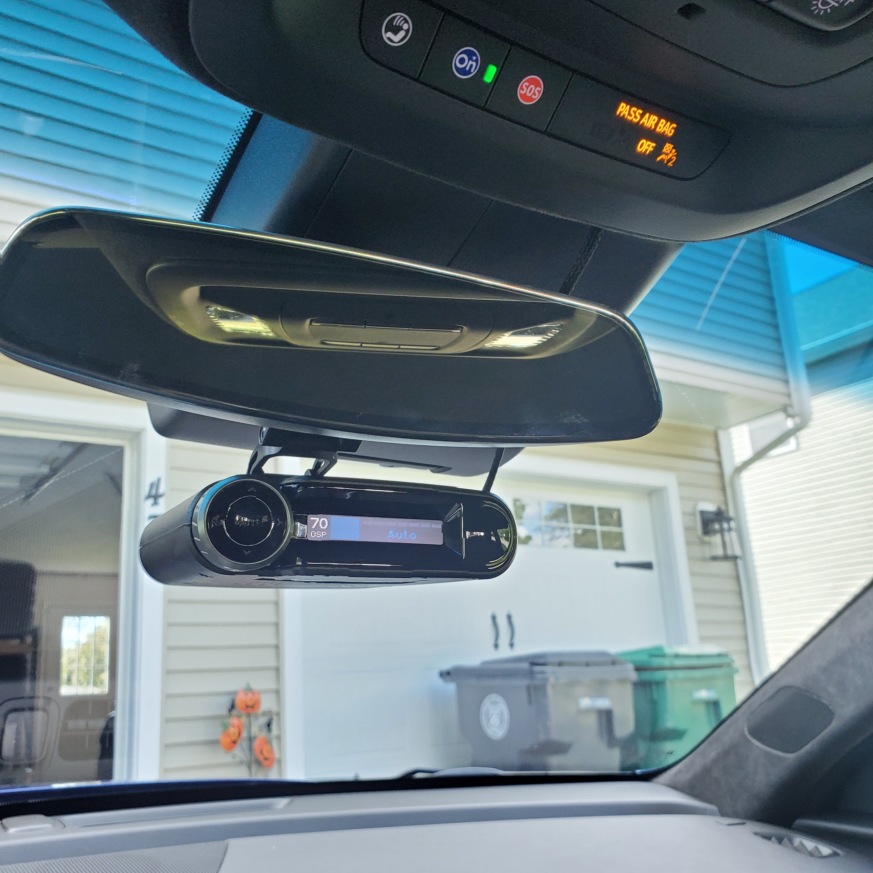

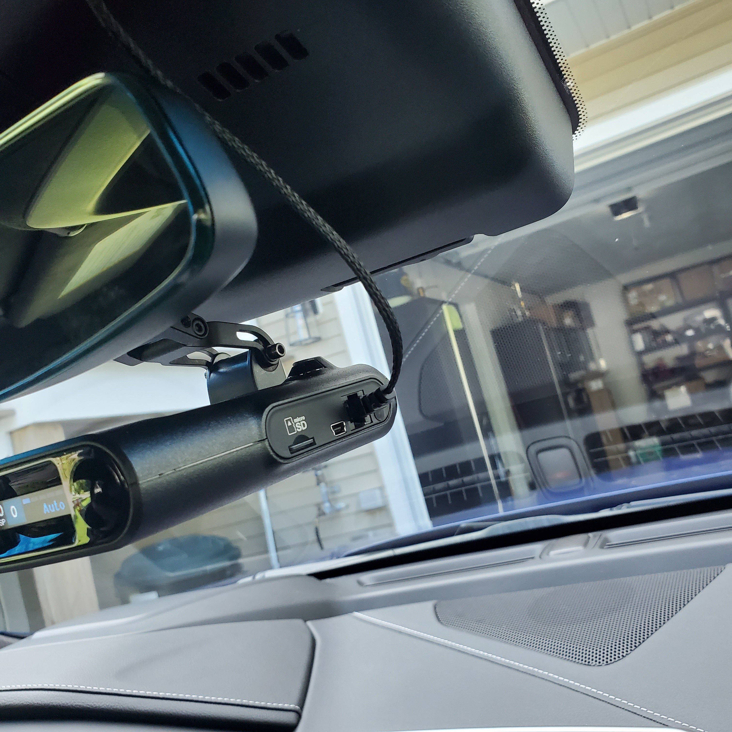

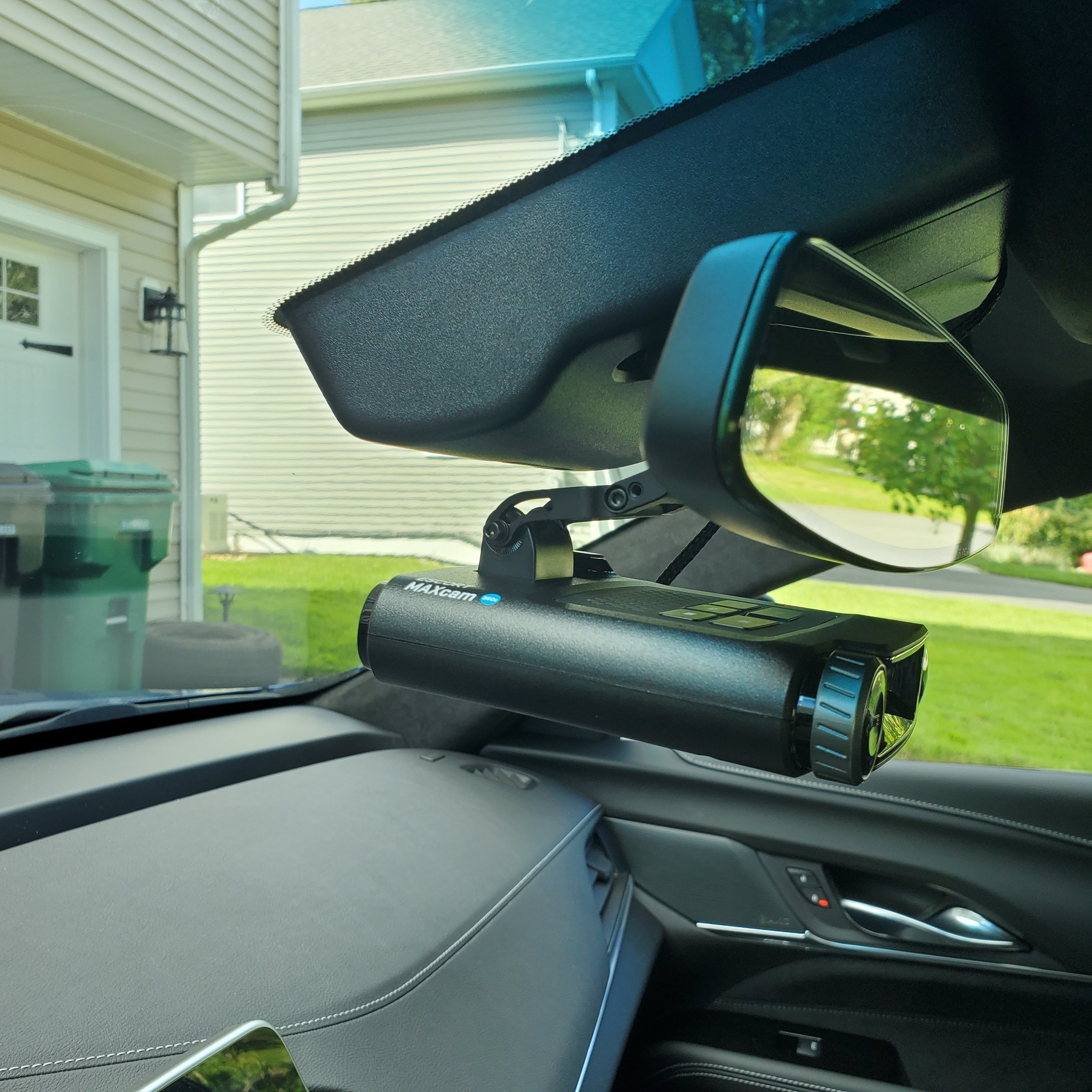

So I ordered a new escort max amount 360c radar detector, ordered mirror mount and hard wired to map light.
Perfect fit straight forward install,wires to tap into are red and black for power and ground.

Did you end up tapping something in the onstar area?
remove the plastic around the mirror and tap into the red and black wire going to the map light,this radar has a built in camera that records live video when car is parked so the powers needs to stay on when the car is turned off.
