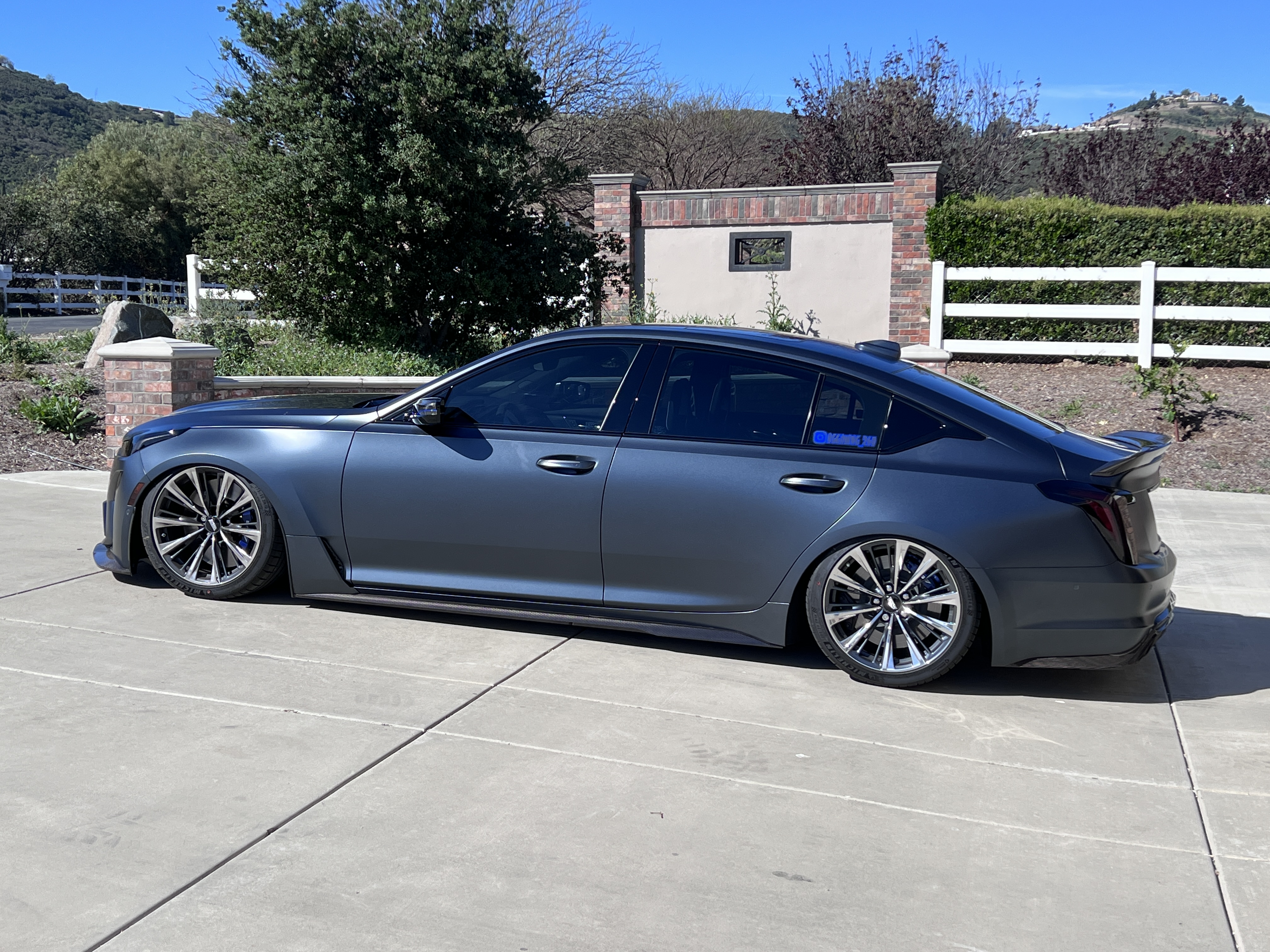

currently air bags might be your only option for a few more months....thats what I did. its 100% reversible so I can go to a lowering spring and full BMR rear links later.
