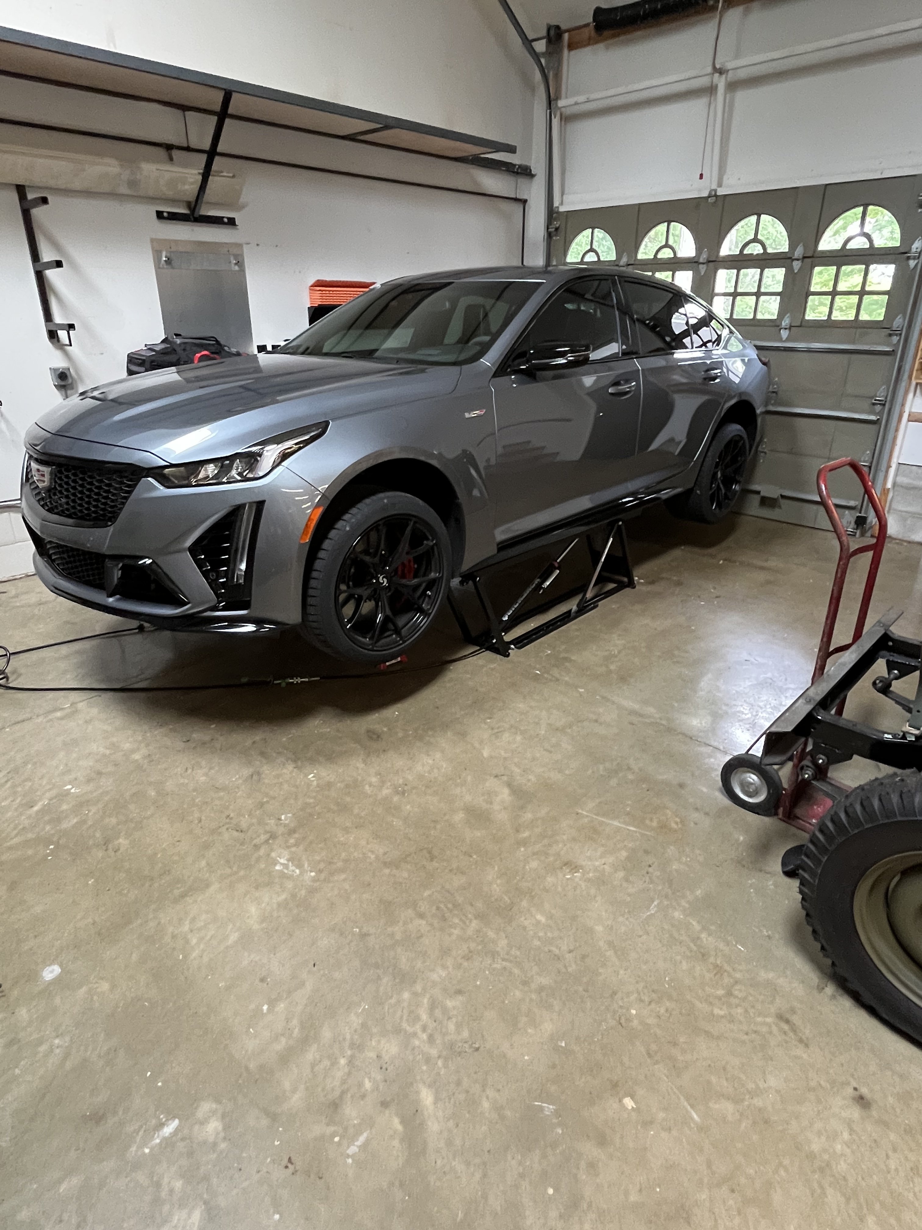

Any chance anyone has pics of their BW4 or BW5 while on a QuickJack? If so, please indicate what model QuickJack you have. Thanks!

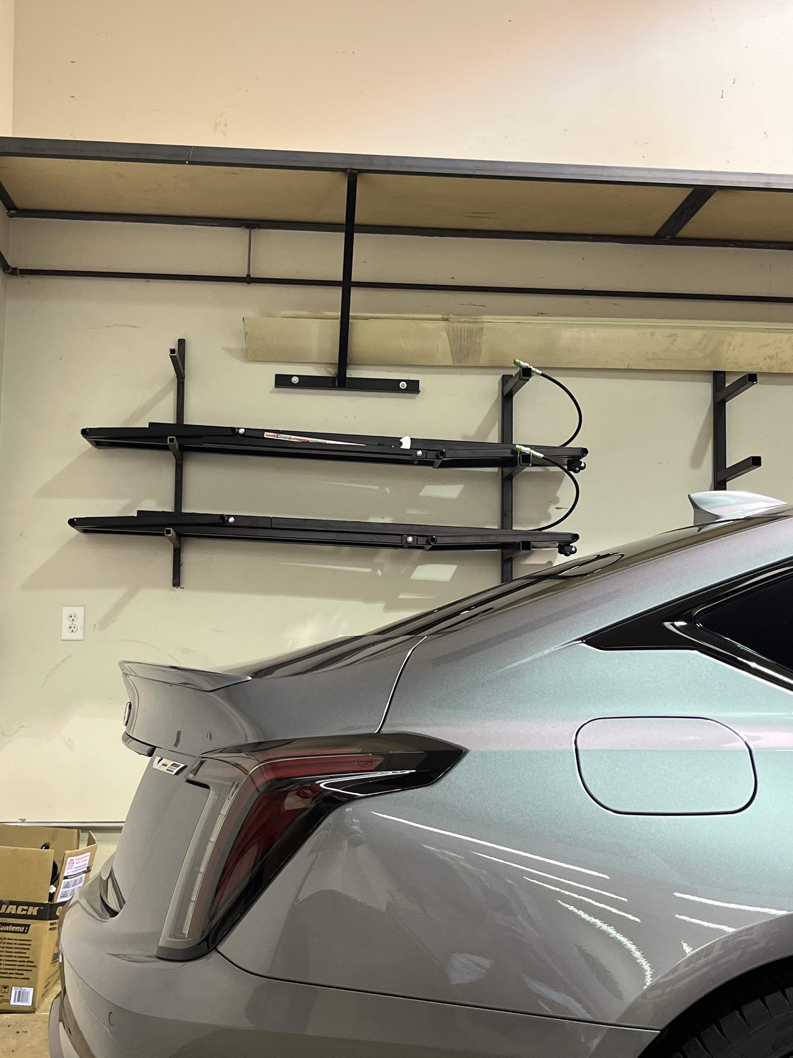

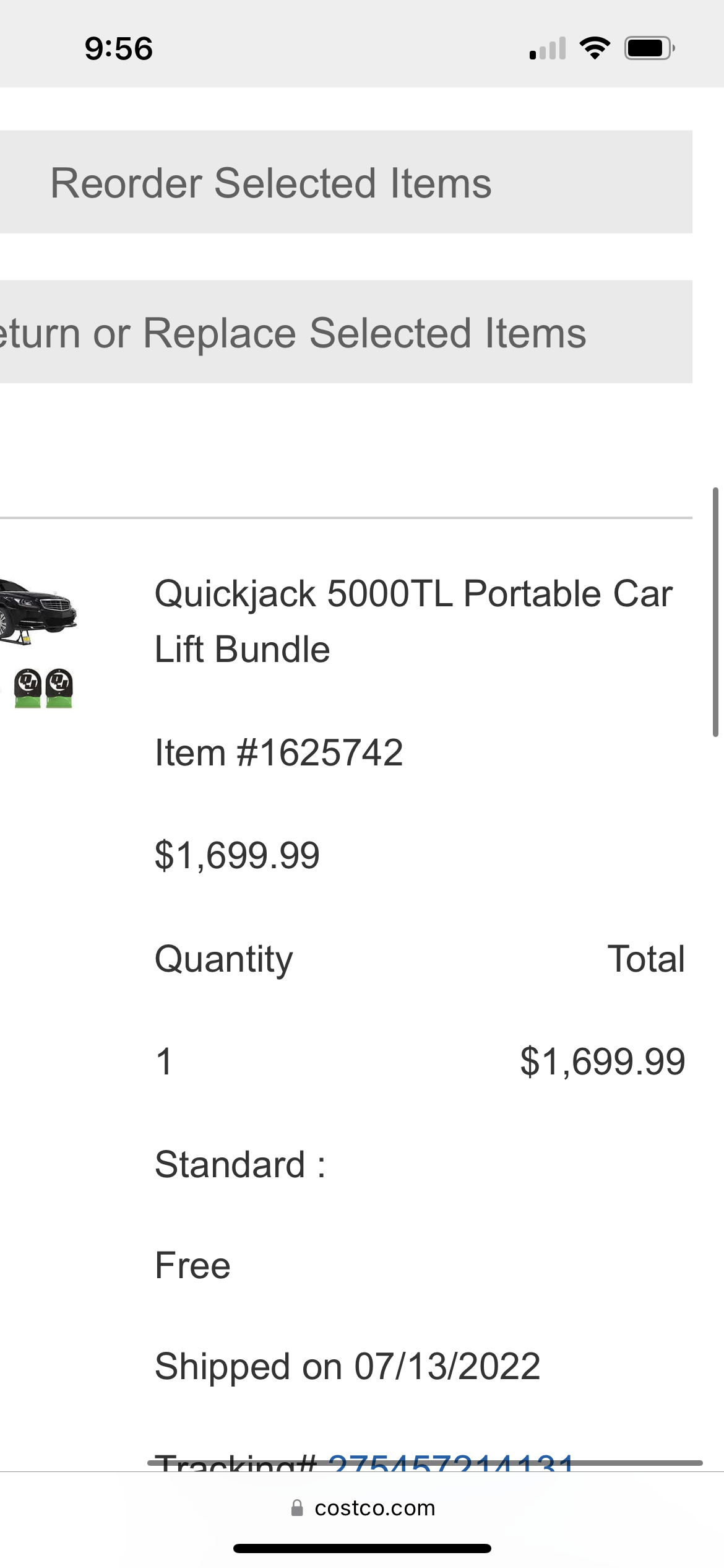

i use the 5000TL from costco. ill try and lift her up in the next day or two and send some pics.
