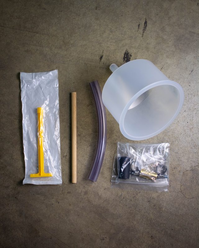

Okay, with that off my chest—I just finished bleeding the intercooler on my '23 CT5-V Blackwing. While there wasn’t a large amount of air in the system, there was still some. I used the Tapout Tuning Intercooler Fill/Bleed Kit:

The Tapout Tuning kit makes for much less mess in terms of coolant spillage. I didn’t replace part of the intercooler hose with the clear one that comes in the kit—it’s not needed. You can tell when the pump is running and easily see bubbles rising into the coolant in the funnel.
Unfortunately, on the Global B platform, there’s no way to run the pump with the engine off. On the ZL1, you can jump the pump relay. HP Tuners or a bidirectional code reader may be able to run the pump with the engine off, but I have no evidence to back this up. I just ran the engine for about four minutes each time while depressing the Schrader valve with the wooden dowel that came in the kit. I also squeezed the intercooler hose periodically to release bubbles. I did this about four times with 5–10-minute breaks in between, then I would take the car for a drive. I repeated this procedure over three days until I was satisfied I had removed most of the air.

I used the DMS adaptor when I bled my ZL1. It worked okay. I just didn't like the acrobatics you needed to go through to reduce the amount of coolant that gets spilled in the engine bay when you remove the adapter. The Tap Out Tuning kit has a plug for the funnel. There is much less mess and cleanup.
