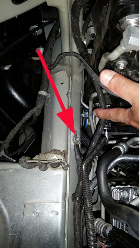

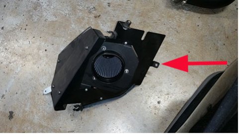

If any of these conditions are found, check for an aftermarket Cold Air Intake (CAI) assembly installed on the vehicle. Certain aftermarket CAI manufacturers use Ground 110 (G110) (Fig. 23) as a bracket mounting point (Fig. 24), which causes a poor ground connection on the vehicle.
attachment.php
Fig. 23
attachment.php
Fig. 24
TIP: G110 should not be used to attach any aftermarket accessories.
Remove the Cold Air Intake (Fig. 25) and reevaluate the performance of the vehicle.
