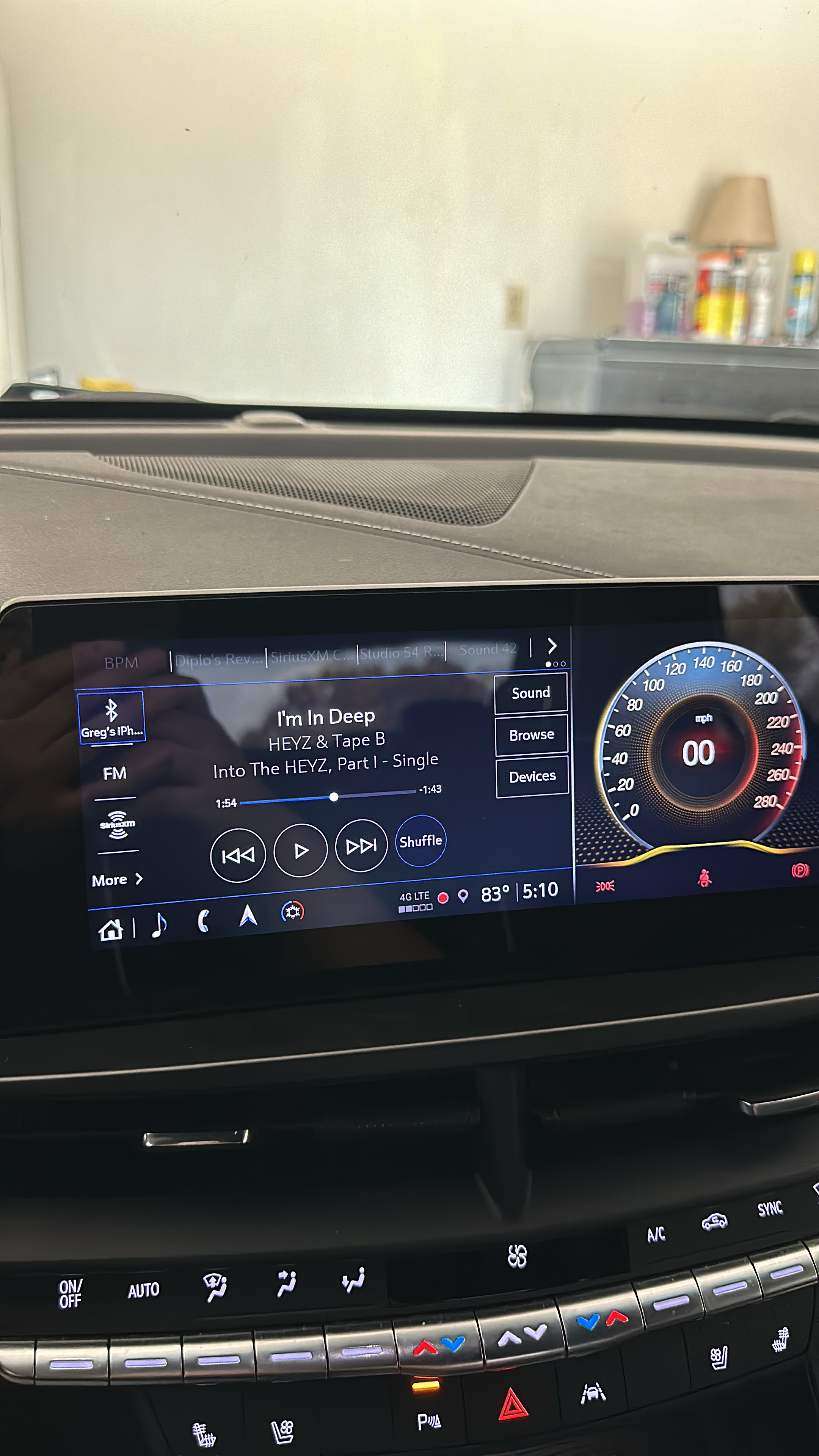

It arrived today (2 day shipping from China). I have fully installed it now and it looks like it came from the factory. Fits very well. No loose gaps or anything. I can't comment on rattles, but I'm taking a 2hr 45 min road trip each way the weekend of the 10th. I'll update my observations below.
They didn't come with any instructions but it was well packaged. Okay here's my observations:
1. The included aux to usb dock doesn't work. Bummer. My goal was to download Apple Music and not even need to use CarPlay at all.
2. It works great connected to the Blackwing/s unlimited hotspot. Google Maps app works.
3. The best combo is: wired CarPlay / Android Auto to Android screen. Bluetooth to the Cadillac. Steering wheel volume, forward/previous tracks work, and shows up in cluster/HUD since it's bluetooth'd directly to the car.
4. When you plug in, it autoloads CarPlay, which is a nice feature.
5. You can go back and forth between stock Cadillac software and the Android software. You lose nothing.
6. The screen looks GREAT. Good resolution and is ginormous. Such a big upgrade over the tiny 8" screen.

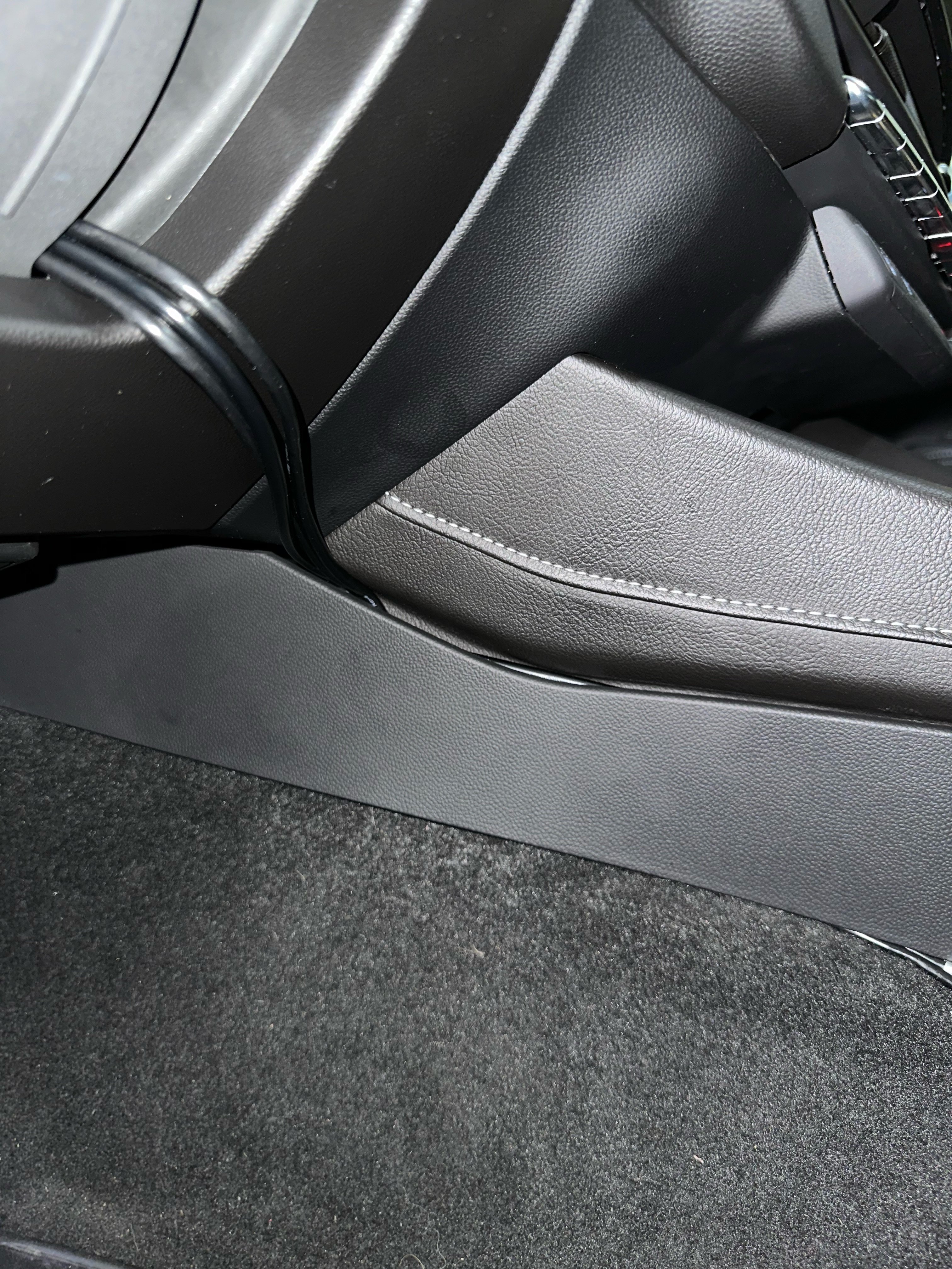

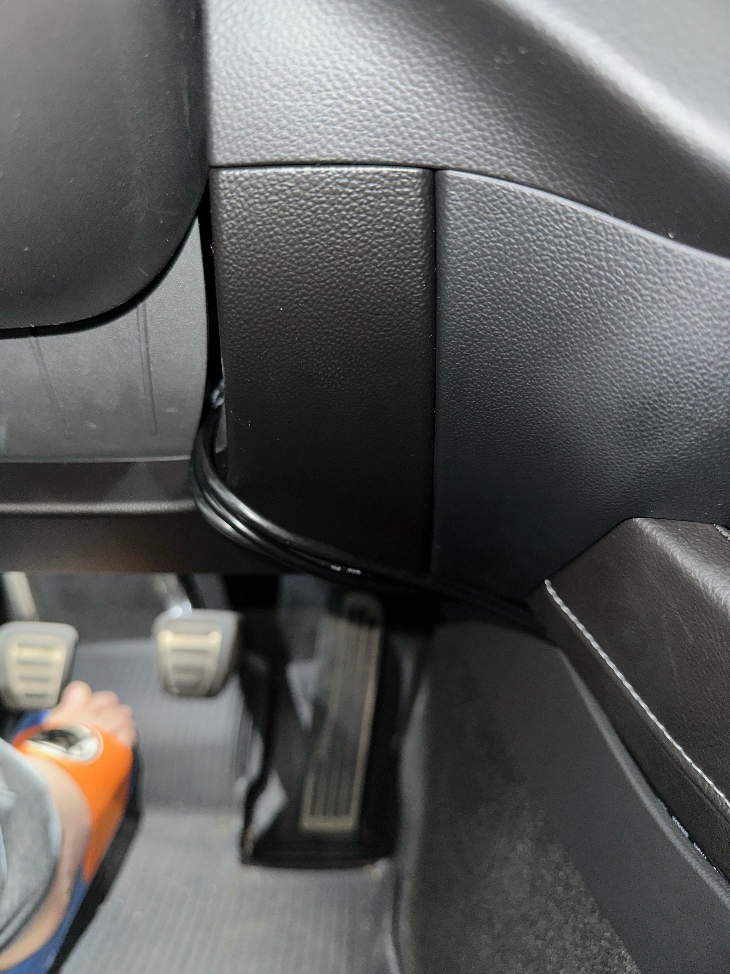

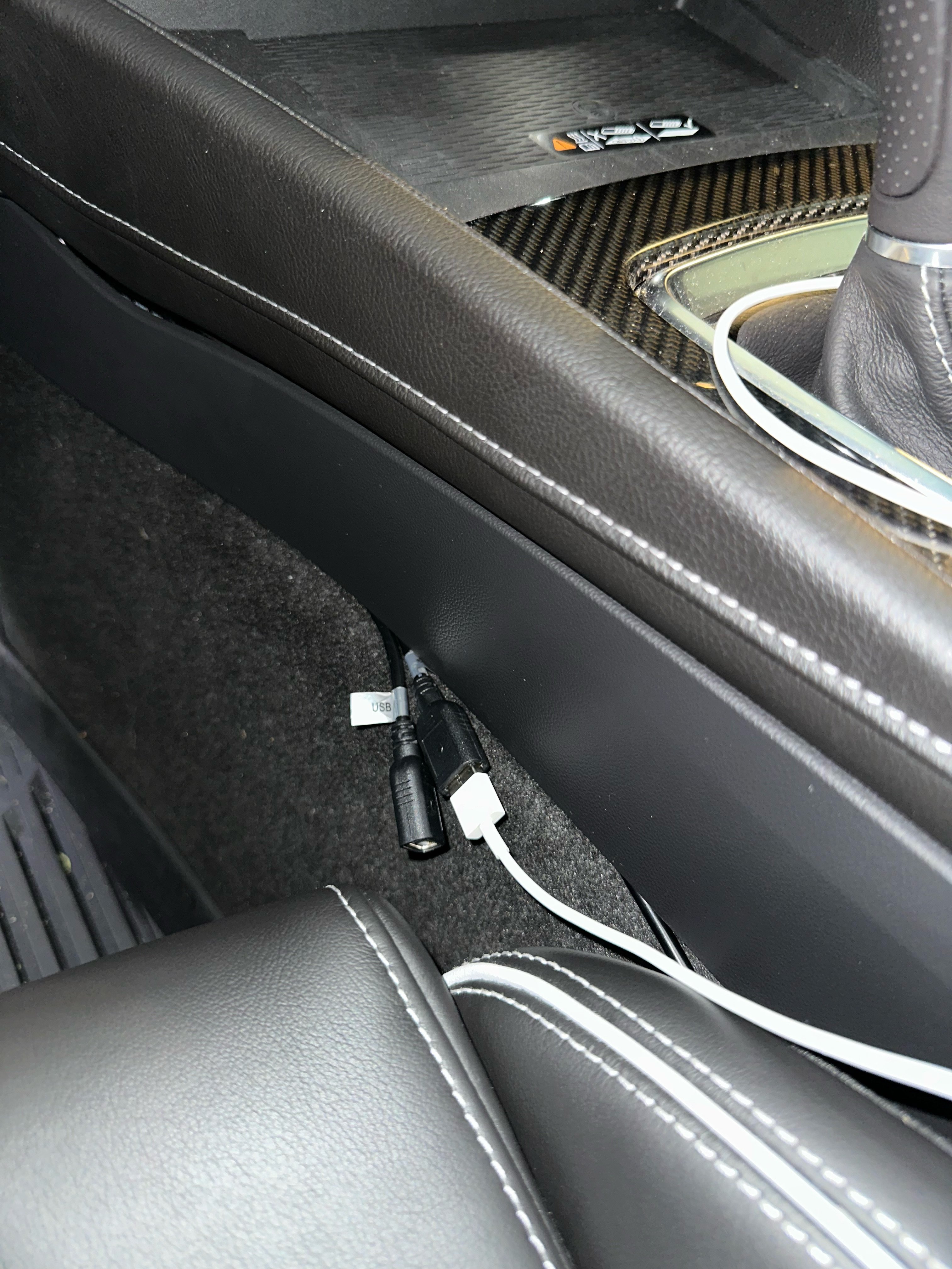

7. I routed the wires behind the start button, underneath the steering wheel, then behind the plastic trim on the center tunnel next to the driver's right leg. It's a semi-professional installation, can barely tell the 2 USB and aux cables are there.
