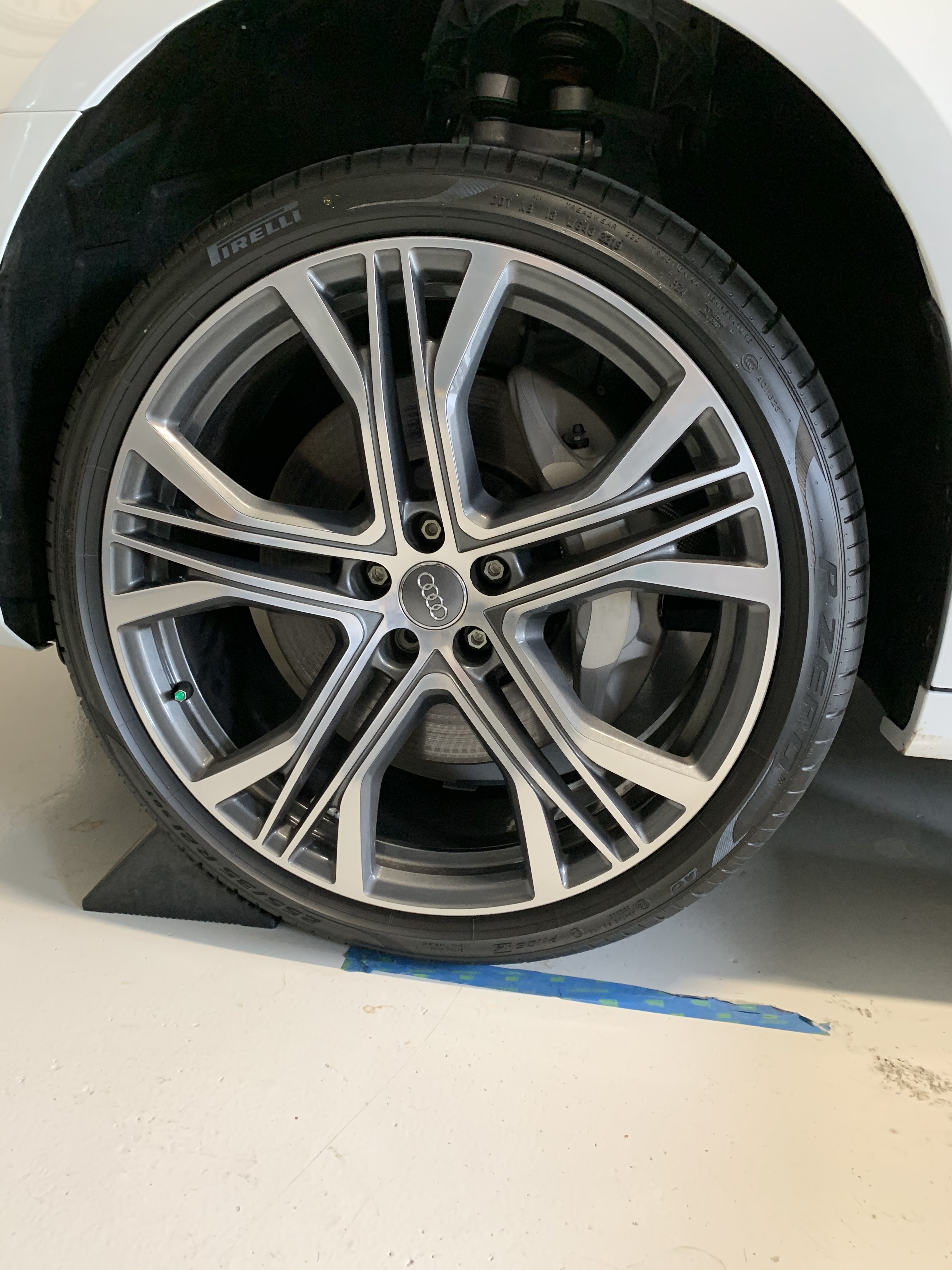

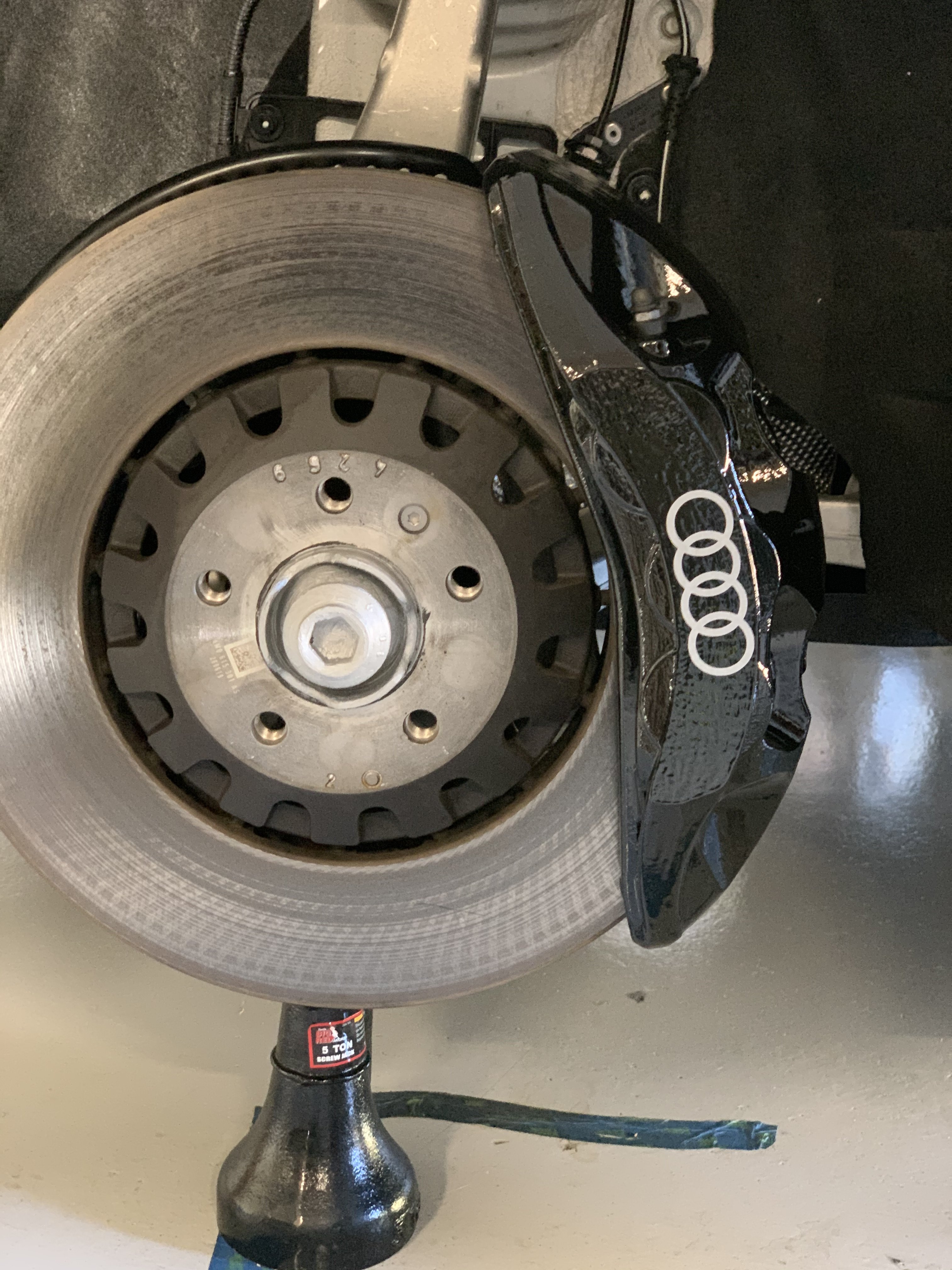

If you have the time and patience, you can paint them with G2 caliper paint (G2usa.com) without removing the caliper. They have over 10 colors to choose from. I’ve had good success by taking my time carefully taping around everything after throughly cleaning and once dry, then paint. I have had zero issues with their paint failing, but I don’t track cars either. My last car I painted was my 2019 Audi A7 and bought high quality decals that I installed. I painted those black as I didn’t want the caliper color to be the focus point. Here are the before & after of one front caliper.
I did my A6 the same way, same ring decal too... Just in red. It held up for 3 years, still looked new. I just think with mine already being bronze, am I devaluing the car since it was an extra option for the color.
I did forget to mention that if you paint with the G2 paint system, do not clear coat over the color. I couldn’t find a clear coat that could handle the higher temps without yellowing. I did place the decals on while slightly tacky thinking that would help.
