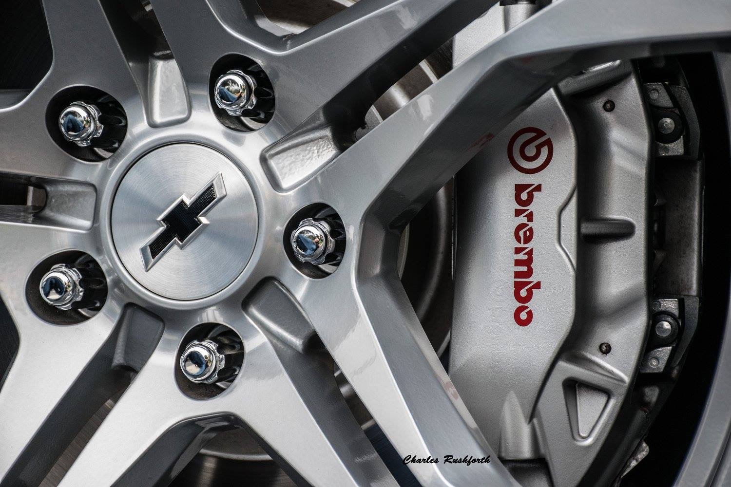

I've always had good results with off the shelf caliper paint. The calipers can be painted on the car. Just tape up everything. Brembo stickers can be found on Amazon and eBay and can be clear coated. I didn't clear coat mine and they never peeled. These are my Camaro SS calipers repainted.

Thanks. Wow those calipers turned out great. I’m looking for a rim repair shop to see if they can paint it. So paint then clear coat? Correct?
I never clear coated my calipers but you can if you want to seal in the decal or make them shinier. I wanted to be able to change out the decal if needed. For some cars where I have painted the calipers black I don't even tape up the pads. They get painted black and disappear behind the wheel. The Brembos are easy to remove the pads and tape up whatever you don't want painted.
