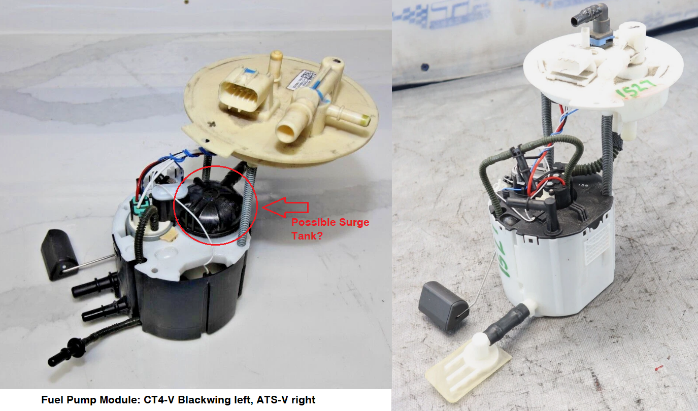

Are you maxed out with fuel system again? I was under the impression with the high pressure pump and bigger cam lobe we would have enough fuel system to go full e85 on the stock turbo's.
Yes. I am maxxed out. I can run 85 but only in short bursts. I am trying to stick around 75
Interesting. Makes me think the high pressure pump volume isn't the biggest restriction?
The problem is E85. The stock system flows very well for running 85 but it does have its limitations. If this was an old CTS-V you would have had to do a full fuel system upgrade. I have a truck pushing over 700 wheel hp on a third gen LS. I had to run twin 340 fuel pumps and 1200 fuel injectors. I knew going in 600 wheel would be the limits based on the mods. I’m not disappointed at all.
Is it the low pressure or high pressure part of the fueling system that's holding you back? I assume low pressure, because the low pressure feed lines are being sucked dry by the high pressure system, and once that happens the high pressure system can't regulate anymore.
