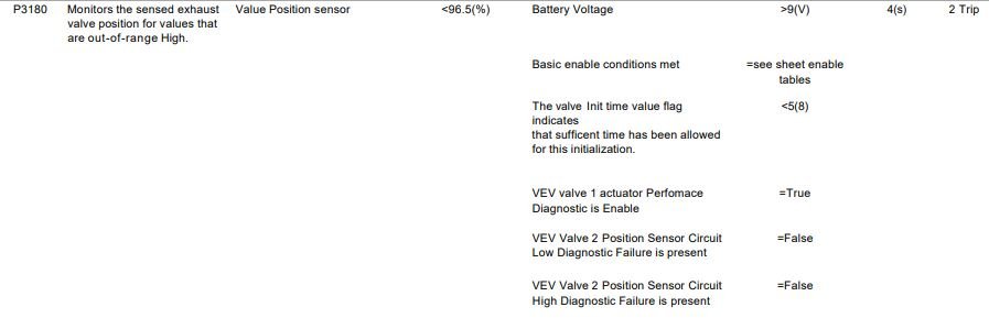

So I went to HarborFreight and purchased a Zurich ZR15s OBD2 scanner. I got a code p3180. I need to better understand this OBD2 scanner to see how to do valve relearning, if it can even do that.
I don't know if that scanner is bidirectional, if not, return it and buy one which is, like the one I linked above. Then relearn those valves and call it a day.
Okay, I am done screwing around. Just ordered the Launch scanner you recommended. Gonna return that HF POS.

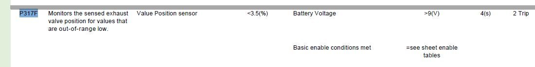

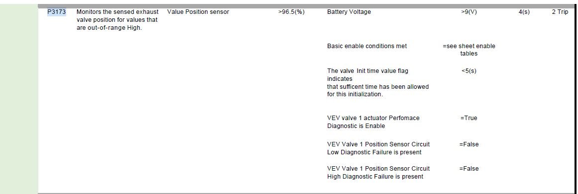

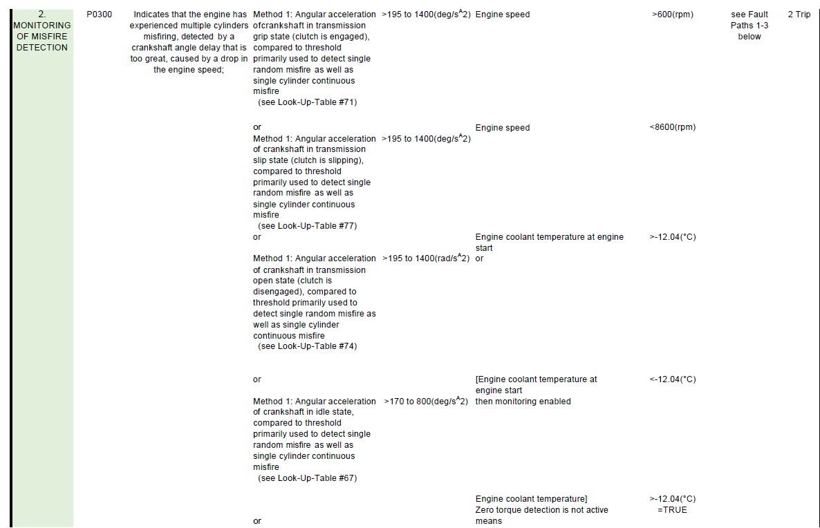

Ok, you got a few things going on here.
P0300 - is a multi-cylinder misfire detection. There's 10+ pages of diagnostic scenarios to work this out. Was this code present when you brought to the dealer? Did they attribute this to the exhaust? This is the first of 10+ pages. Nothing I can do with this one nor do I think this is related to the exhaust unless something up stream was modified or a rare case of something plugged downstream in one of the pipes (doubtful but never know)
P3173 / P317F - are valve position codes, which more then likely can be resolved by performing a relearn. This is assuming the springs were clocked correctly in the actuators. Corsa does give a picture diagram to help orientate these when reinstalling. But what you can do, before removing the actuators, is remove the inside tips, and then shine a flash light down the inside pipe. Have someone flip your drive mode (you can do this with the car off, just hold the start button for a few seconds and will put you into a service mode) between Tour and V mode and see if the valve is closing with Tour and open in V mode. If they are not opening and closing correctly it may indicate the spring is not clocked correctly. Its a little tricky to set the spring in the cutout and then attach the actuator without it slipping out of the grooves. This could continue to cause a code even if the relearn has be executed as the computer is not getting the correct resistance voltage return and thus sees an error. If you do have a bi-directional OBD scanner, see the beginning of this thread, I mentioned it several times. You should be able to see the valve open/close values in %, possibly voltage, and should be able to perform the relearn process. Takes seconds to perform. Additionally, while under there, unplug the valve actuator extension cables and insure none of the pins are bent or misaligned, check the cable overall.
