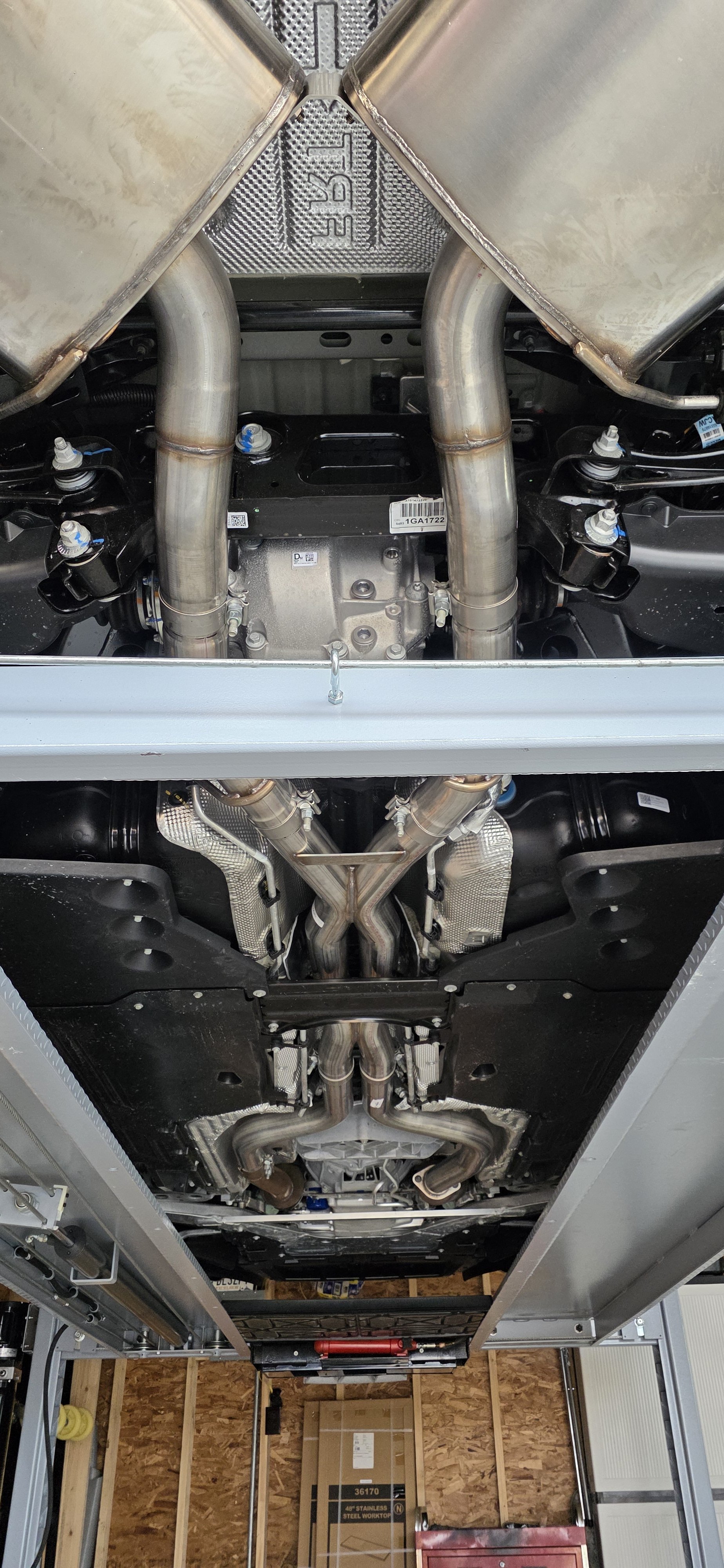

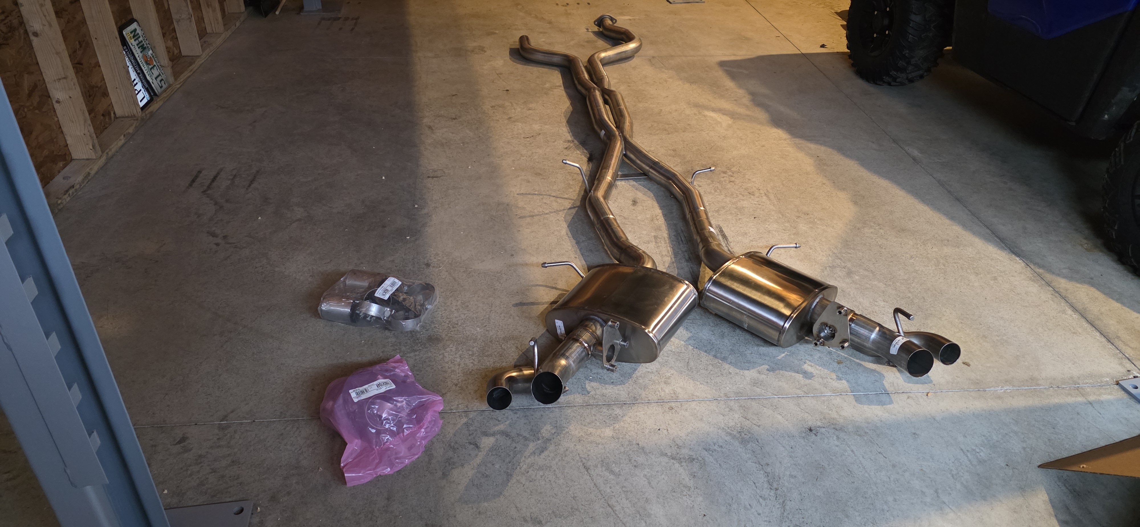

First things, lay out the exhaust the way it will be finally assembled. There are a lot of parts since you cannot ship a 12' long exhaust through UPS, so make sure you get everything organized. Having a lift is MUCH better of course, but if you are working off the floor, have a good set of jack stands and wheel-chocks to keep everything safe.

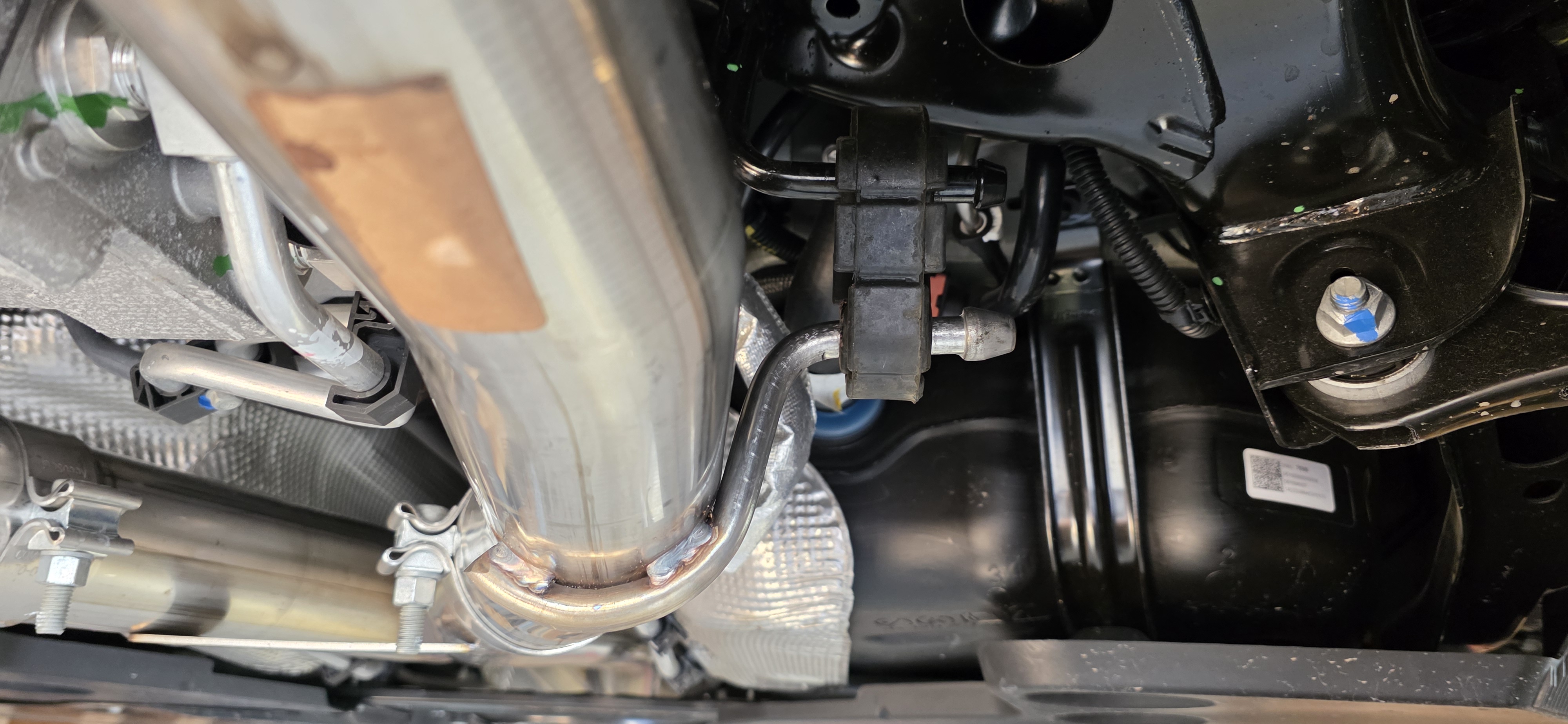

This photo is after it was completed and the center brace was installed, but you can see how things fit nicely and line up well. Use stands to hold up the middle while you bolt the front pipes on and try to keep things centered.
VERY IMPORTANT: Leave all clamps just snug until the very end. Tighten enough that you can just barely rotate or slide the pipes and make adjustments. Line up with your Sharpie marks to get started and it should stay fairly close to the correct position.

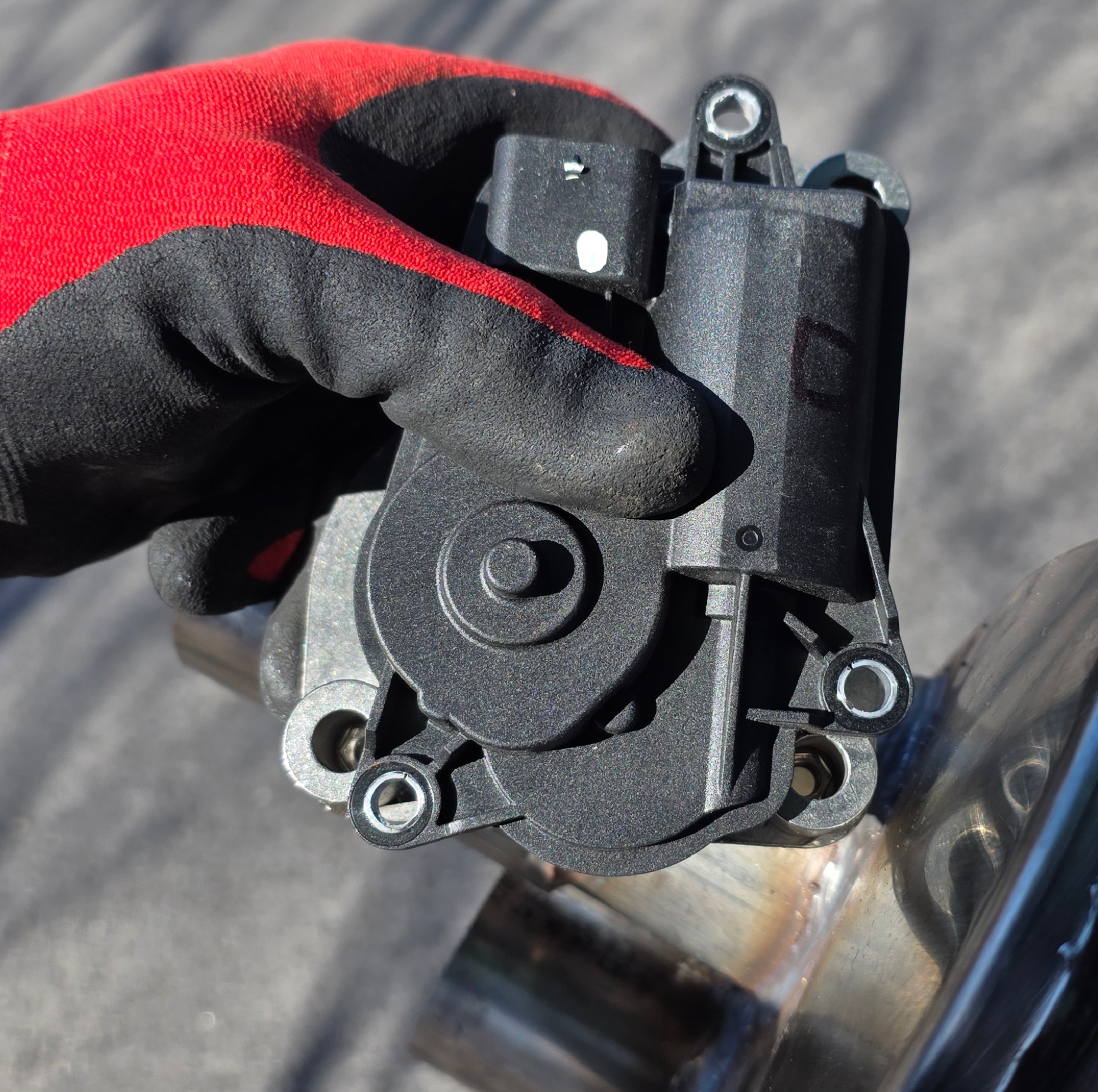

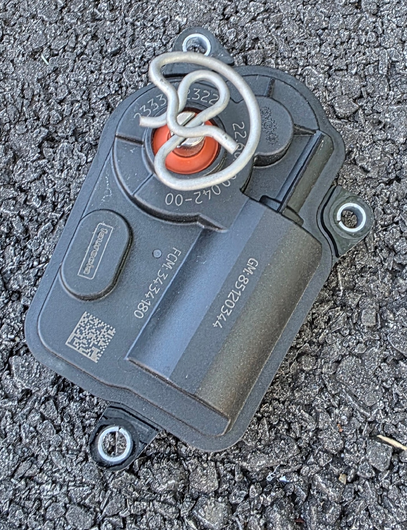

One of the next steps is removing the valve actuators from the old exhaust. When doing so, get out your trusty Sharpie and label them "D" for driver's side and "P" for passenger. They have to go back on the same way. When you pull them off, there is a weird little spring, just keep it oriented the same way as it was when it came out. Mine actually stayed stuck to the actuator and made it easy.
When you install it, make sure the valve on the Corsa exhaust is also in the 100% open position.

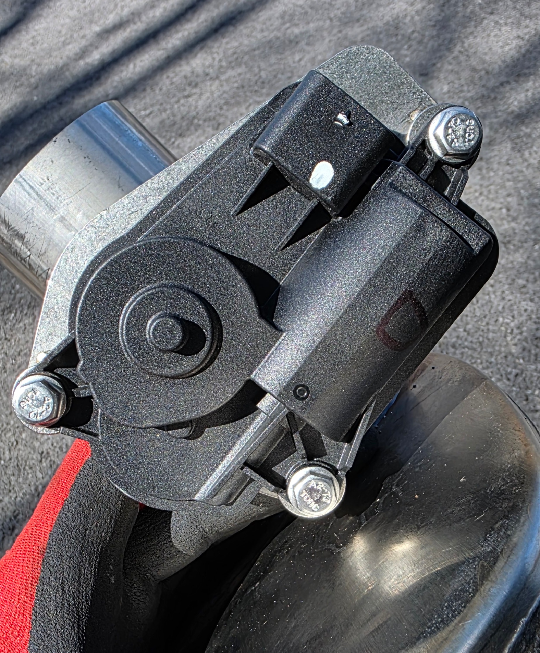

When you are inserting the actuator and spring into the new valve, you will see what when it is lined up, the holes in the actuator and the stainless bracket do not line up correctly, which was a tad confusing at first (photo):
THIS IS CORRECT! The spring actually has a little tension when it is installed, so you have to hold it down in place (against the stainless bracket) and rotate the actuator until the holes line up. Carefully install one bolt at a time until all three are started, then tighten to proper torque spec (89 inch lbs I think?)

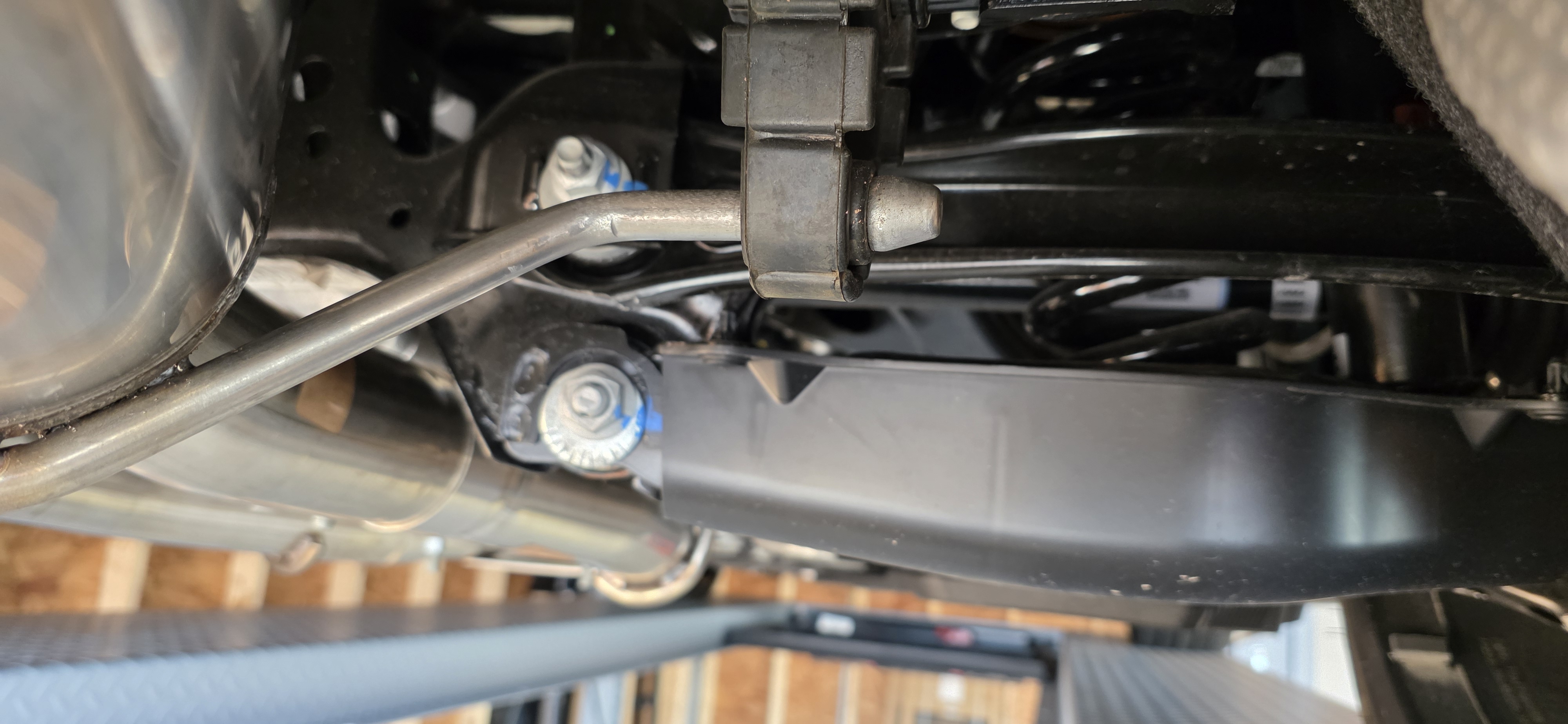

When it comes to putting all of these random pipes and clamps together, there is a LOT of room for adjustment and twisting/turning of them. The main thing to takeaway from the instructions, is that when you snug things up, have the part of the exhaust hangers that go through the rubber holders be horizontal. Also, the small, flat brace that says "Corsa" has to also be horizontal (level). See photos:
After this, you will find that the support stand is priceless for pushing up on the connection between the two mufflers and adjusting up as high as you can without having the actuators hit anything and keeping proper clearances.
Once everything is "roughed in", then go to the front and start tightening everything to 45 ft. lbs (61 Nm). Check your Sharpie marks and orient the bolts on the clamps up out of the way of any lines, heatshields, etc. The instructions tell you exactly which direction all clamps should face. My only gripe is the clamps on the exhaust tips are kind of big and clunky, but you don't really see them when it's on the ground.

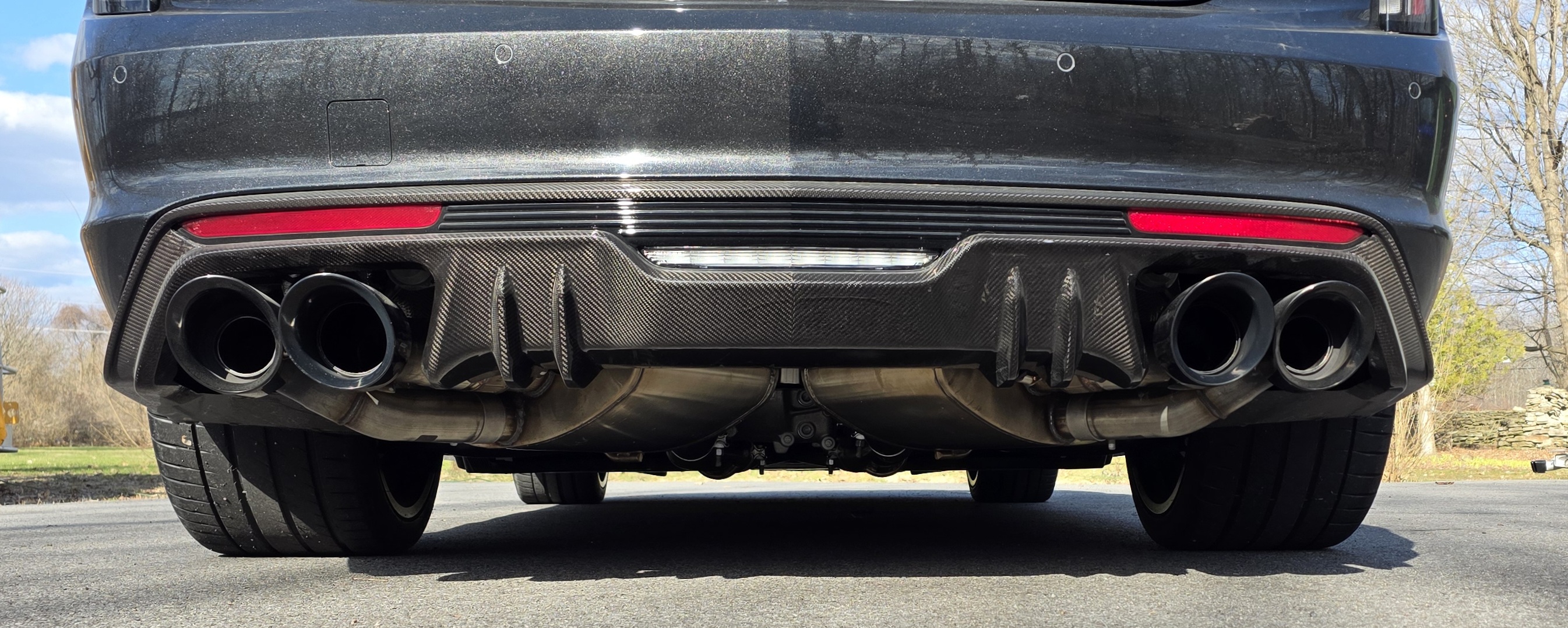

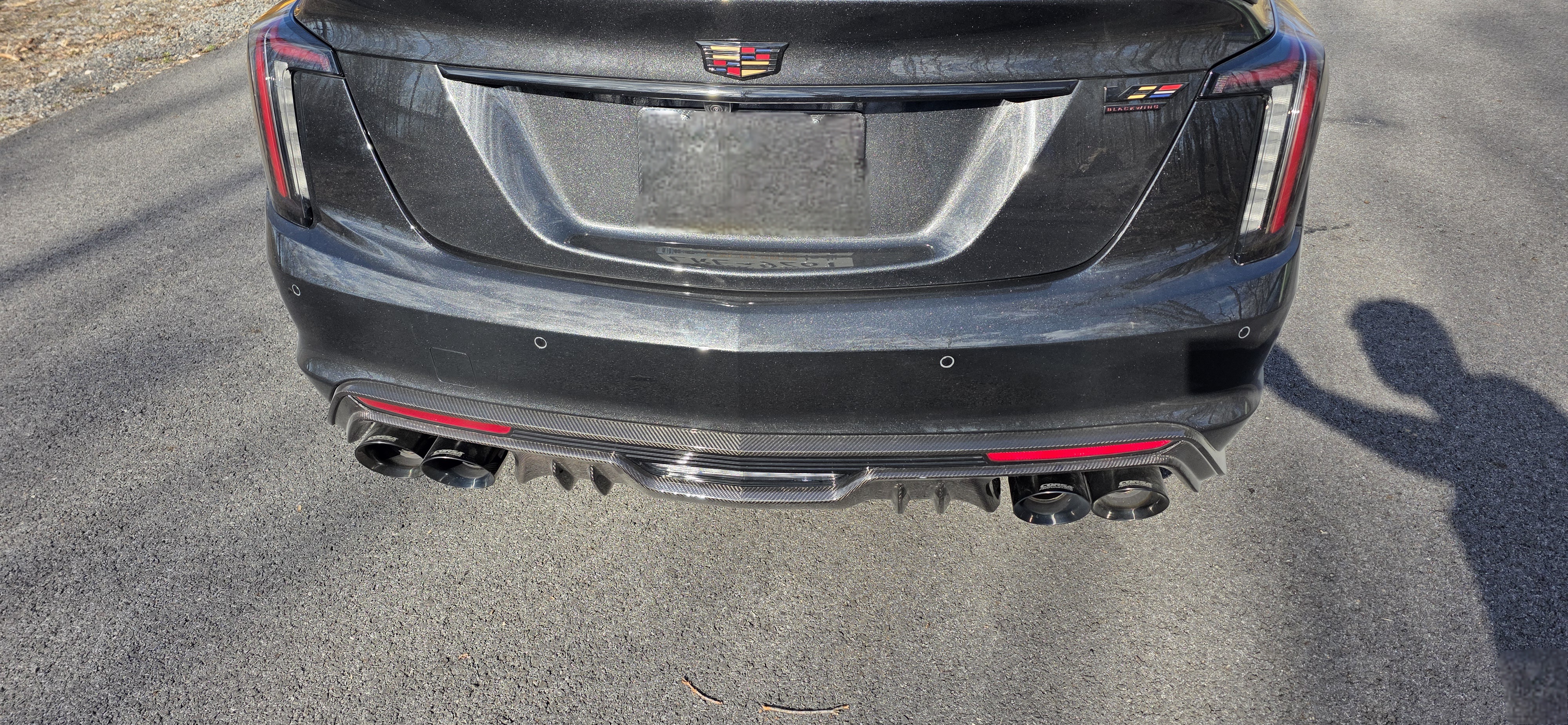

Now, go ENJOY IT! Overall I measured about 1.25" less clearance in the back from the stock muffler, but it's nothing you will ever be concerned with. My mufflers tucked up in quite nicely and then standing back you don't really see them. See photos below showing from different heights/angles:

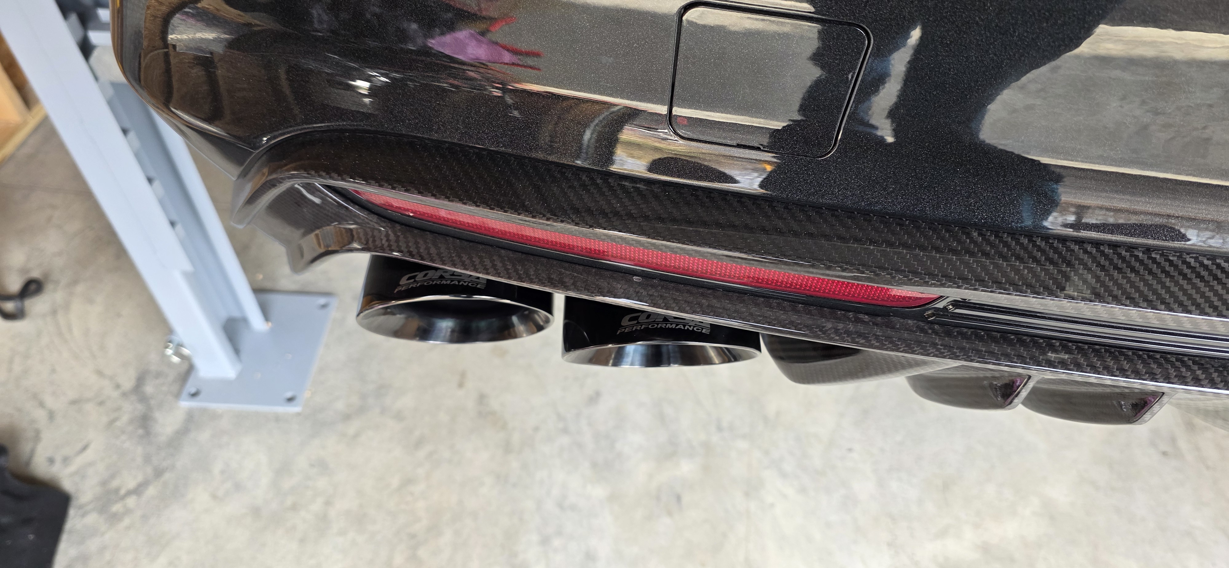

Tips look great:

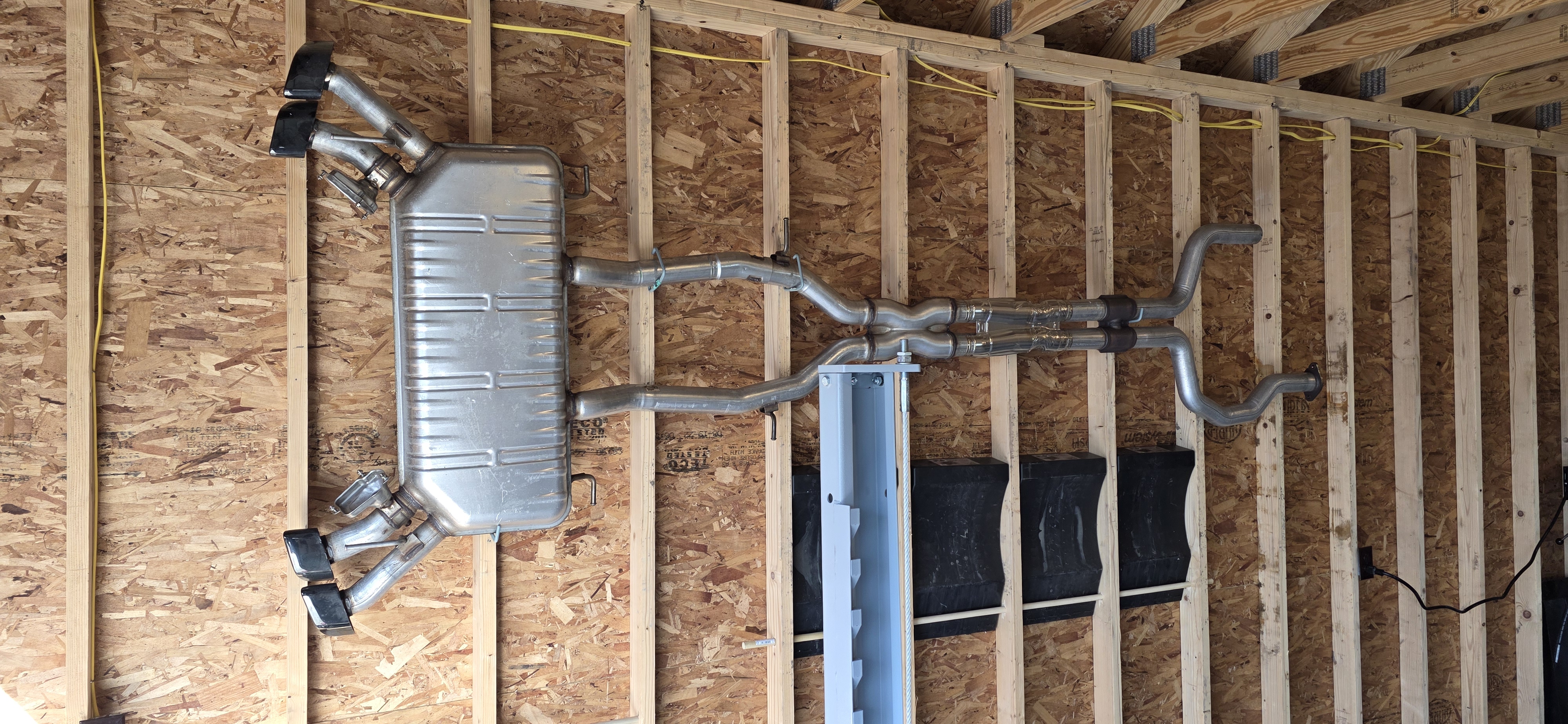

Also, if you have random wall-space to fill up, the stock exhaust makes for some fun "artwork":

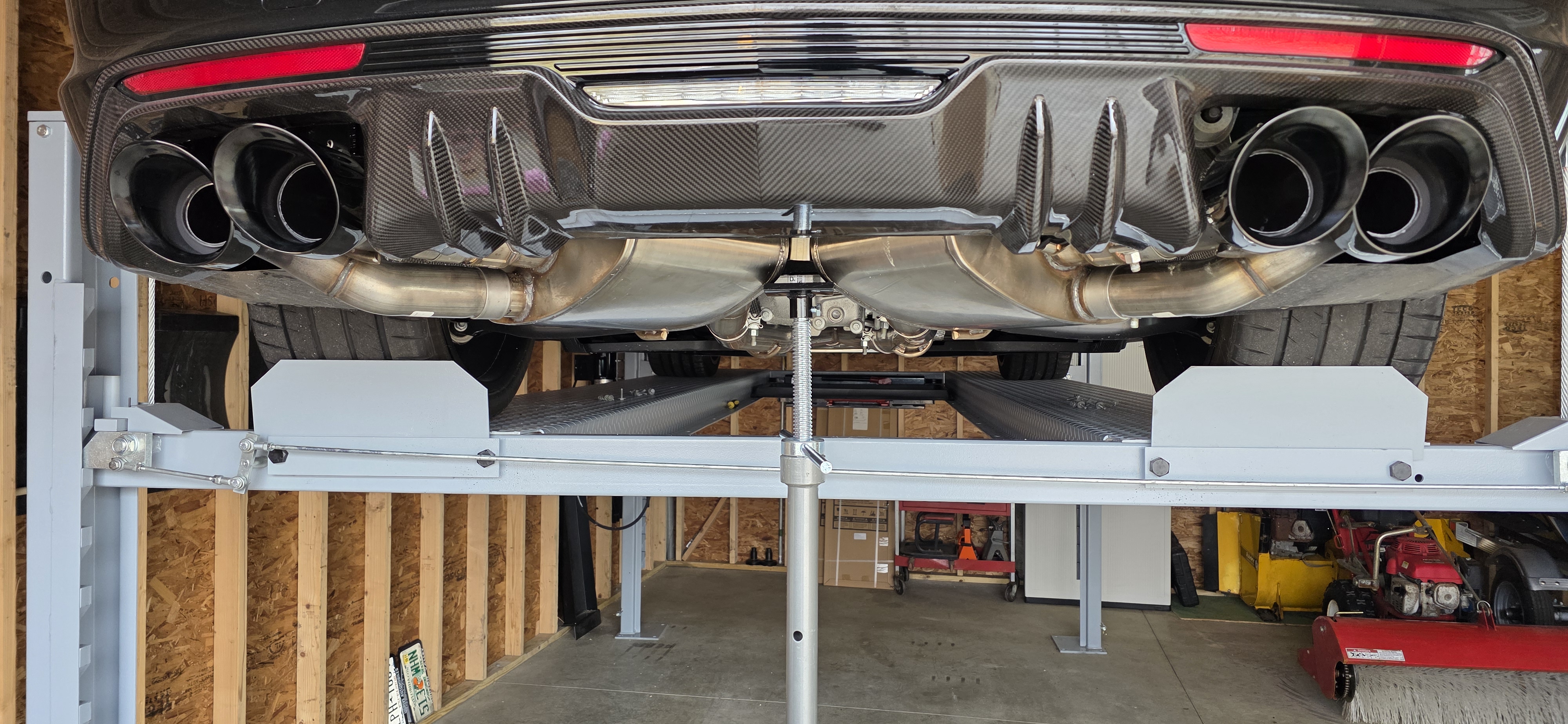

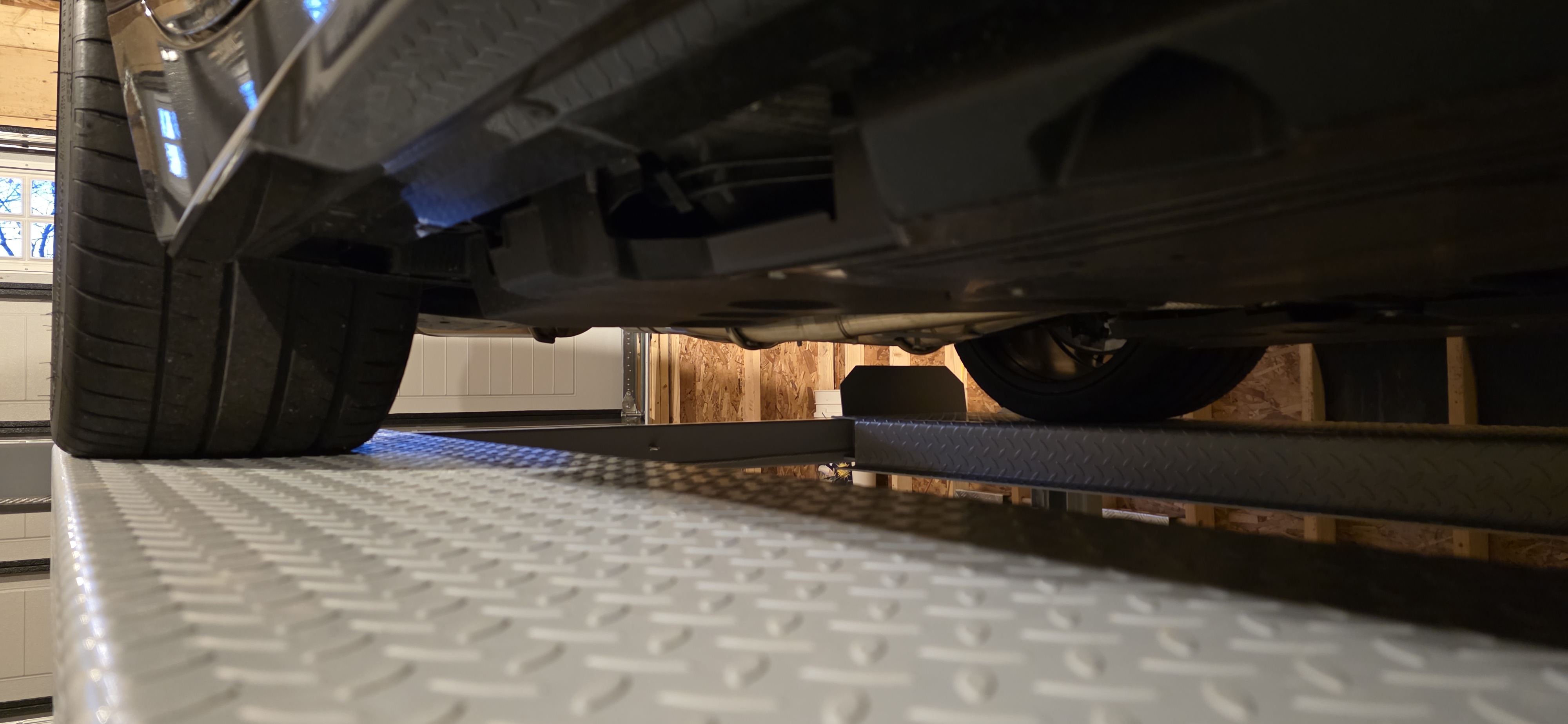

Is the BW that wide? Or is it the lift? When I've parked my 5 on my 4 post there is room to move still. Yours looks like its about to fall off the side.
Nice tips.
Depends on the lift you have; mine is on the smaller side because I don't care if I ever lift my F350 up. I preferred the extra space in the garage. It goes right to the edge though.
